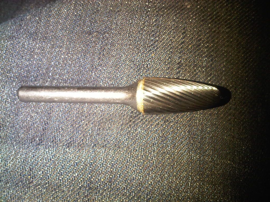

    This is the one ive got
    According to the roebuck site its an oval, but the people in the tool shop said its a tree.
    Can you clarify?

    Have you ever seen a tree that shape? !
    That's not the proper oval but its ok..
    I'll dig out the part numbers I have.
