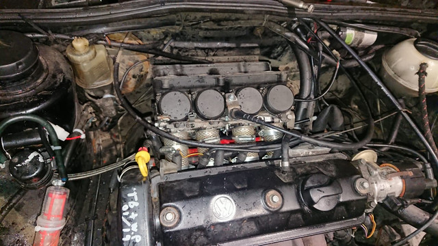

    Over the last few years I've been helping a good mate tune his 1.3 ce2 mk2.
    Running 16v GTI brakes all round and rear axle too, and some decent dampers with a sensible drop. Front GTI ARB too.
    Then over winter I fitted some bike carbs as a treat for him, and gave him more grunt for our Easter Ring trip.
    Now he's bought himself a Cat Cams lumpy stick, we want to derestrict the exhaust side, but on a very tight budget.
    Polo GT / G40 exhausts are not to be found here, so far we haven't even found a mk3 Golf 1.4 item!
    Any other suggestions?
    A quick Google found a brand new 1.6 mk3 item on VW Classic, would that work?
    https://www.volkswagen-classic-parts.de/en/abgaskruemmer-80f27b.html
