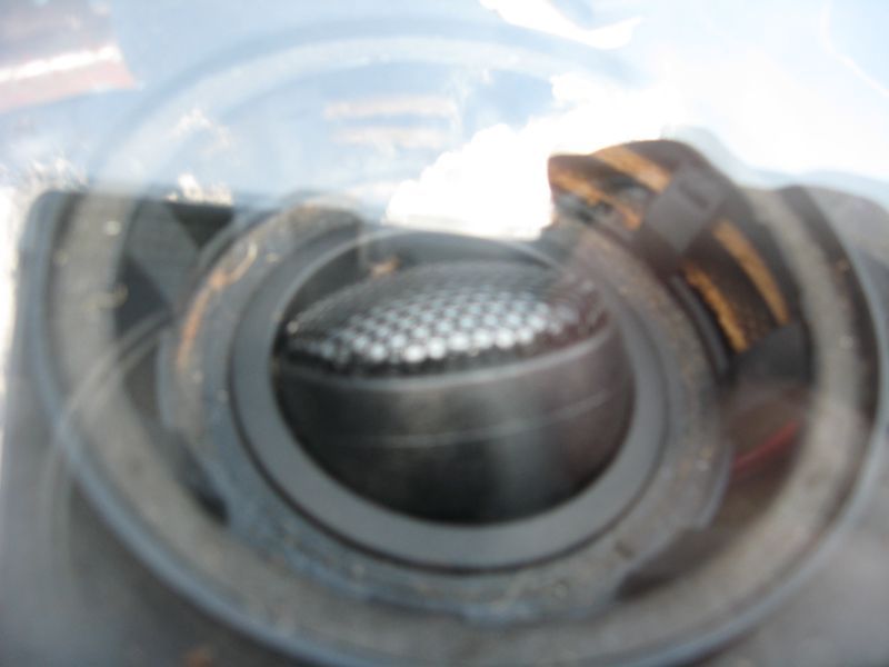

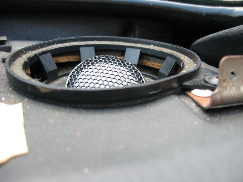

You have the right idea take the door pockets out for the 130mm mounts and fit a component set and see how you find it. I just have the entry level discontinued JBL GTO 505CE in mine (but you could do a lot better) and it is passable until the windows are all down. You can gut the standard speakers and use the frames to mount the tweeters. Excuse the dirt and rust. The dash is cracked around the screen vents and needs replacing anyway. The rears are custom Kenwoods in the standard mounts, really just midrange so I tend to keep the balance forward now.
Thanks for the reply guys. I won't bother with the sound proofing then and fit the sump on the bulkhead/ back of the seats in the boot. That should work and leave enough space for air to circulate. I really like what you have done with those tweeters, its a really neat solution hey! I am going to remive the door pockets and go for some decent speakers in there. I will do some research on speakers, components/mids and see what I can find. Then I will fit a pair in the rear shelf in the original locations under a stealth shelf. Should be ok I think with some really good components. Thanks again
