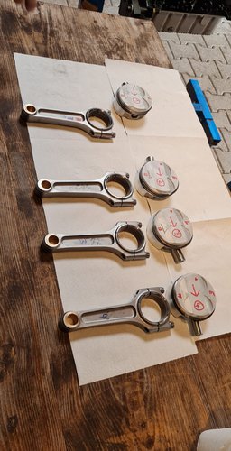

    I have been running an ABF based engine in rallycross for some time now but it has been getting more and more difficult sourcing good heads. Not that I swap heads often but any abf head I find, if any at all, is in poor condition and has had the living sh*t skimmed off of it.
    I have been reading up a lot on the forum about FSI heads and am considering switching to one based on the port design advantages. I can easily source fsi/tfsi heads for cheap but from what I underatand pistons are the problem. The stock pistons even at 11,5:1cr will not work with port injection, correct? Has any one tried running with them with port injection or are custom pistons a must?
  9. voez73 New Member
    May 29, 2019
    10
    Hello, you need special pistons.
  10. Tristan
    1,288
    Interesting small ends!
