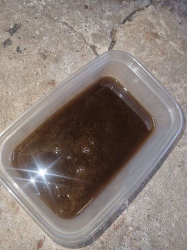

    I changed the gearbox oil but what came out was very dirty brown!! Why? I think I had some clutch slip due to the clutch cable being incorrectly adjusted as I revved the arse out of it to get up the drive for the tuner. The smell was horrendous.

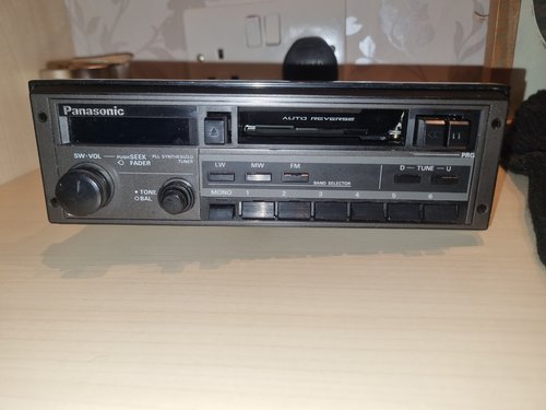

    Hopefully that is sorted now, so turned my attention to the Stereo. I purchased some new iso plugs and have re-pinned the connections correctly. After purchasing a period Panasonic stereo I finally got to try it out. Works a treat

    Your oil looks frothy, would that be making it the colour it is?
    Maybe that's just as a consequence of it draining, now that it's settled what colour is it?
    I know my MK1's gearbox oil was jet black (and low), but then it was 40 years old / had 165K on it.
    Surely you've done no miles on the new oil, even caning the clutch wouldn't have had an effect on the oil I'd have thought?
    Rather than use your new VW oil, maybe try using then flushing through some cheap stuff when the car's able to get out on the road for a run / some miles... might be that some old residual oil has mixed itself in?

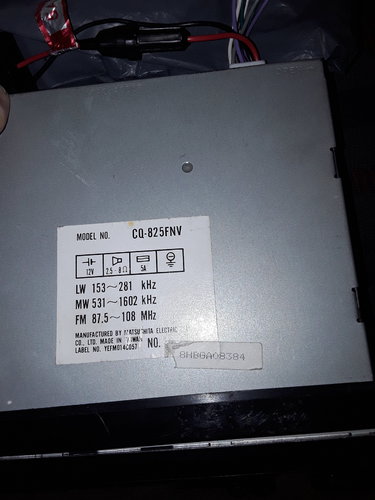

    Stereo looks well, very period to the car. Does it have a model number, might be able to find a manual / more info... there was a great french site that'd archives of quite a few 70's / 80's / 90's car stereos, can't remember it's name at the moment but shouldn't be hard to find again.

    The Oil does have me confused and putting some cheap oil in would have been a great idea, too late now though!.. But it is that brown colour
    You are right that I used the Tee piece with the take off connections for the MFA vac. I shall have to find a way to test round this as the car us still sucking air from somewhere. An instructions manual form the radio would be a great addition
