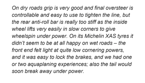

    I don't use Michelin since I had a massive crash, in 1969, due to lies about the XAS tyre's performance in the wet.
    In 1968 the new BMW 2002 was fitted with XAS as standard. All of the road tests, Motor, Autocrat, etc., raved about the tyres.
    Some 25 years later the Motor tester admitted that all 10 cars had, at some point, left the road in the wet!
    Shame that I did not read this Alfa road test.

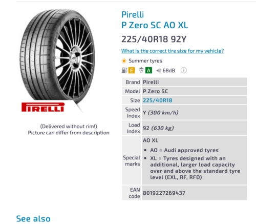

    I have found out why the new P ZEROs have a different EAN!
    They are not the same tyre.
    The ones I bought in 2020 were Super Corsa and these are just basic P ZERO and not even Corsa.
    That also explains why they were so much cheaper.
    Not convinced that they should be A0 rated though. Probably closer to A01 spec.
    We shall see in 10,000 miles is they are less worn than the SCs!
