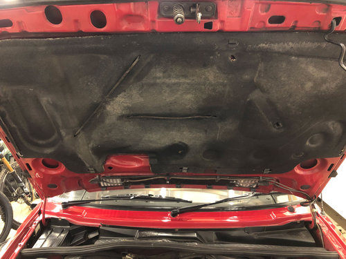

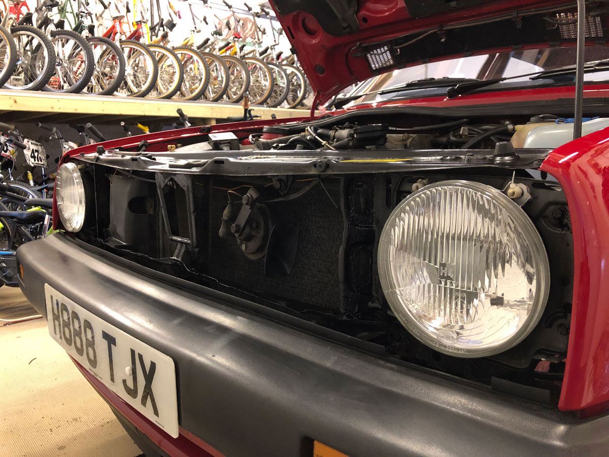

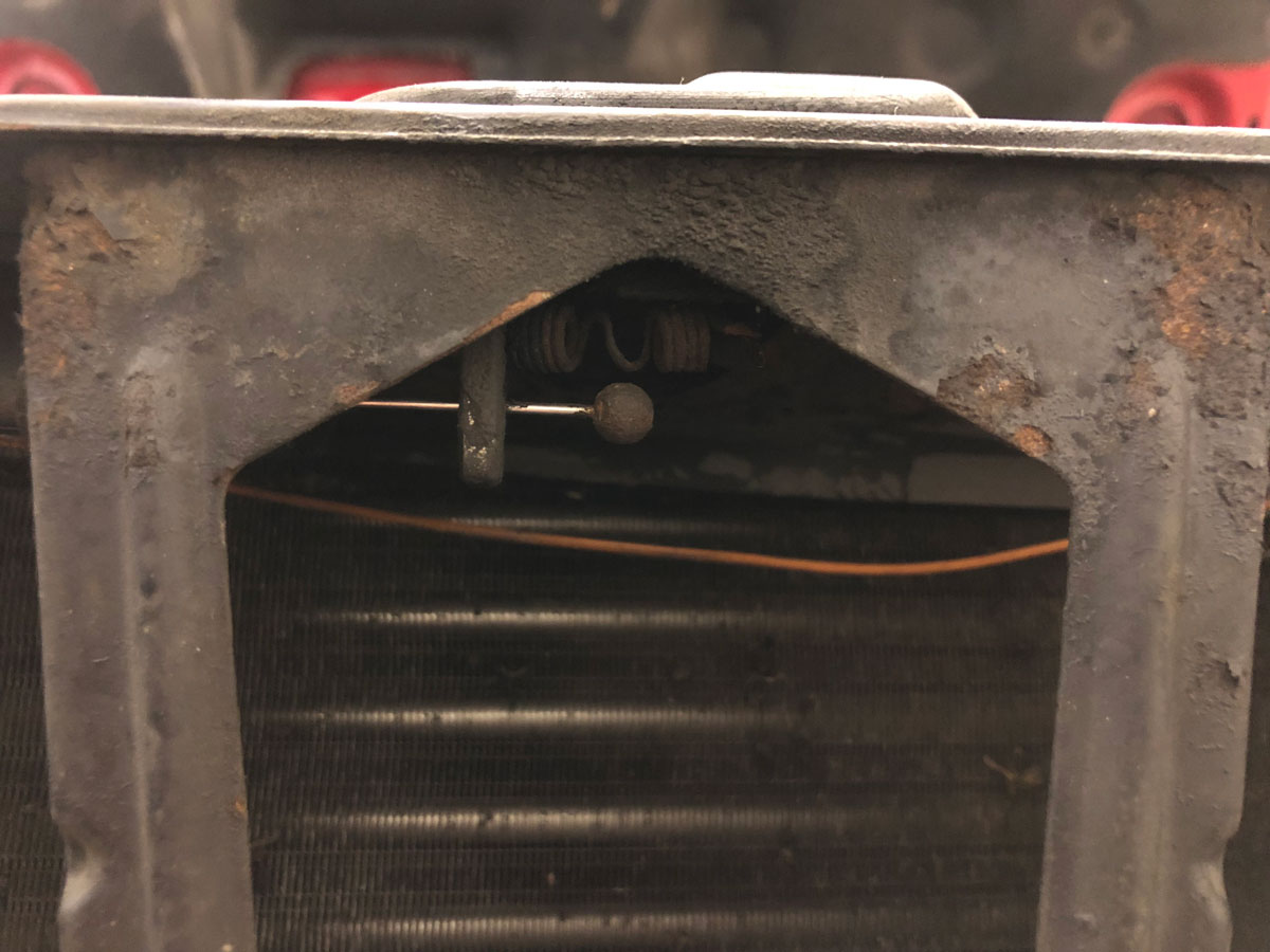

    After getting the car home with the seller's words "Everything works" ringing in my ears, the reality of an 11 owner no history car started to sell in...
    First off after popping the hood to check the fluids it became apparent that the latch wouldn't hold after I close the bonnet. Turns out that the spring had failed behind the grill which means the catch wasn't returning. The bonnet could have flown up at any point during the drive home so I was lucky it was only a 2 mile drive back to mine.
    I rummaged in my spares drawers and found a suitable spring to replace the broken one and the latch sprung back as it should.

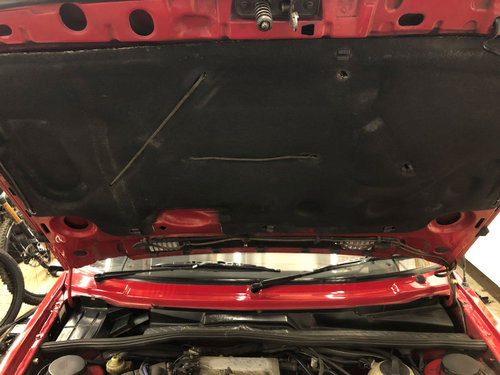

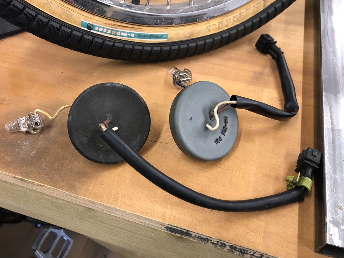

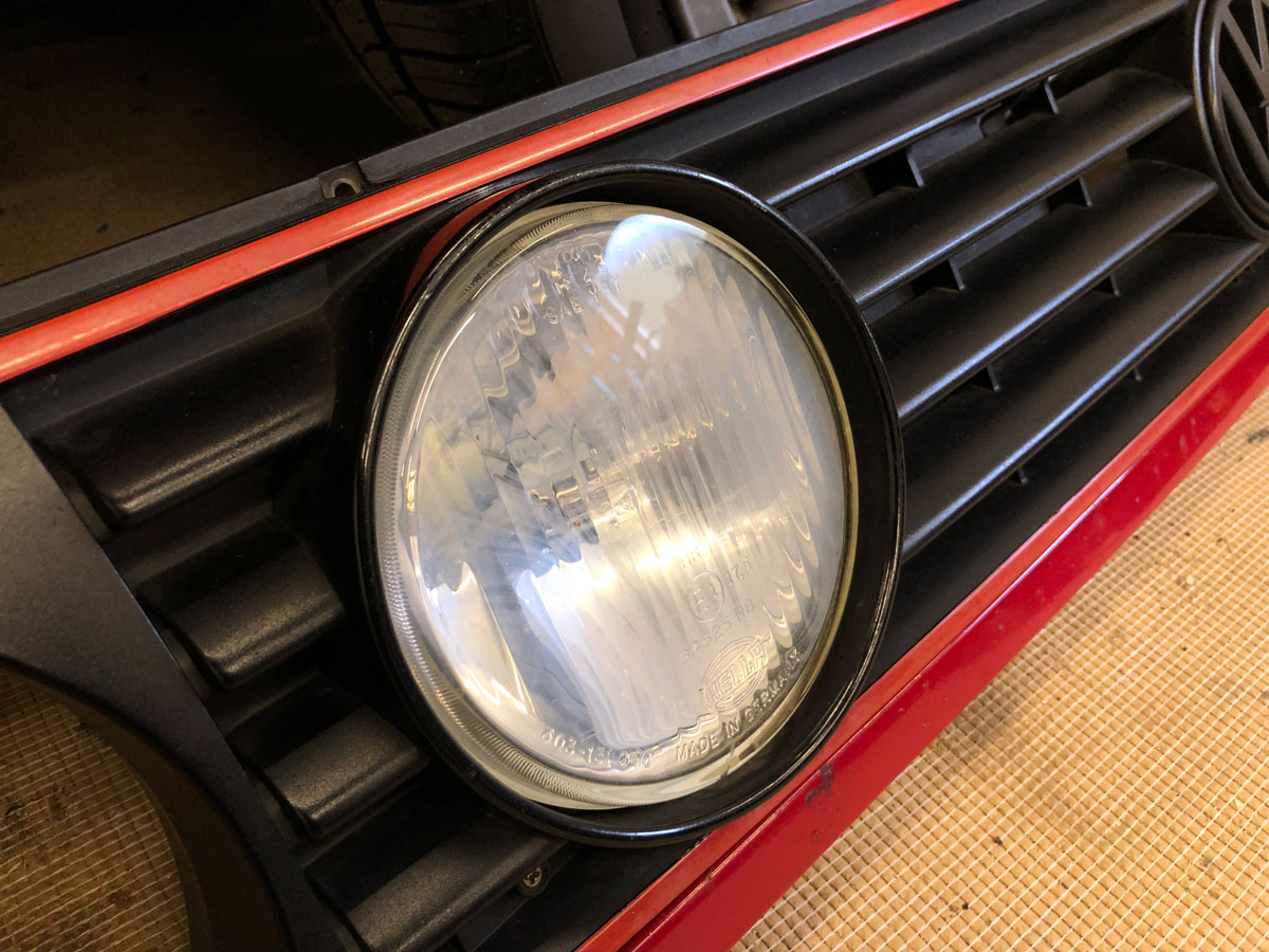

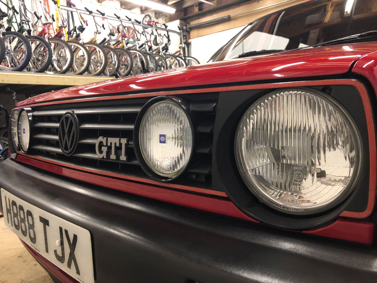

    With the Grill off to fix the bonnet latch, I decided to clean up the foggy spot lights and tidy up the wiring to the lights.
    I also cleaned up behind the grill and gave it a fresh coat of waxoyl.
    Grill back on with clean lights and OE Hella decals fitted.

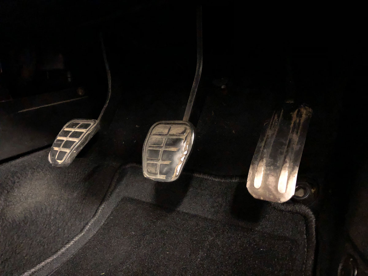

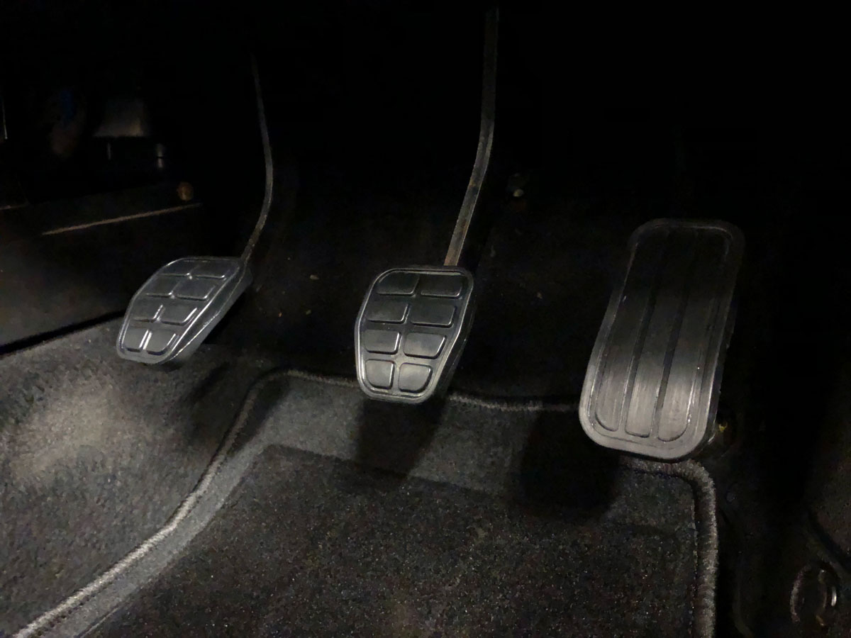

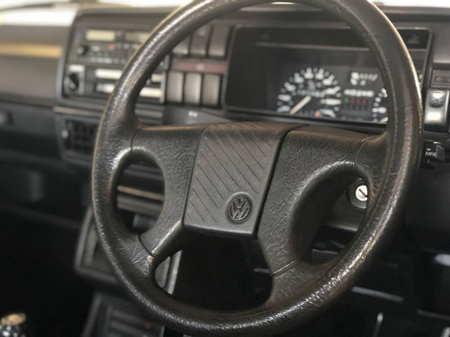

    A few days later the first of the new bits started coming in. First up a few items to tidy up the drivers footwell.
    The existing pedals were showing every mile of the vehicle's life and were desperately needed refreshing...
    Amazing what some fresh pedal covers can do for the inside of a car.

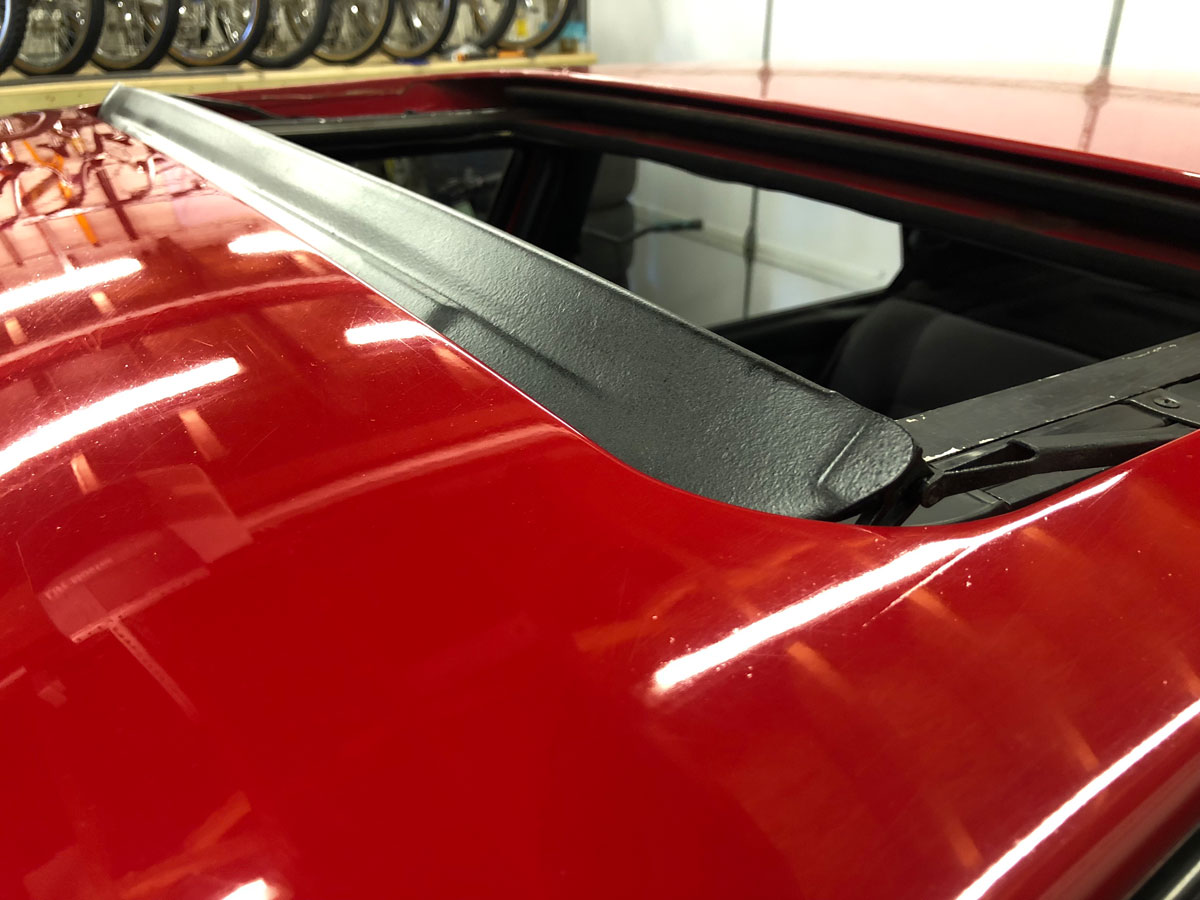

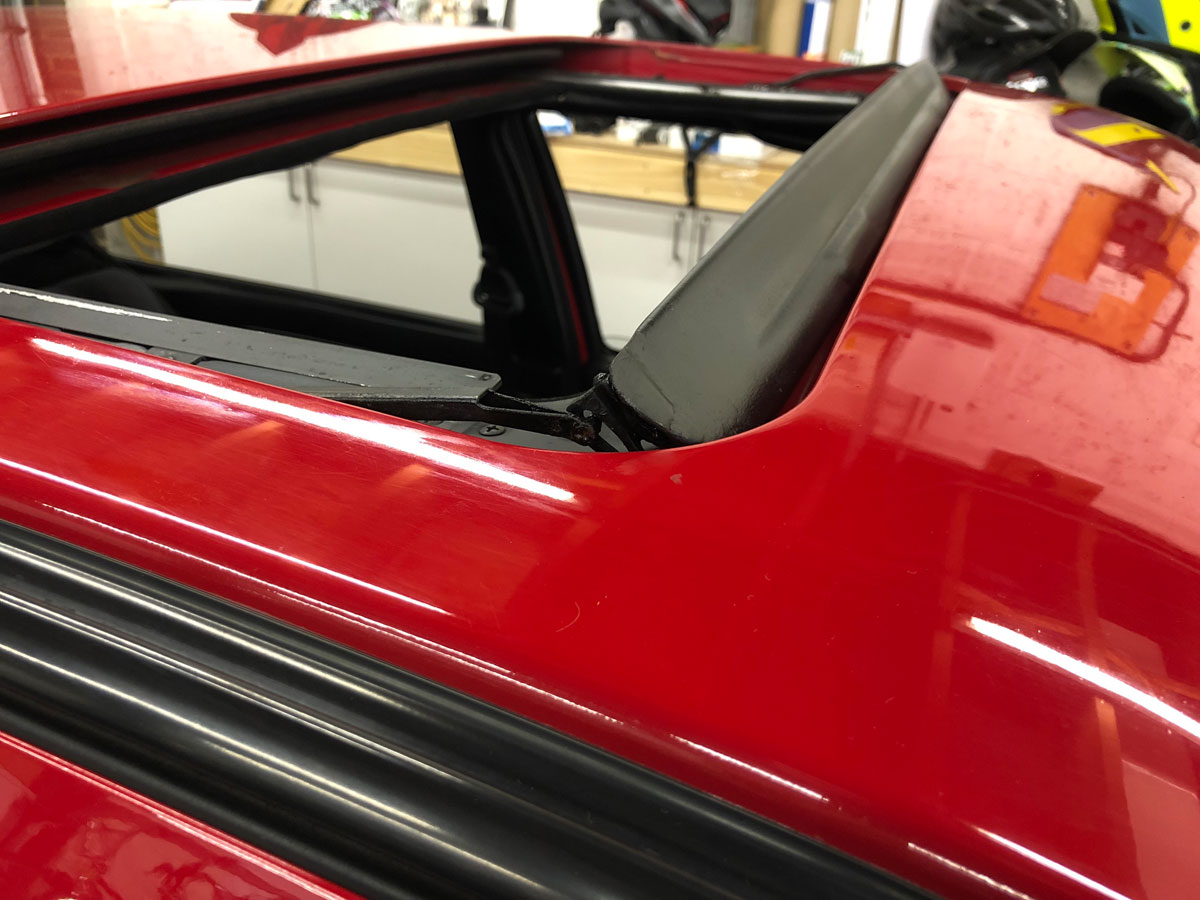

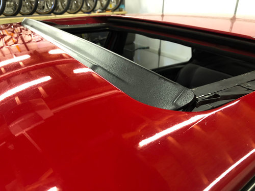

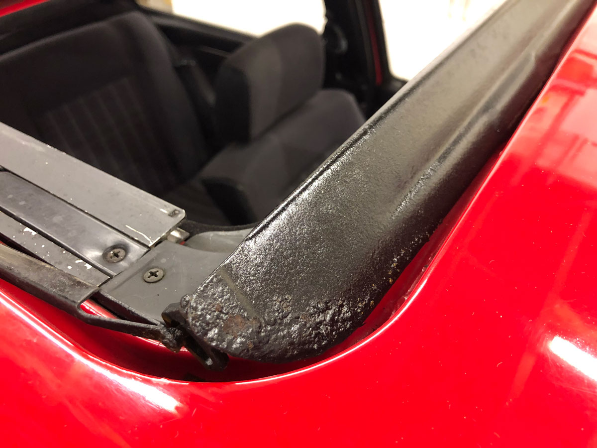

    I then turned my attention to the crusty sun roof deflector. It had the common rust around the edges due to leaking seals and blocked drains.
    Quick blast with a wire wheel and sandpaper cleaned it all off, and then a fresh coat of primer and satin black paint got it looking like new again.

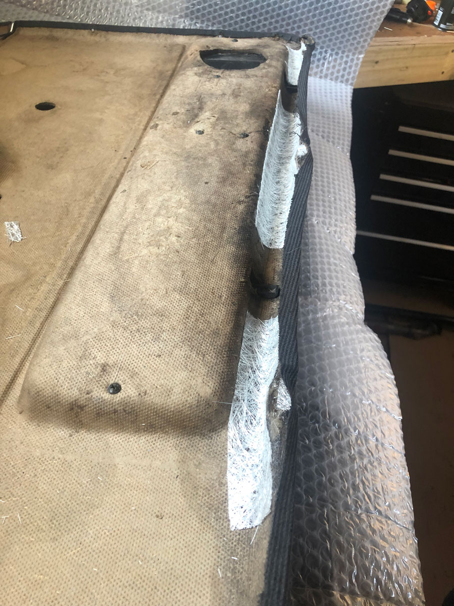

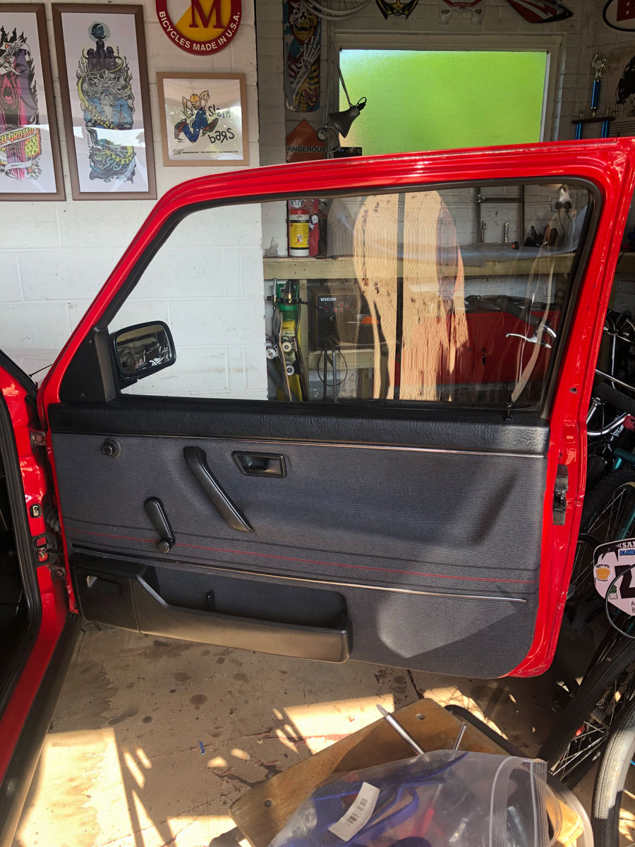

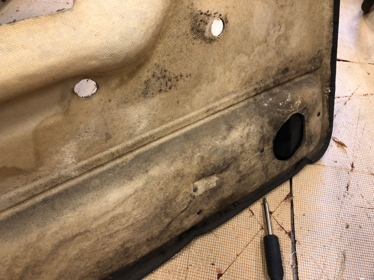

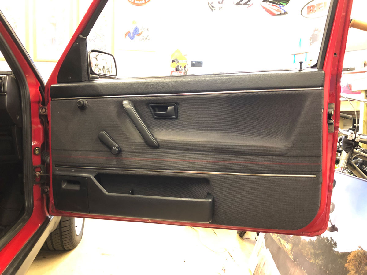

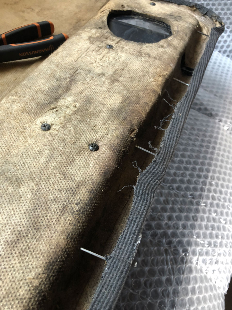

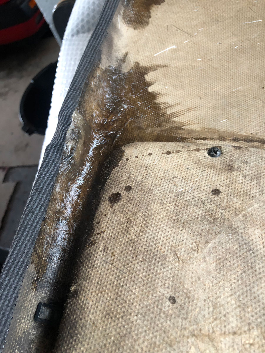

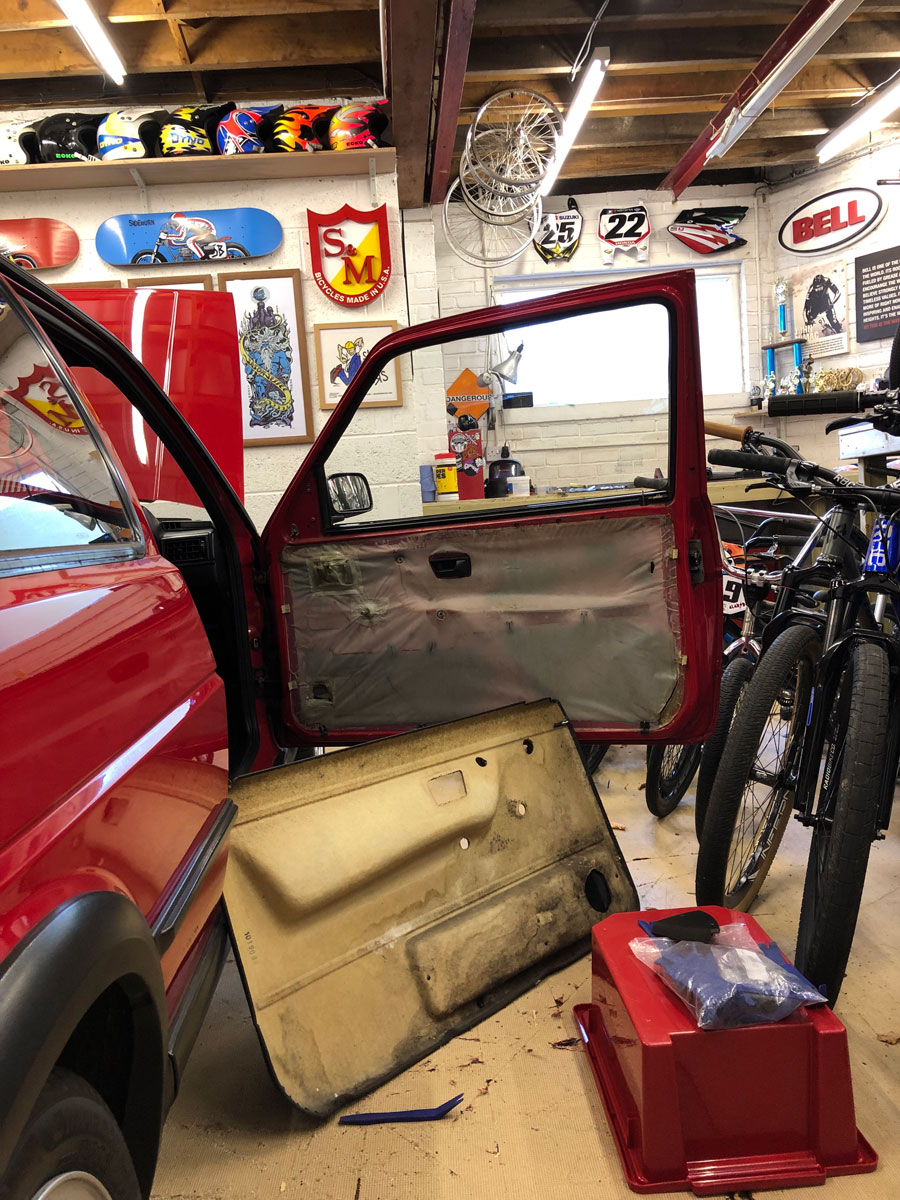

    After that, I turned my attention to the door cards. They were very soft along the bottom from years of water ingress. The shape and fabric had held up well, but because they were soft they didn't clip into the retaining clips along the bottom of the door. This meant that the door cards flapped about every time opened and closed the doors.
    I decided to try and repair them with fiberglass and try and get them back as good as new. I started out by spacing the bottom edge back out to where it would have originally needed to be to clip into the retaining clips firmly.
    I then bought a DIY fiberglass kit from Halfords and layered the material inside the soft bottom edge.
    This technique worked really well, and I ended up coating the whole bottom edge of both cards, as well as the area behind the armrest that often pushes through. The end result was rock solid door cards that now clip into the doors firmly.
    I also purchased a cheap steam cleaner off of Amazon and gave the interior a good clean. I have never steam cleaned anything before and I was really impressed with the results. The below pic you can see the cleaned area on the right hand side of the card vs the dirty side on the left.
    I also used it to clean the under bonnet insulation.
    And after...

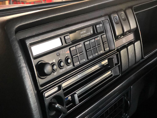

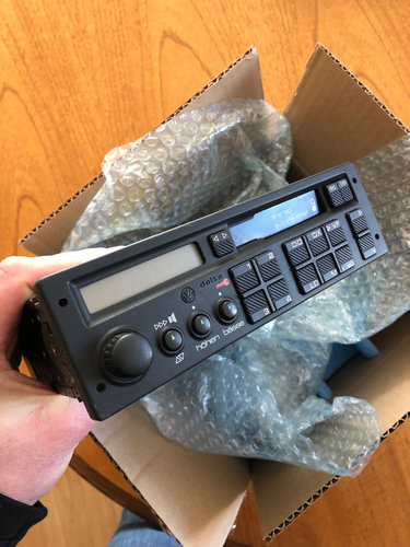

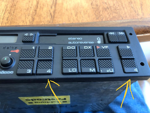

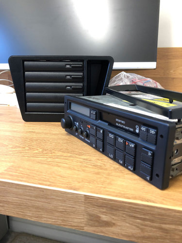

    Given the car is a poverty spec GTI with fish bowl glass and very few options I decided to look into upgrading some of the specifications. After doing some googling I found some catalogues online, and a few things jumped out at me.
    The car had a terrible early 200's radio in it and the OEM radios in the German catalogue jumped out at me. Mostly because I like how the diagonal textures on the buttons matched the diagonal stripes on the GTI steering wheel. Little details like that really make a car, so I decided to try and track a MK2 Delta radio down. (the Recaro interior is a whole nother story that we will get to shortly).
    So a few weeks later this arrived...

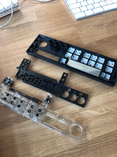

    On closer inspection however, I noticed that some of the buttons had collapsed and didn't pop out like they should.

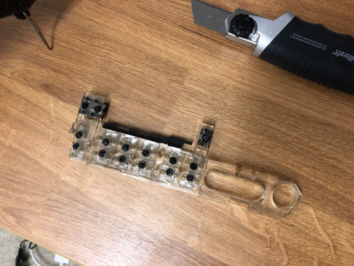

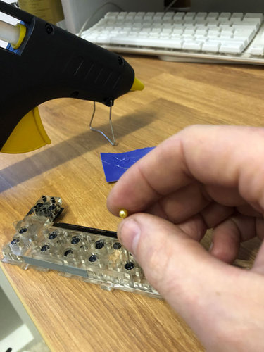

    With no other options and no experience in radio repair, I decided to try strip the radio and see if the issue could be repaired.
    It appears that over time the small rubber "button pushes" inside the clear section had cracked and broken, meaning that there was no longer the bounce back needed to push the buttons out again. After looking at the best way to fix this I decided to try to use black silicone to recreate the old broken rubber bits. I used a pin and black silicone to carefully rebuild each one of them.
    The finished result wasn't as pretty as I hoped but it did the trick.
    I then put it all back together and also managed to track down a cassette holder and original surround to go with it. The surround was tricky to find but I really wanted it as it matches the surround of the climate controls that sit below the radio.
    The wiring inside the dash had been chopped to match the new radio, so I had to source new radio plugs, and then get an auto electrician to create an original loom for the radio, but the end result was perfect, and the radio now has buttons that match the steering wheel horn push. Probably the most ridiculous reason to chase down an OEM radio but that's what I get my kicks from haha.

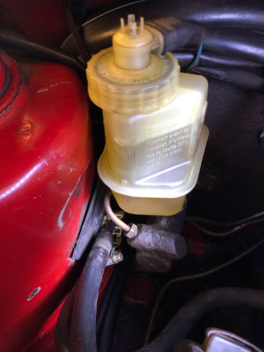

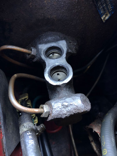

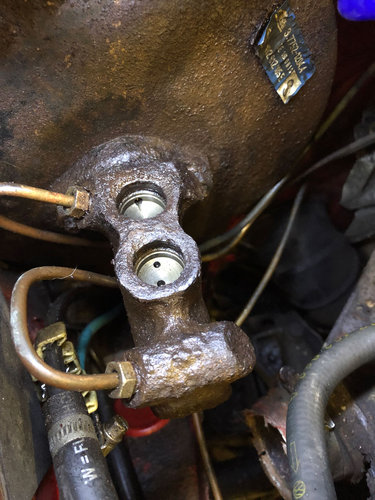

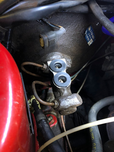

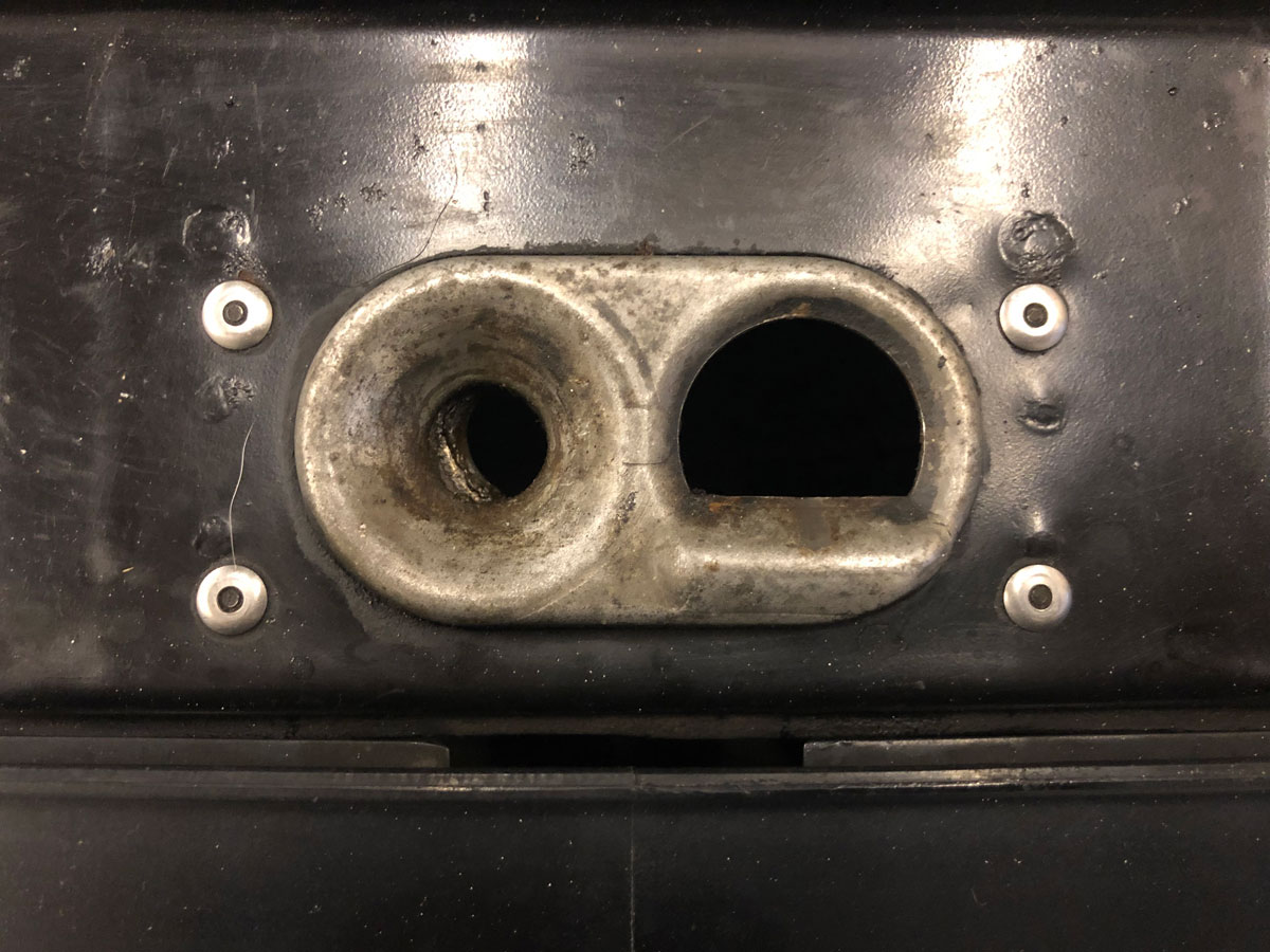

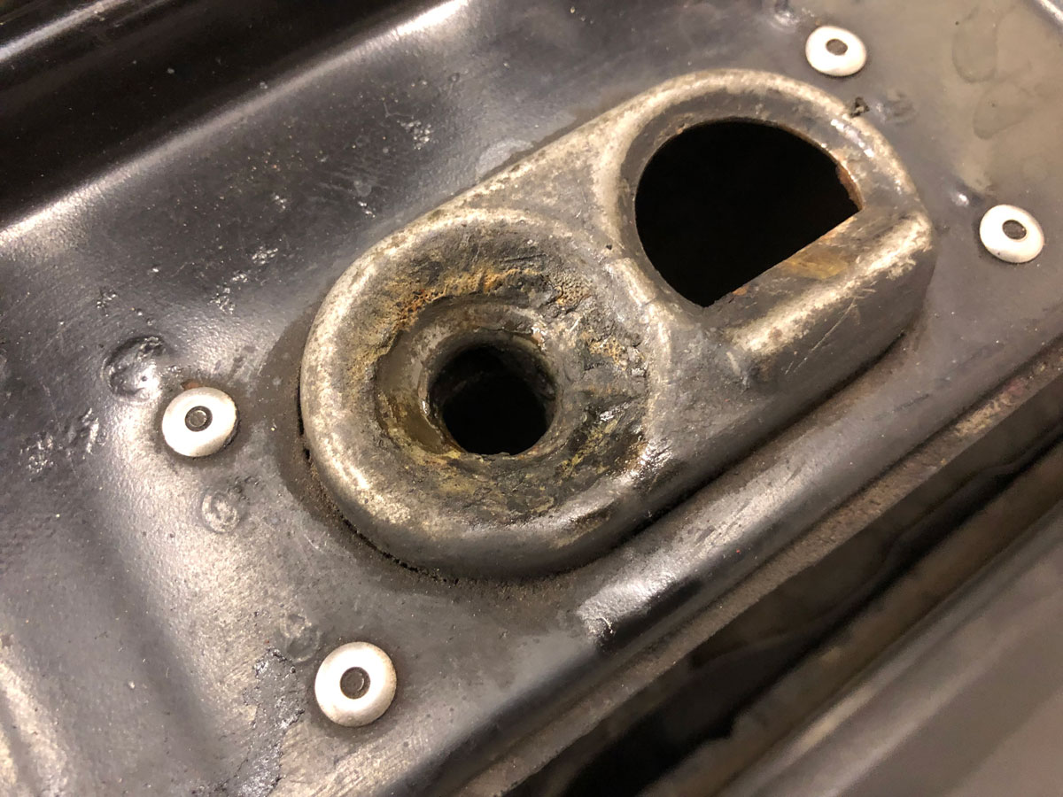

    Ever since buying the car the brakes have been terrible. The pedal was really soft and would go almost all the way to the floor. Bleeding the system improved it slightly but I knew the brakes would need looking at before I got the car properly back on the road. One morning I went into the garage and saw a huge puddle of brake fluid under the car, and knew it was time to try and sort it out. Removing the brake fluid reservoir revealed this horror show.
    The rubber grommets that seal off the reservoir had perished years ago, and the brake fluid had been leaking all over the master cylinder and booster. The corrosion was so bad that even new grommets were not able to make a proper seal between the master cylinder and the reservoir. I knew that in the coming months I was going to pull the whole engine out, so decided to try and get it working as it stood, and would replace the whole system at the point I rebuilt/refreshed the motor.
    The next step was to try and create a smooth surface for fresh grommets to seal up against. I used a file to carefully flat back the surface where the grommets sit in the master cylinder. I then used fine sandpaper the get the surface as smooth as possible.

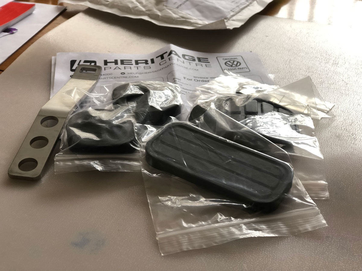

    I then fitted some fresh OEM grommets and despite the horrific state of the master cylinder, they sealed up nice and tight.
    I fitted the reservoir and topped up the brake fluid and 6 months later the system has leaked a drop of fluid and the pedal is nice and firm. That said I will be replacing the whole system in the near future, but this repair has allowed me to enjoy the car over the summer, and if I didn't know the whole area was corroded I wouldn't even plan on a rebuild simply because it has all been working so well.
