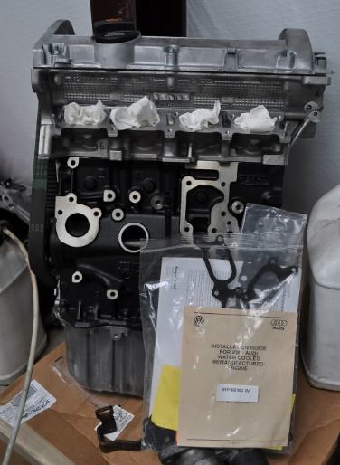

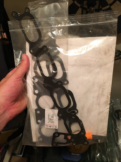

    Have all the paperwork, 0mile engine from the dealer
    [​IMG]image by isaacpettit, on Flickr

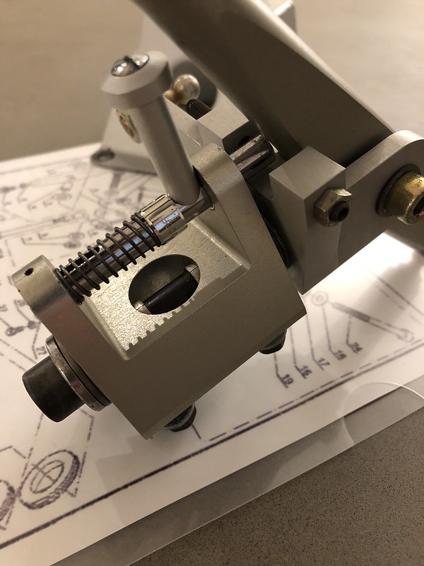

    Also had planned to run one of CAE's "underfloor" shifters ( http://www.shop.cae-racing.de/index.php?a=230&lang=eng ) but their US distributor keeps telling me they don't have one that will work w/ my setup. Basically it only needs to be compatible w/ the gearbox, as the center tunnel of the car will be modified anyway, so mounting it won't be an issue. Can anyone confirm which of their cables I would need to use the 02C w/ 6-speed VWM gear kit?

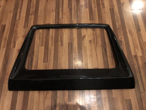

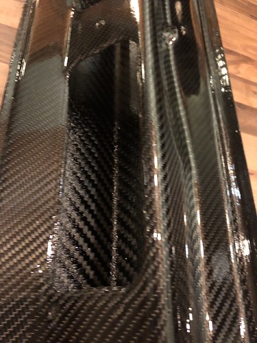

    Carbon rear hatch, very light, probably under 5lbs as it is.

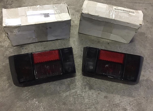

    FIFFT black tails to replace the smoked Hella ones.

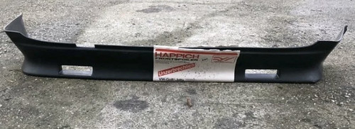

    Happich/ Vestatec front spoiler as another option to the BBS unit.

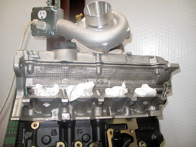

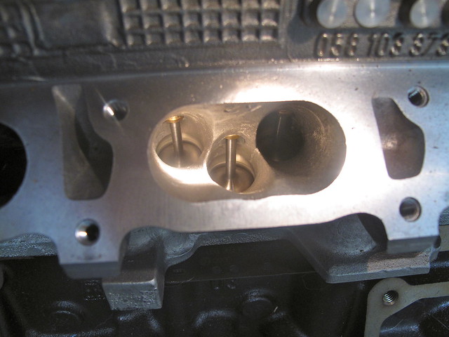

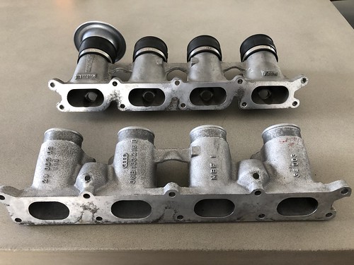

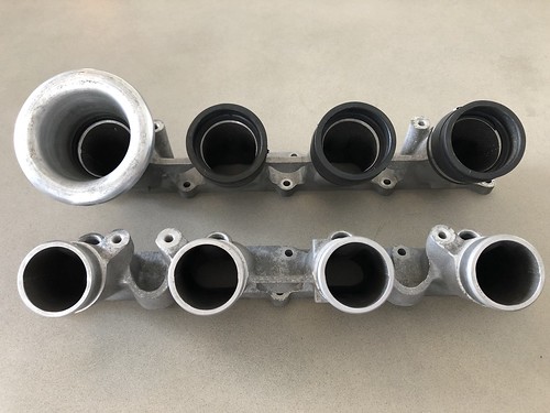

    ADR inlet manifold for the new setup. Apparently there is both a small and large port ADR code engine head, so be careful you buy the right one! I didn't realize and bought a small port by accident. Lesson Learned!
    [​IMG]Untitled by isaacpettit, on Flickr

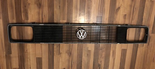

    Early grill from the Westmoreland plant near where I was born in the 80's

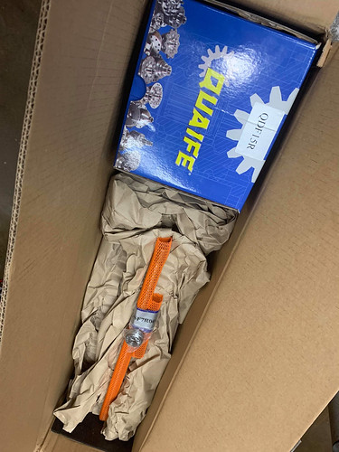

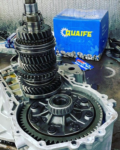

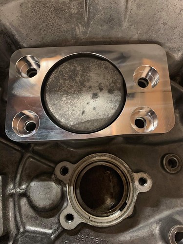

    Quaife ATB LSD fitted along with a lower bearing girdle. Some other bits into the gearbox as well. And picked up a quick rack from Quaife as well.

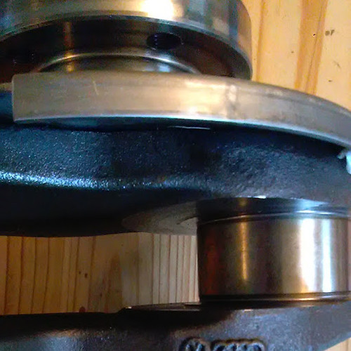

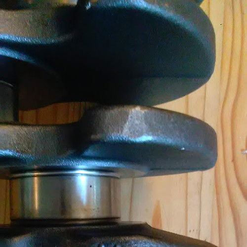

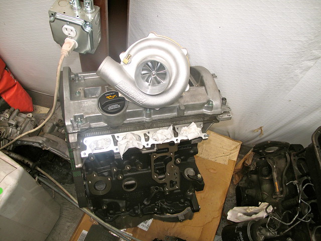

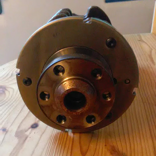

    Journals on the crank look pretty good. Needs to be modded for the gas motor still but should work, was a low mile engine it came out of.

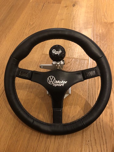

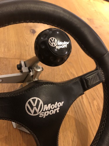

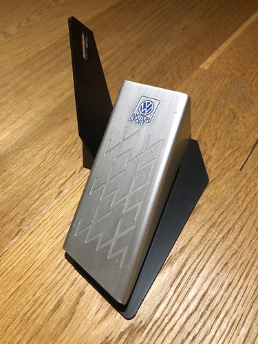

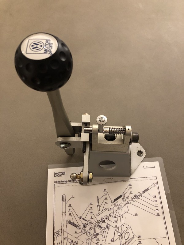

    Everyone likes some old school VWMS goodies now and then
