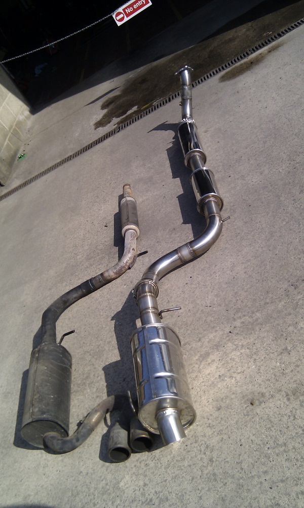

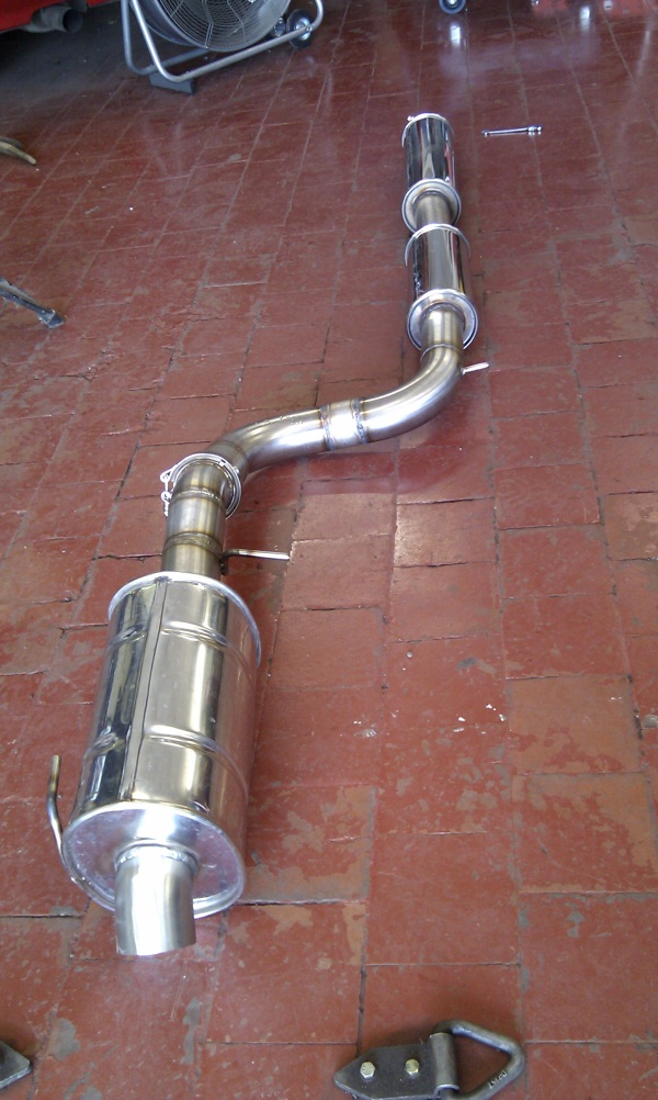

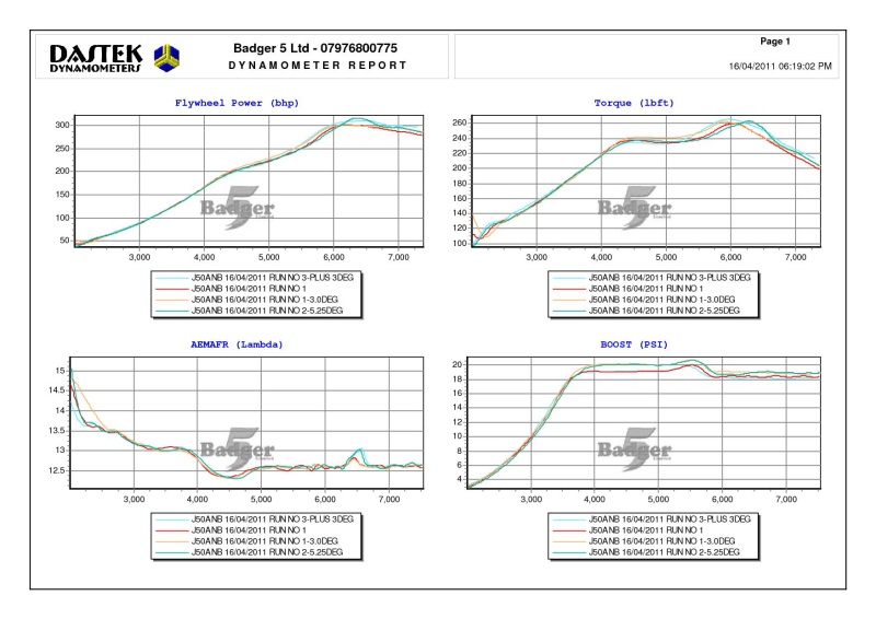

    This is in prep for its new hybrid k03/4 turbo.. which is >300bhp spec turbo packaged into a k03 fitment, bolt on. Hybrid is fitted, but its old exhaust was never going to be adequate for its new flow potential.. Same turbo internals on a local S3, makes 338bhp/307lbft from 20-22psi boost.

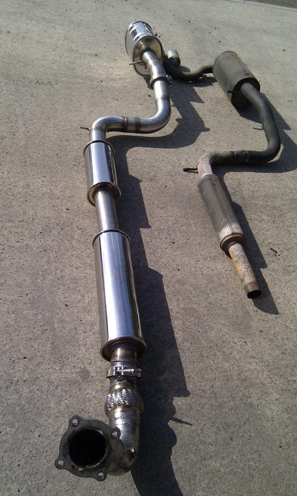

    okies.. 3 into Lupo does indeed GO
    3" TIP - check
    3" Downpipe - check
    3" Full Bore exhaust - check

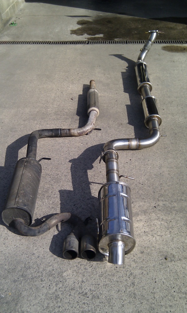

    Comparison to its previous so called 2.5" system (which was 2" internally)
    The completed 3" exhaust - 3 box system

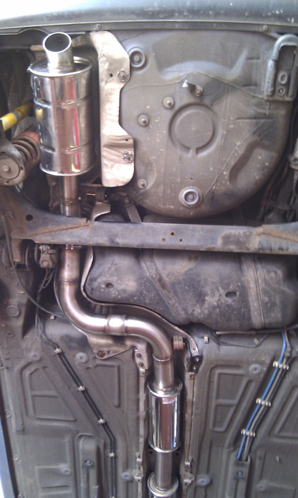

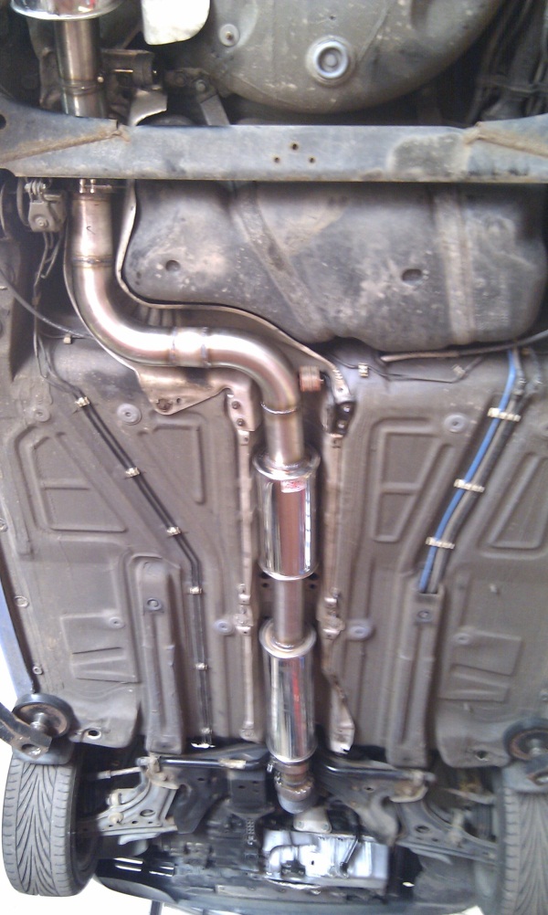

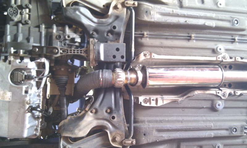

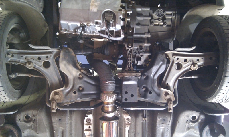

    Fitted underside view

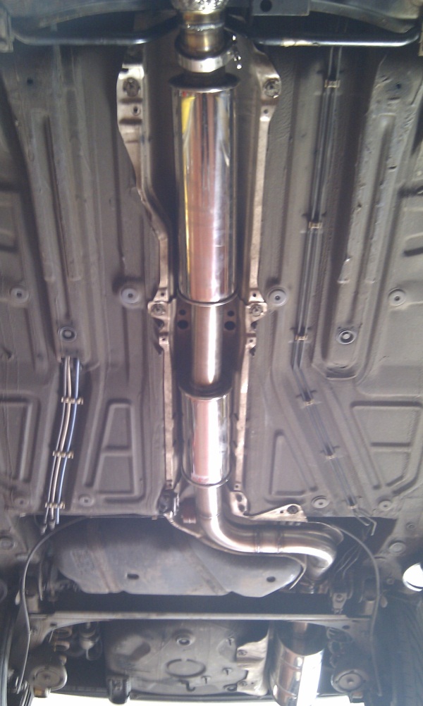

    Fitted front underside view

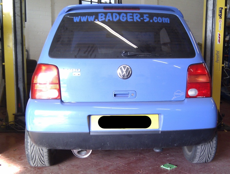

    And how it looks from the normal view of the car.. What 3" exhaust??

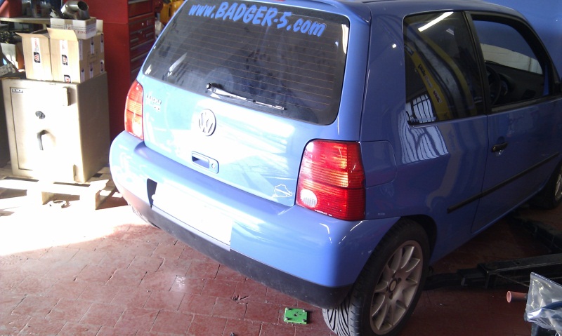

    started 1st time after priming the oil system up.
    idles like std, drives like std.. amazingly.
    550cc injectors, 80mm MAF housing... K03/2283 hybrid on it (prototype)
    waiting on inline fuel pump to arrive as I dont expect the in-tank pump to be able to deliver the required fuel under load this hybrid will pump air for.
    EGT probe fitted for logging when mapping to see how the hotside copes

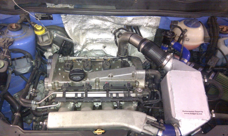

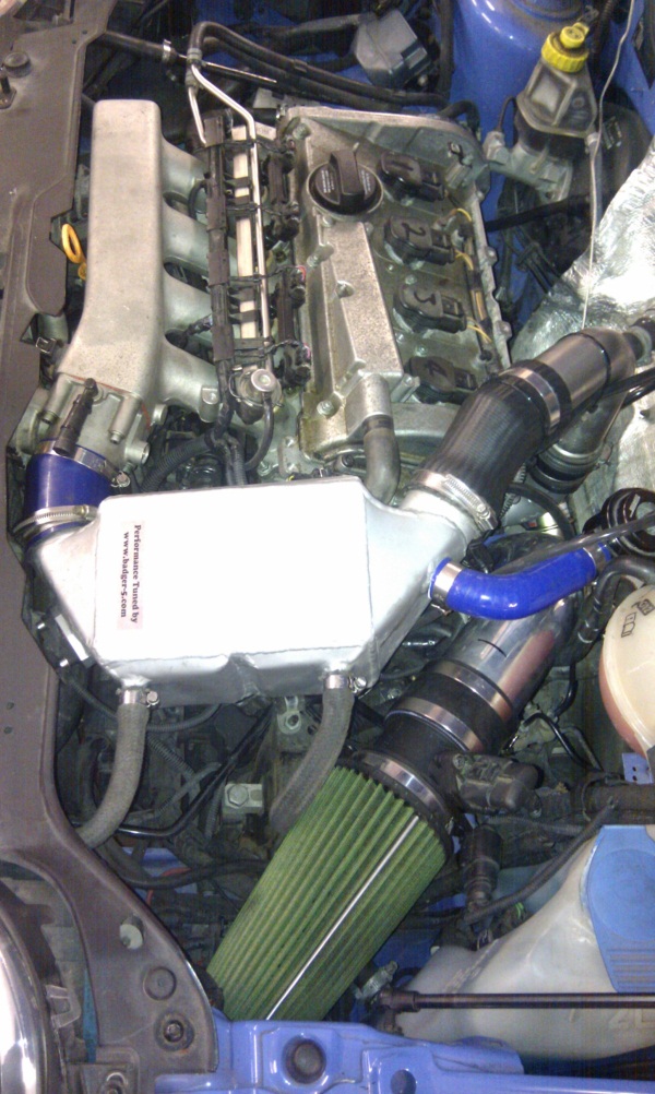

    couple of engine pics of its current install. its a mixed bag of pipes as it was originally done, which I will change for something a bit more Badger5 when I get time..
    "compact" installation - lol
  6. badger5
    15
    nr Glos
    bolt on k03 fitment type turbo

    whats is the rectangular box piped to the t/b?
    Pete
  8. tshirt2k
    tshirt2k Forum Junkie
    Oct 21, 2004
    325
    Herts
    Charge cooler.
  9. StuMc
    Nov 12, 2004
    269
    50? 20` 47 N - 06? 57` 57 E
    Charge cooler as 2k says, since I guess there`s very little room for a decent air-to-air intercooler upfront. :thumbup:

    water meth added and more torque now.
    still needs fmic badly.. and a clutch, lol
