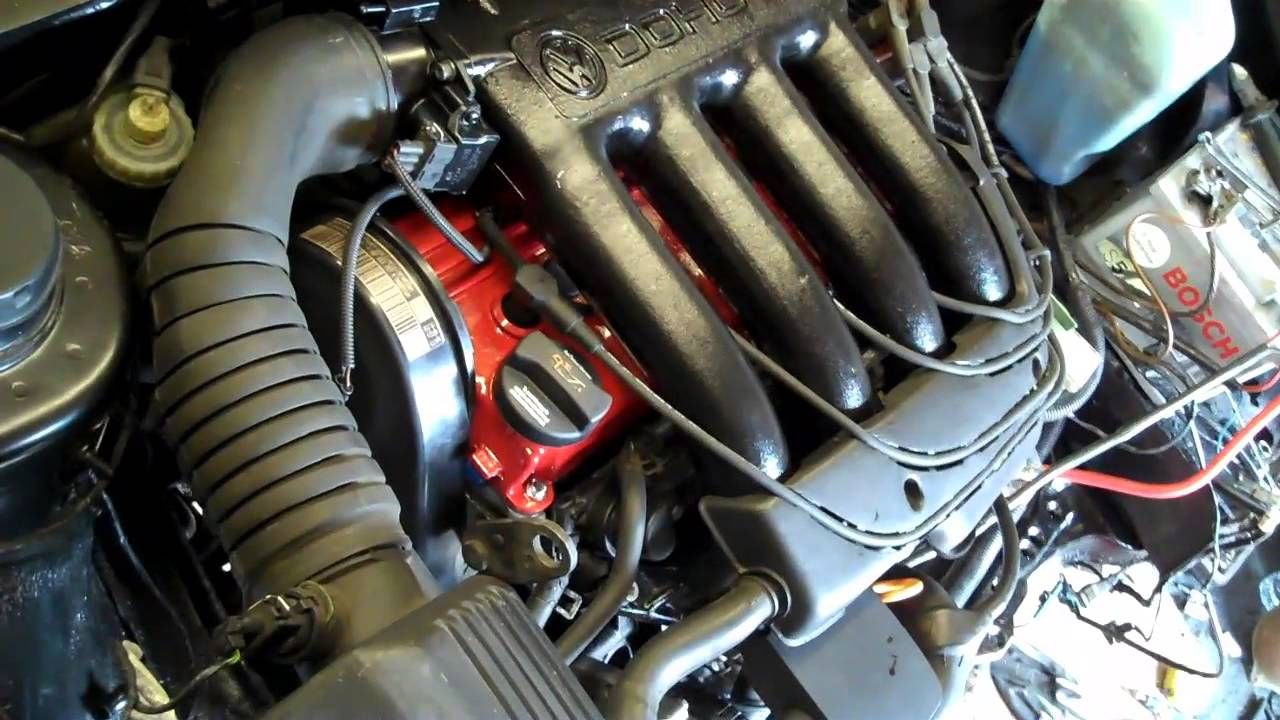

    idle stabilisation valve, its the metal thing pushed into a hole on the front of the inlet manifold with a pipe over to the air box. it should vibrate with ignition.
    the 2 pin plug you can delete is near the throttle body, it should be clipped onto the black plastic breather pipe. you'll notice the connector housing its fitted on has no pins because the heater isnt there, its only for really cold climates :)

    its the metal tube on the front of the inlet, under the plastic spark plug lead holder, you can see the vacuum hose from it to the side of the airbox in your picture. you can get to it without taking off the lead holder :)
    its fitted to the big hole visible here
