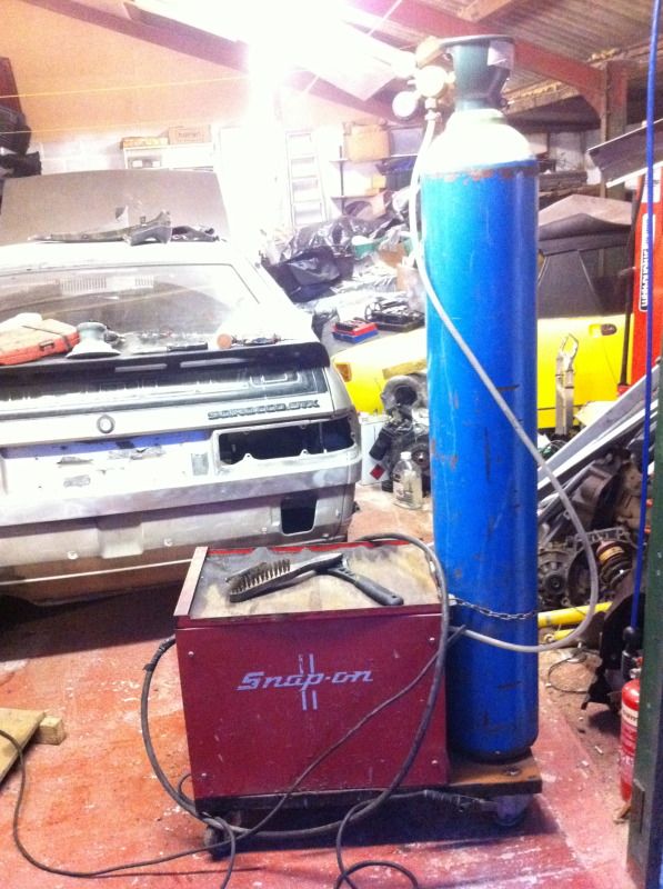

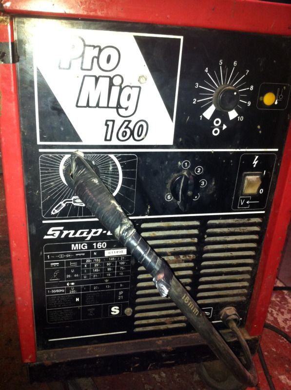

    Snap On Pro Mig 160 - inc big gas bottle and regulator for 200. Seems to weld OK so far.
    It needs a new torch though - it works but it's a bit tired. Anyone know much about Euro Torch upgrades, or done one on a Snap-On / Cebora Mig?

    I bought a Euro Torch and converter in a set for about 65 including postage. The company is Technical Arc up in York. They manufacture welders such as Portamig (generally seen as a good brand) so I was reasonably confident.
    I've fitted the torch tonight - had to shorten it slightly, and it's a bit fiddly getting it all lined up, but the wire fed through without a hitch, so with a bit of luck I'll get a chance to use it tomorrow night. Hoping for smoother wire feed and more controllable welding.

    I've ordered the flow meter, so it'll be interesting to see if I was about right. It's a massive bottle (as you can see in the pics) so the 95 bar that's left should last a good while. Shame Energas don't have an agent down south. I don't suppose someone else will want to fill their cylinder, so it might be scrap when it's empty, but I'll ask around the local agents.
