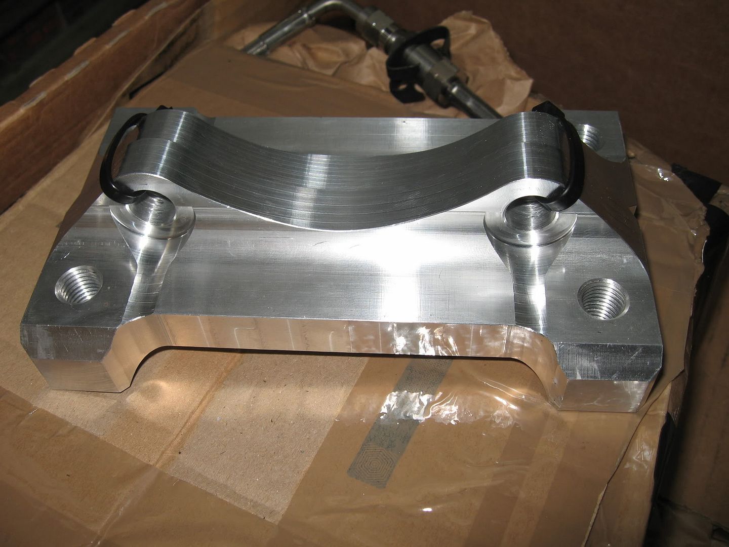

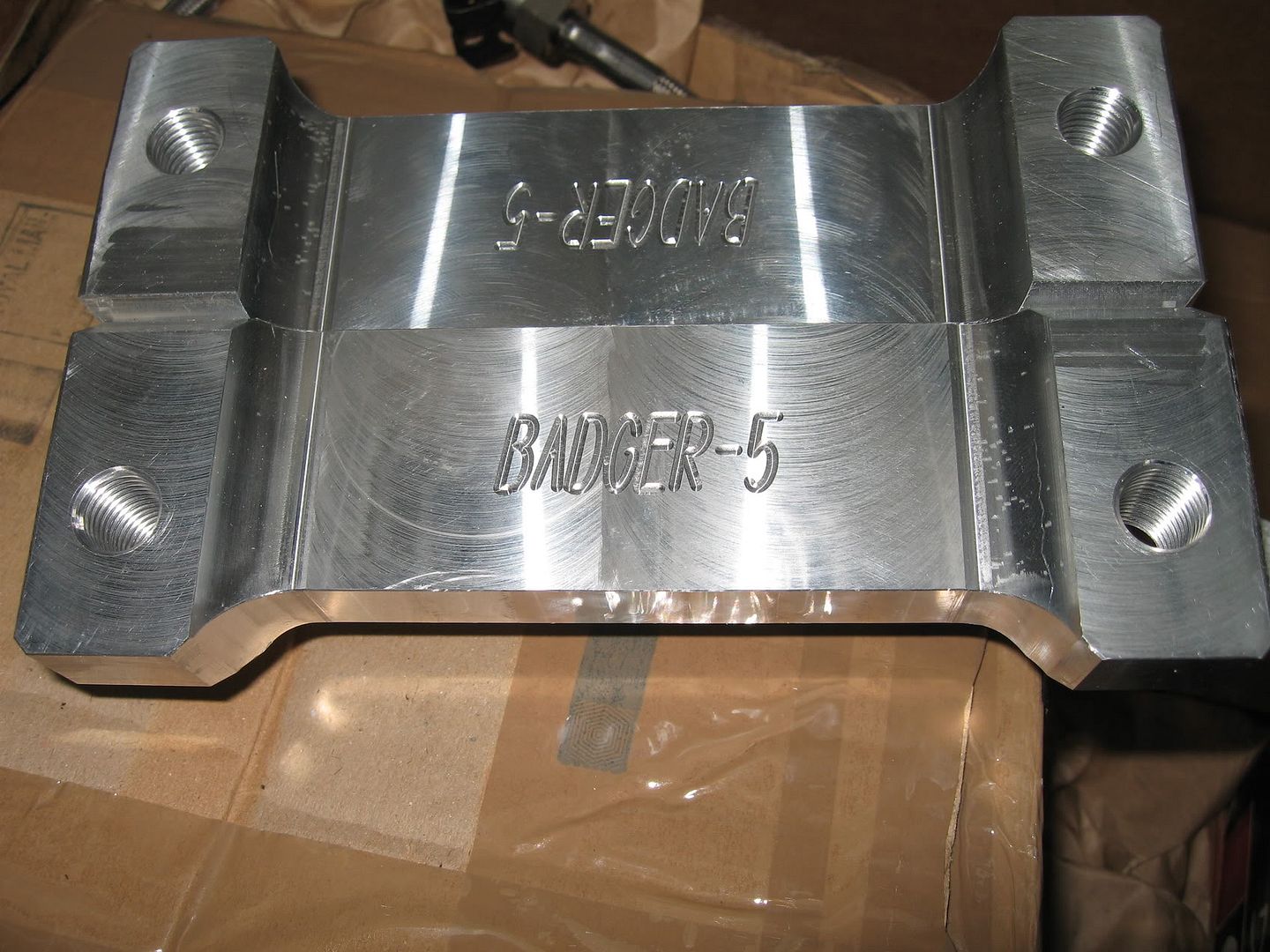

    essentially 305x28 setup is what the ibiza cupra-r came with yes..
    i dont have part numbers, as I make some of the parts up myself.
    (cheaper than oe, and better quality)

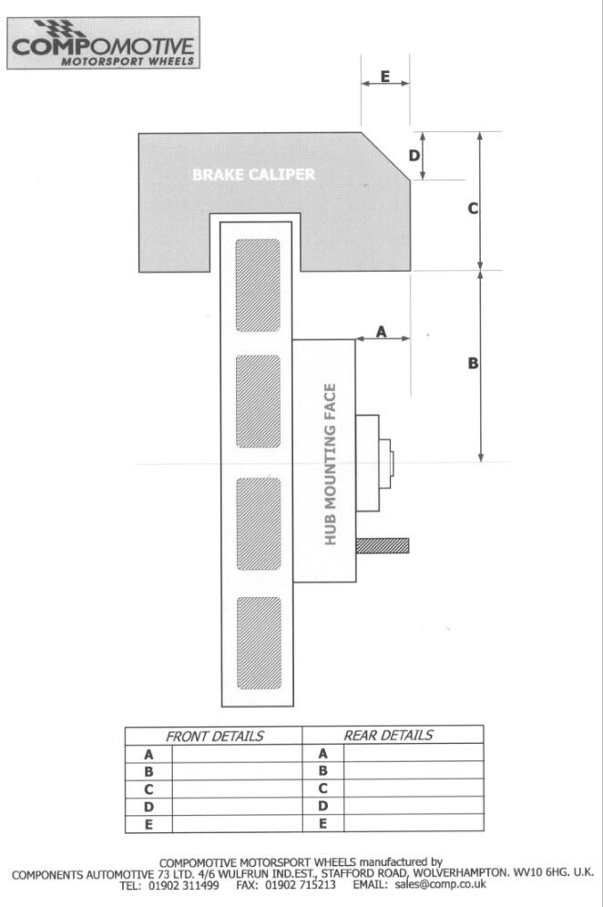

    Can I trouble you to help me with filling out this chart? It's for the Brembo GT Junior kit, I need to see if the wheels I have will clear.
    Thanks
  13. badger5
    15
    nr Glos
    your dimension A will need to be <50mm to clear the 5x100 323x28 brembo gt junior kit, or >38mm if the 305x28, 4x100 kit

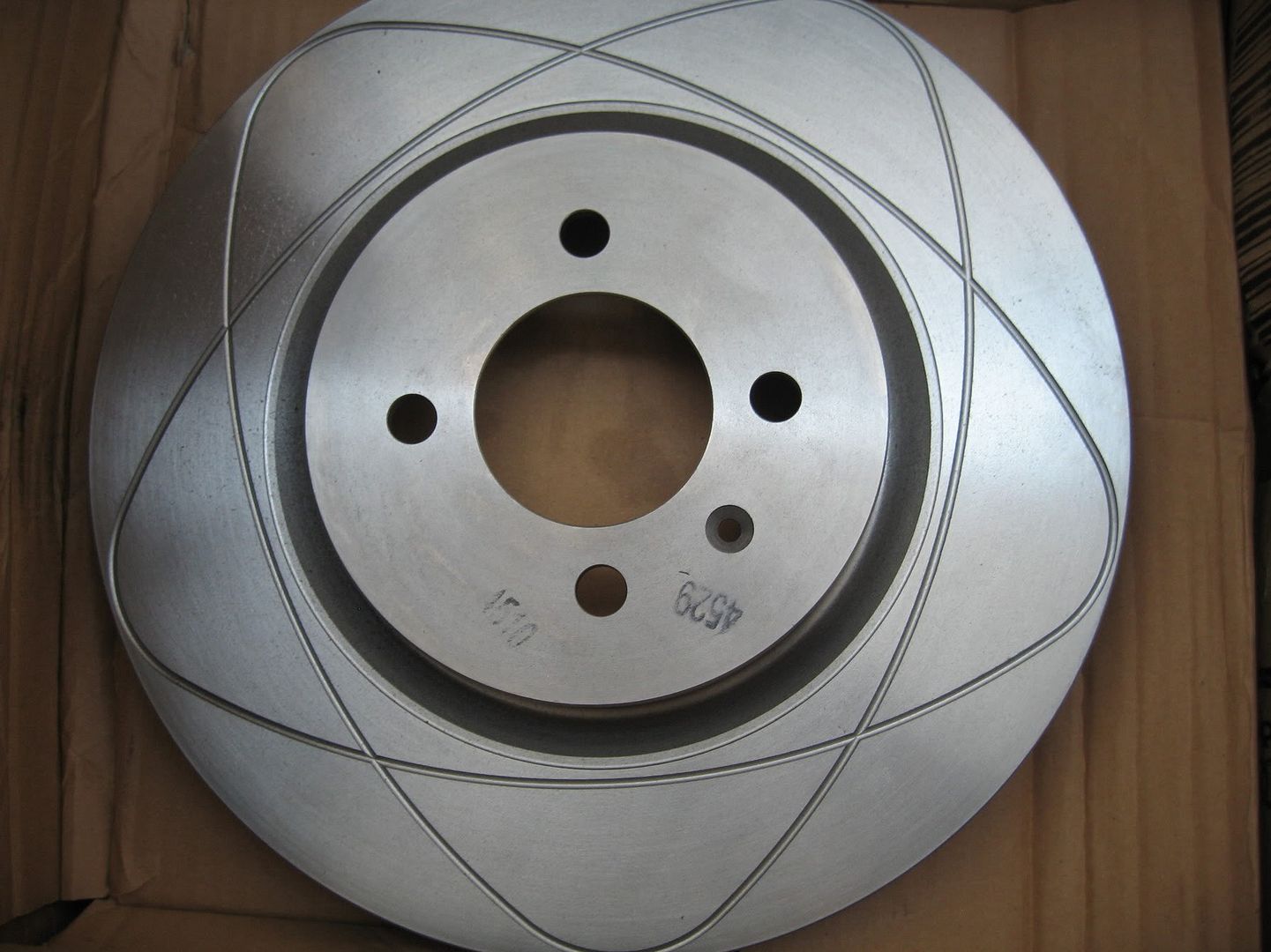

    Can you still supply eliptically grooved 280x22mm Brembo discs for a late spec (1990) 4x100 Mk2 Gti? I'm now running Audi S2 (Girling 60) brake calipers and carriers and would like to refresh the discs from my existing 280mm items (I was previously running the G60 variant Girling 54 calipers over these).
    Also - what sort of pad options do I have other than OEM and EBC Yellowstuff with the Girling 60 calipers? Ferodo don't appear to do DS2500s in the correct fitment.
    Thanks!! :thumbup:
  16. badger5
    15
    nr Glos
    disks I do and have in stock eliptically grooved in 280's
    I dont think ferodo cater for your caliper tho.. I have been asked this before and they said nope.. not one they do I'm afraid.

    Are the discs you have eliptically grooved the 4x100 Seat Ibiza Cupra items? Are they one or two piece? I'm intending to use on track, so am keen to get something fairly durable.
  18. badger5
    15
    nr Glos
    the ones I mentioned are 280mm G60/ibiza cupra brembo disks I have had machined..
    2-piece I do yes.. different animals tho.. and very different price.
