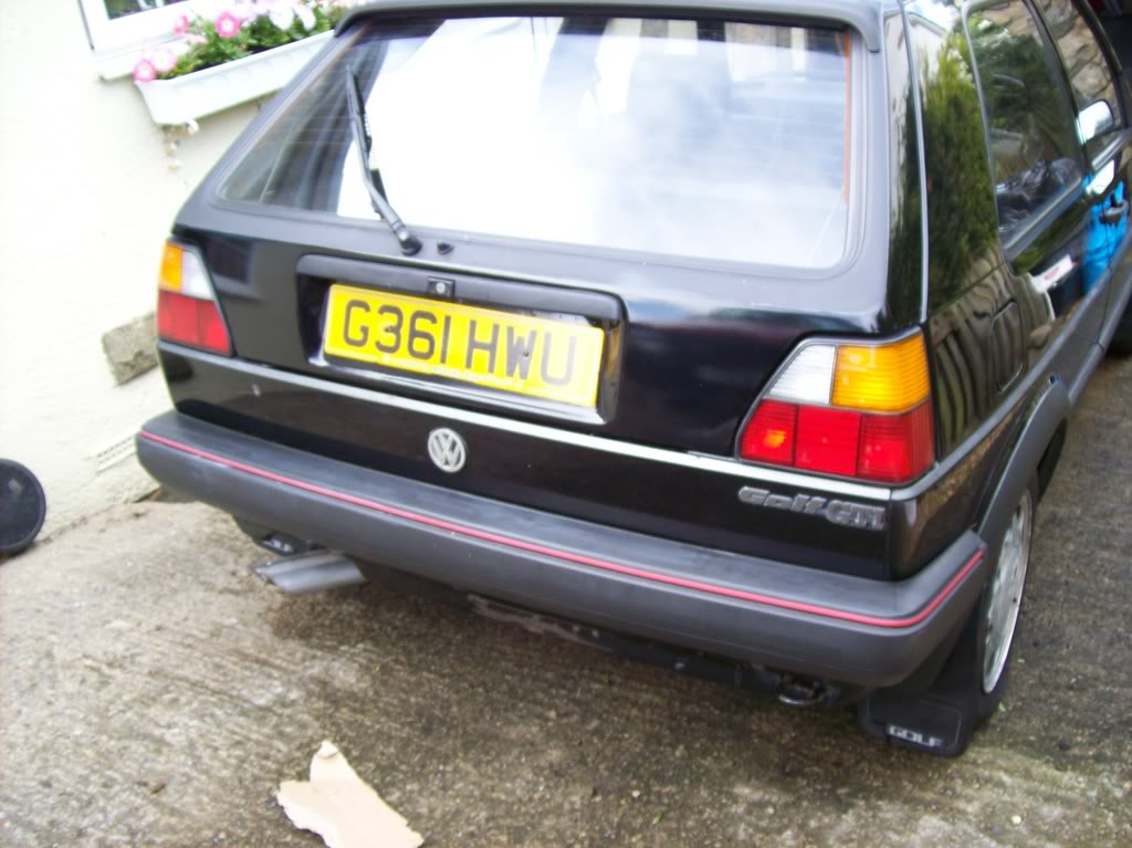

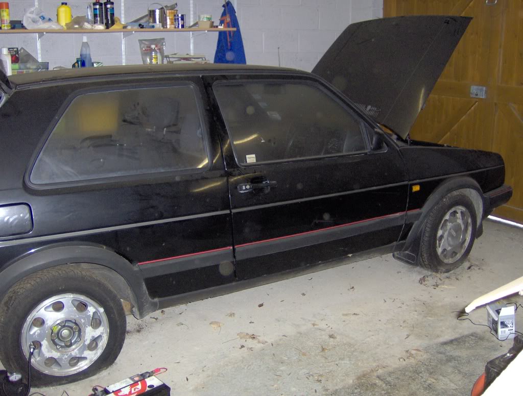

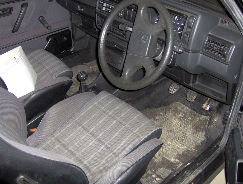

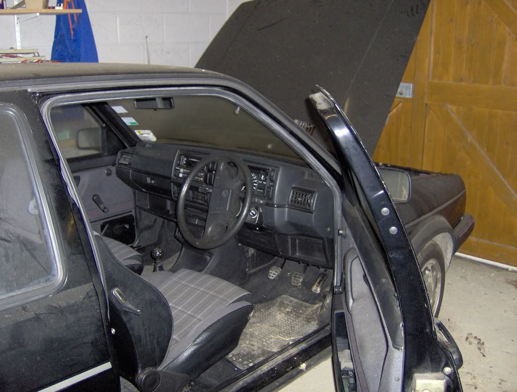

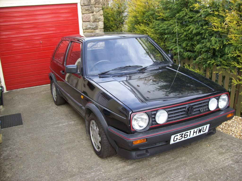

    got this car when i was 16 (now 17) and have been restoring it for a while now.
    it had been dry stored for 7 years and with only 84,000 onthe clock and it wasa bargin to be had! esspecially when it would have just gone to scrap.
    these are the first pics of when i went to see it
    BBS's
    resprayed BBS's (DIY) lol
    as he stands

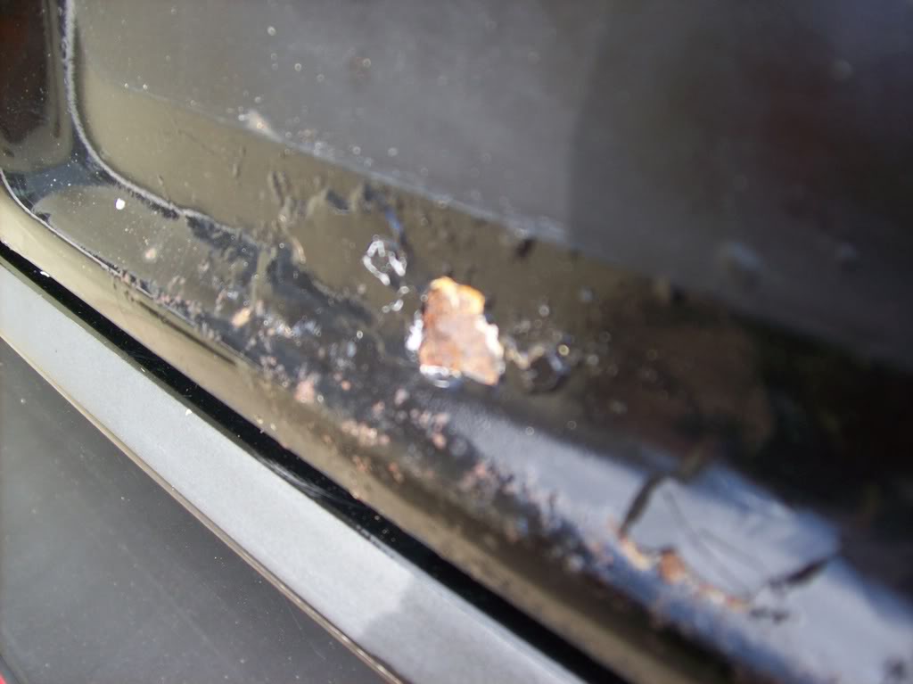

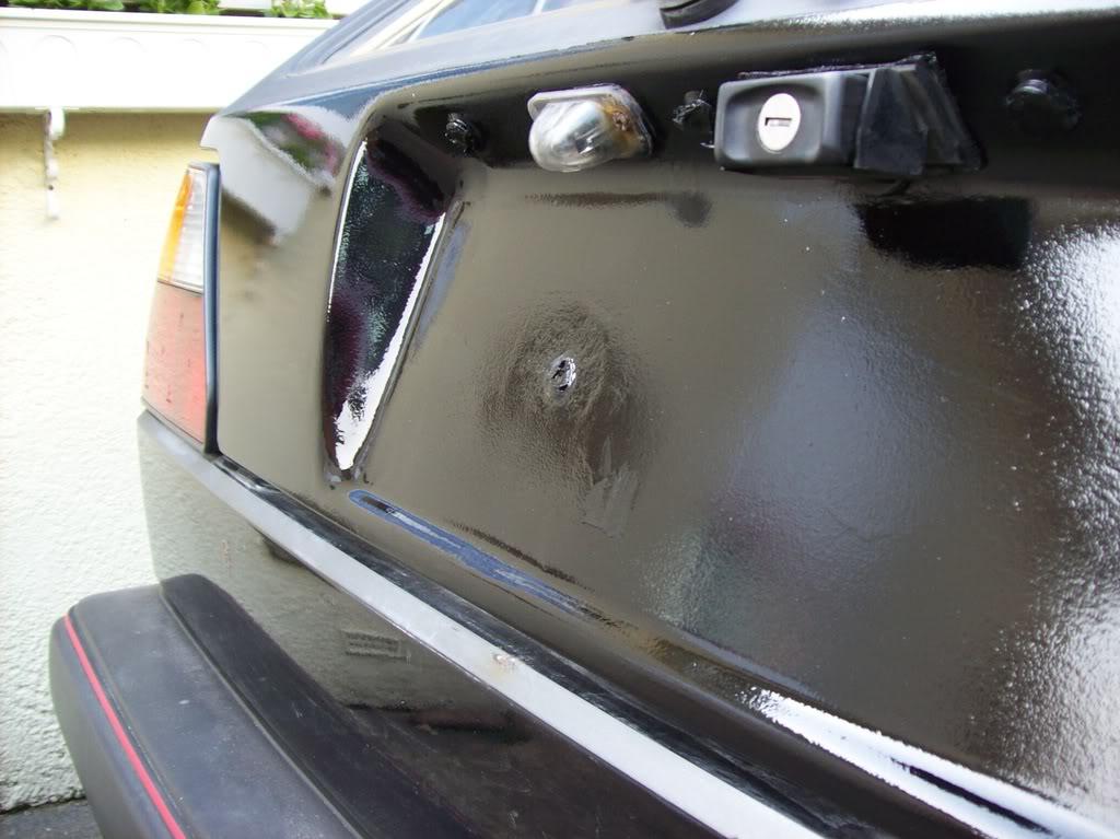

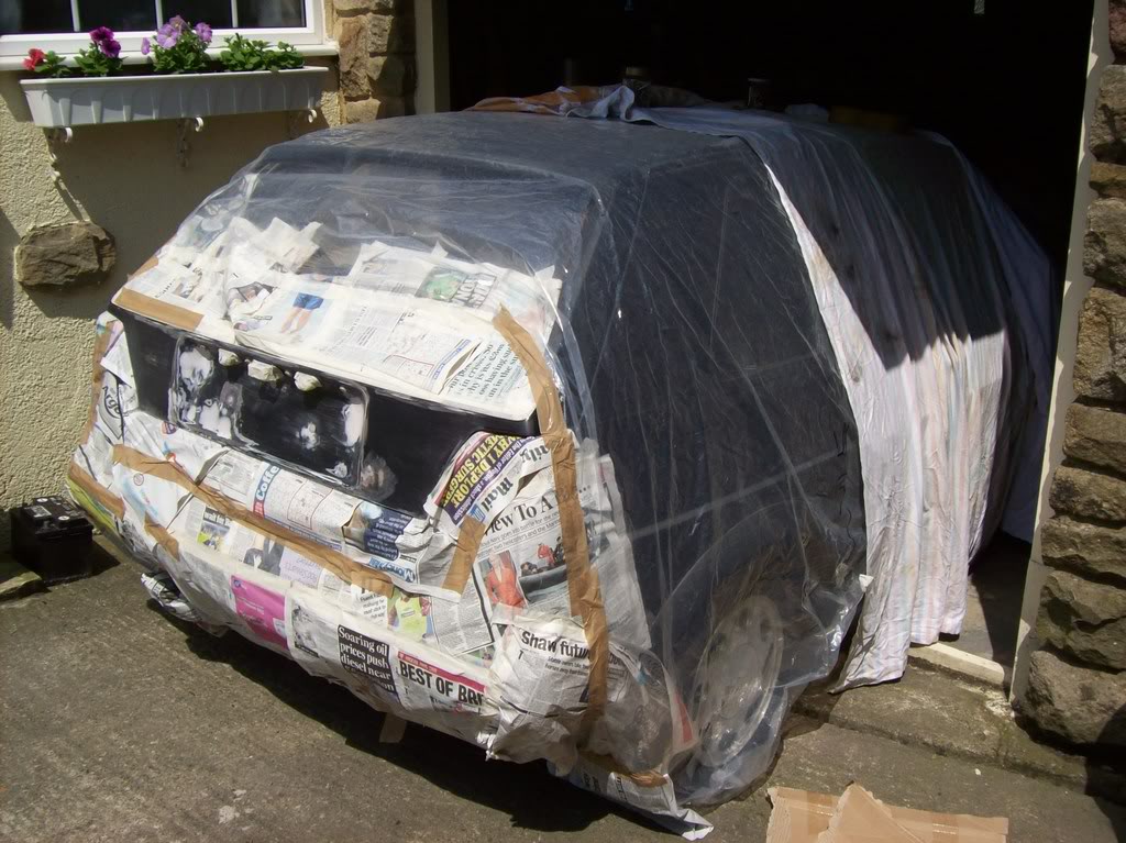

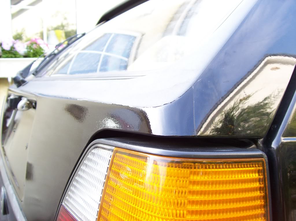

    then i tackled the rust issue at the rear
    which looked like this

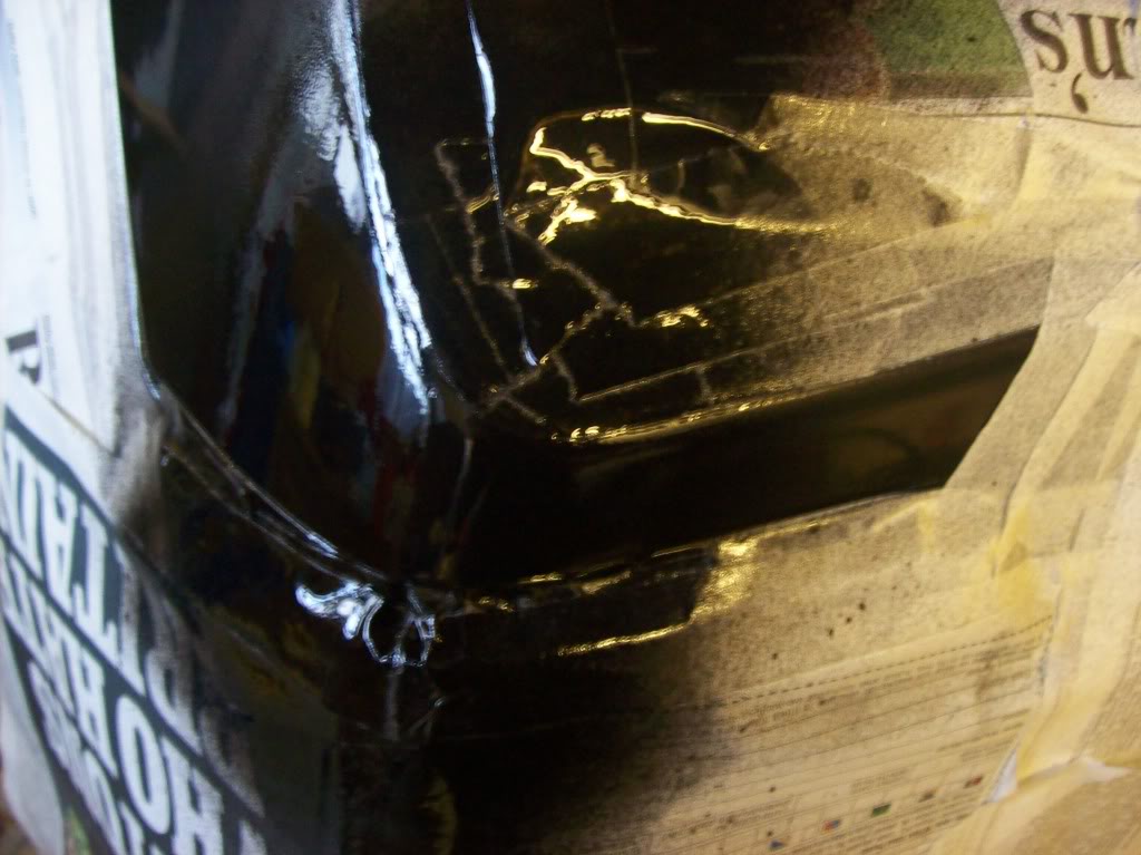

    bit of filler lol

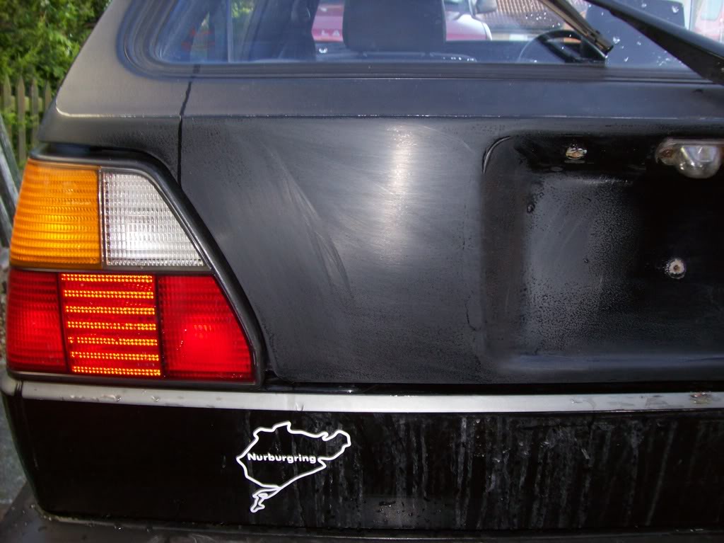

    after lacquer with horrible orange peel lol

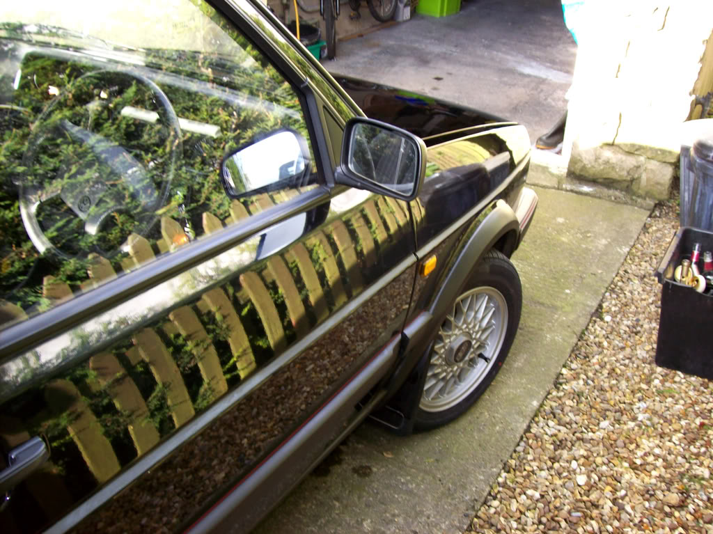

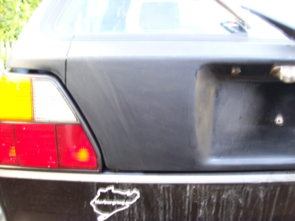

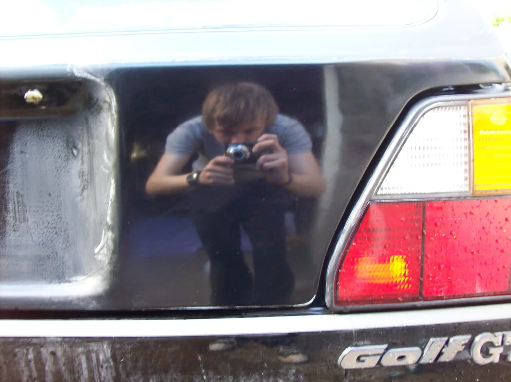

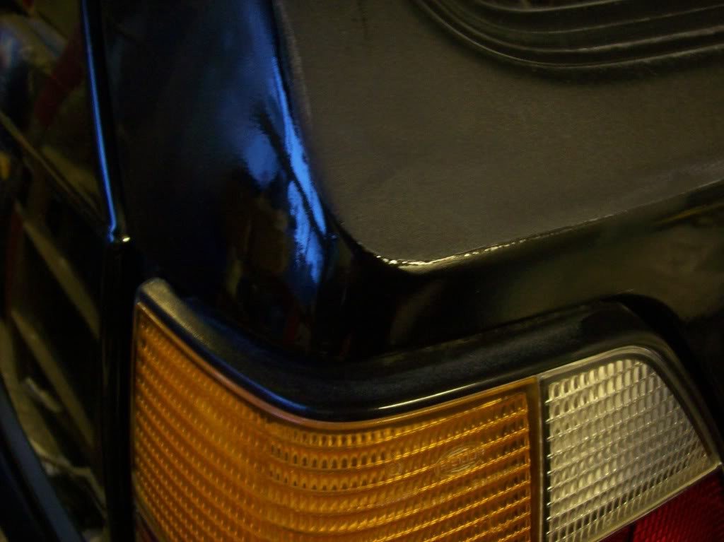

    so.. i set out work on the orange peel.. used 1500grid wet and dry(wet), then t-cut then turtle wax
    the finish is fantastic!!!! iam so pleased.. and thanks to the clubgti members who advised and helped me !! lol
    after wet and dry
    t-cut and wax on
    and no more orange peel lol woooo

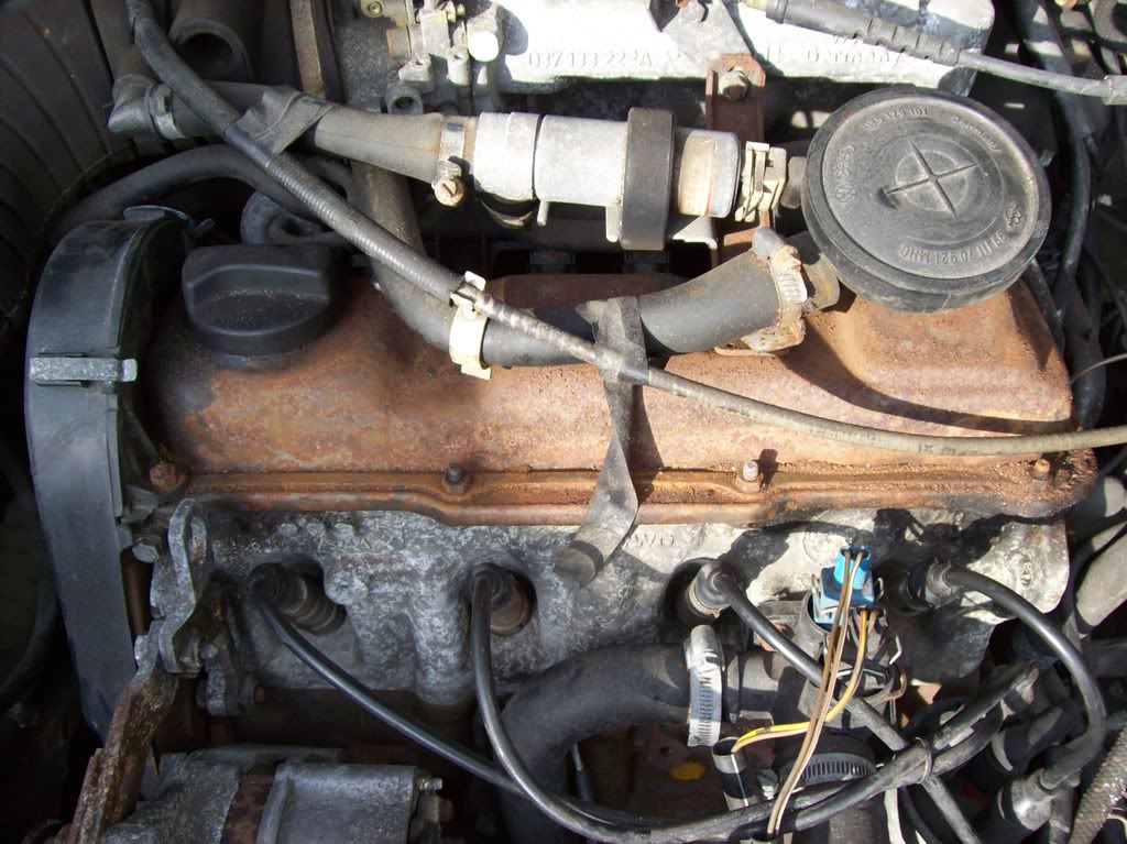

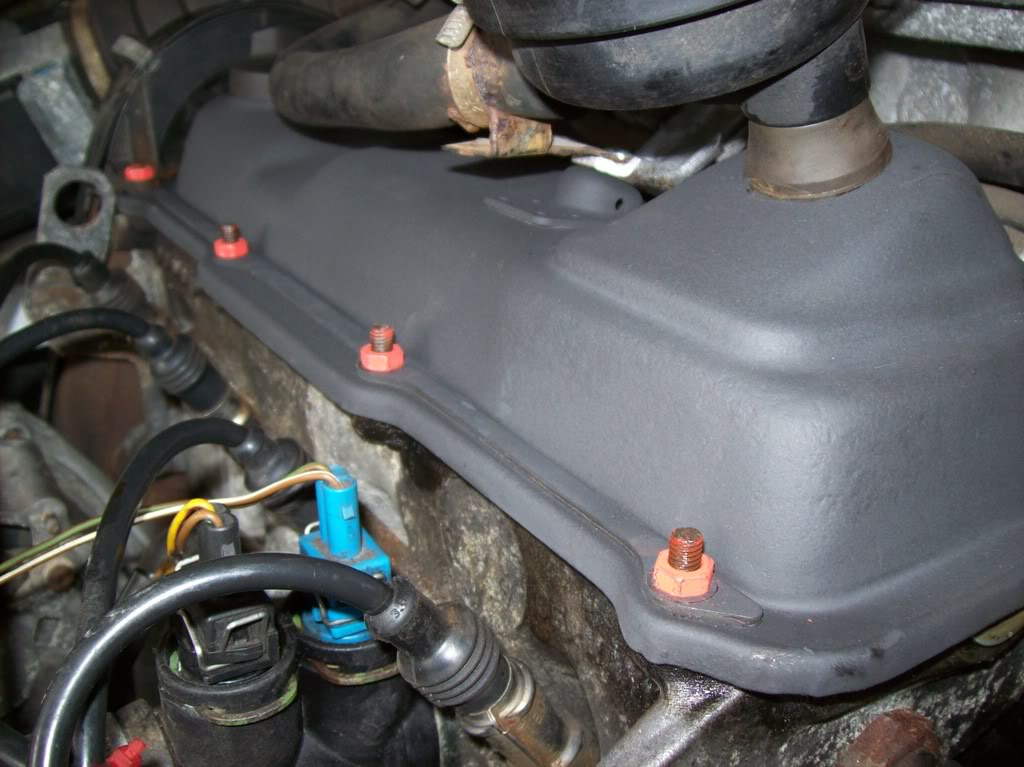

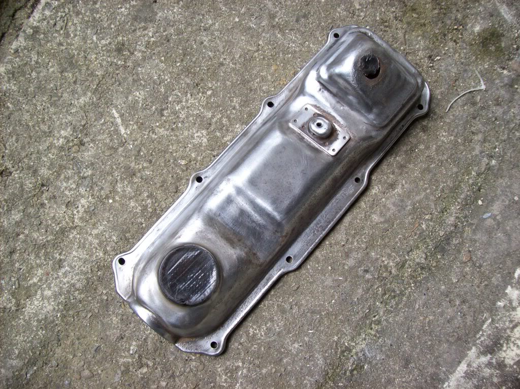

    then i was time for the rocker cover which was rusty!!
    so i polished it with various wet and dry and mops
    but i then decided to spray it black (original) lol

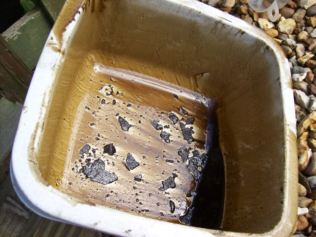

    also changed the oil.... iam glad i did this becuase i couldnt believ what came out of it lol
    nasty stuff! lol

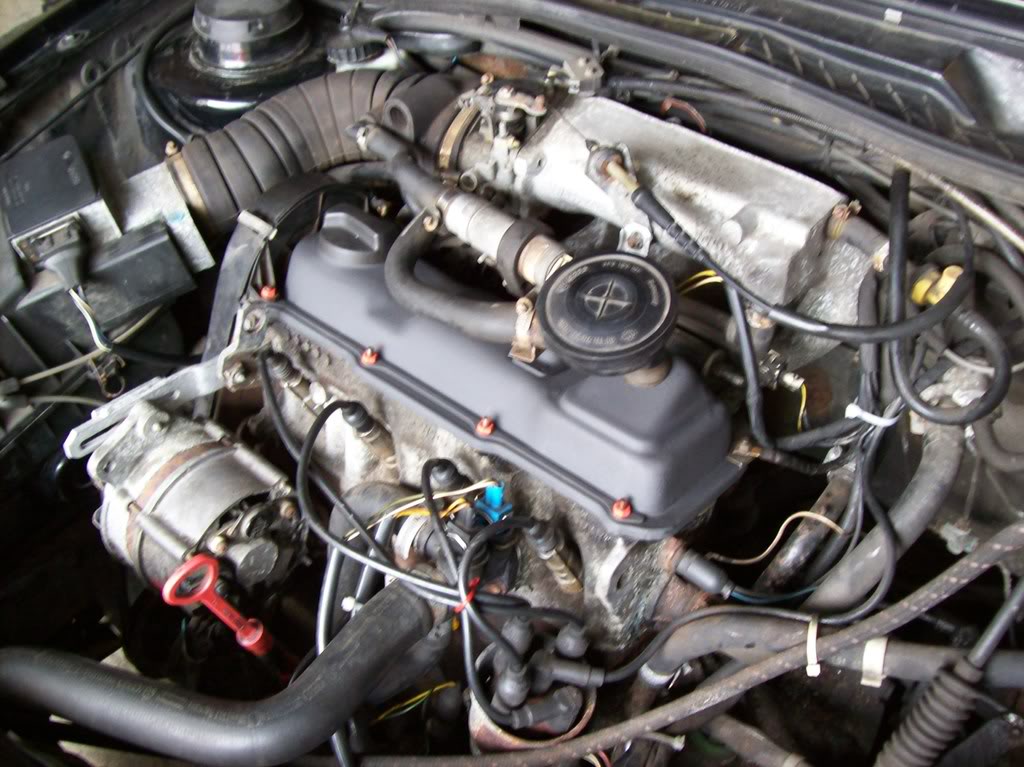

    lol. what do you guys think of my new rocker cover i sprayed, its ment to be black but came out grey lol with red bolts????

    The grey looks great. Real industrial look. It's heat-resistant paint, I hope. Mine started peeling again soon, even though it was heat-resistant, but then I didn't get every little bit of rust off. Big mistake. You've done a proper job, by the look of it.
    Well, see you at the "Rocker Cover Pride March"!:lol: :clap:

    rocker cover pride wtf.... my engine bay is v.grubby! lol

    yes it is heat resistnat paint lol[:D] ive got some heat resistant lacquer coming soon from ebay as well lol

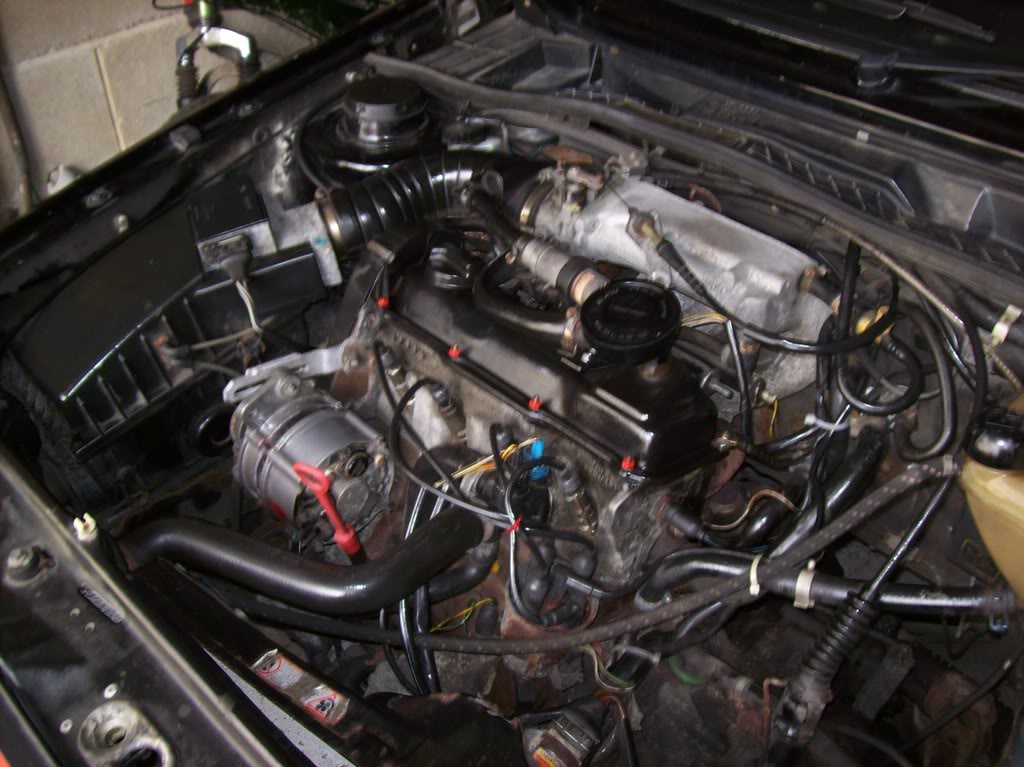

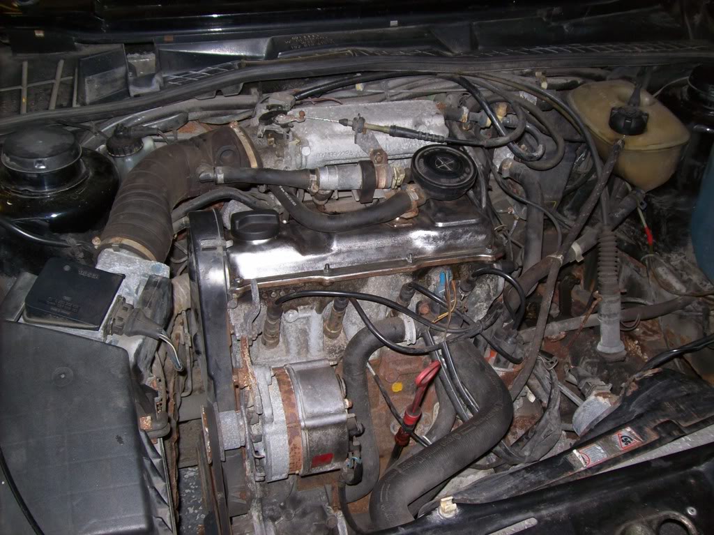

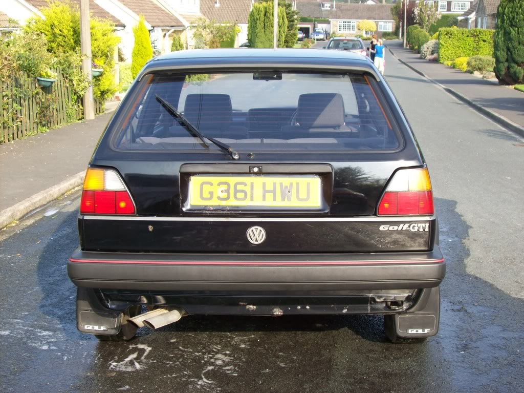

    this is the engine bay now

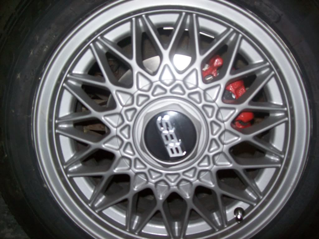

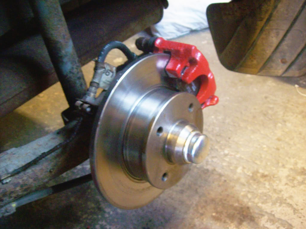

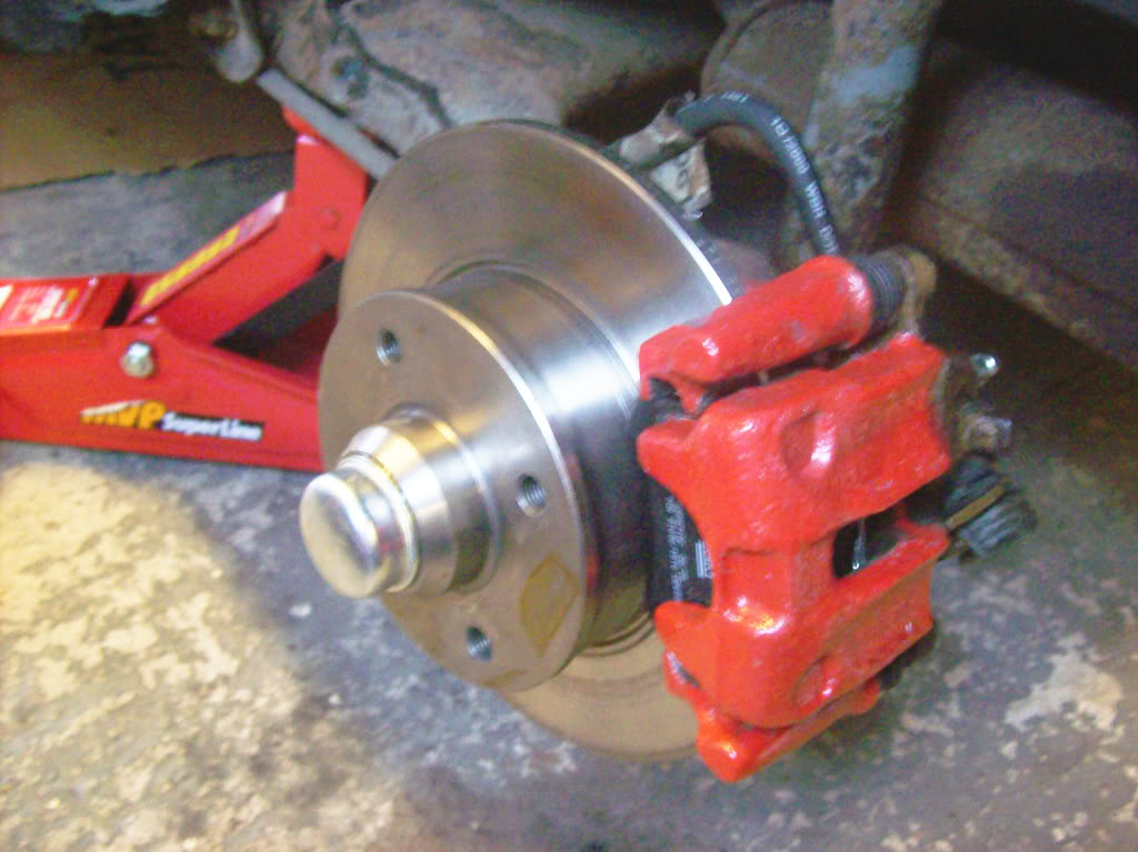

    some new goddies that i fitted in the half term hols.
    bbss i refurbed
    my lay flat wiper
    and these big improvement from when i got it imo!

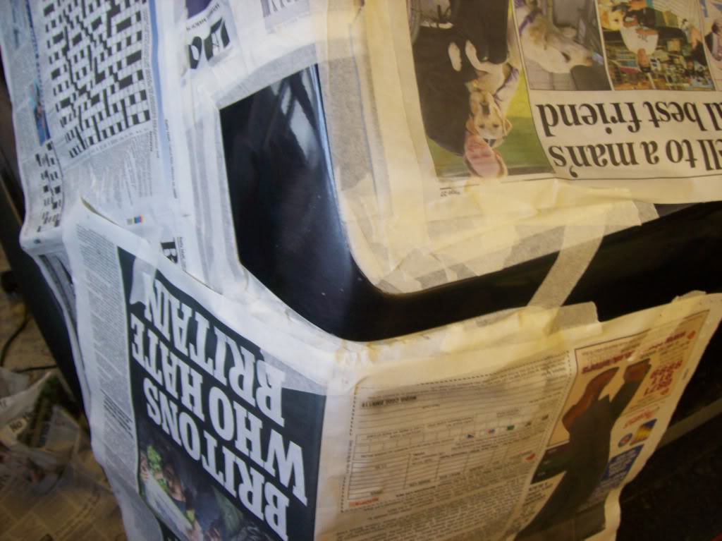

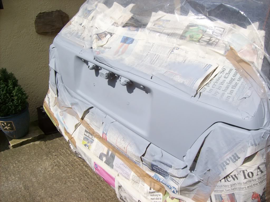

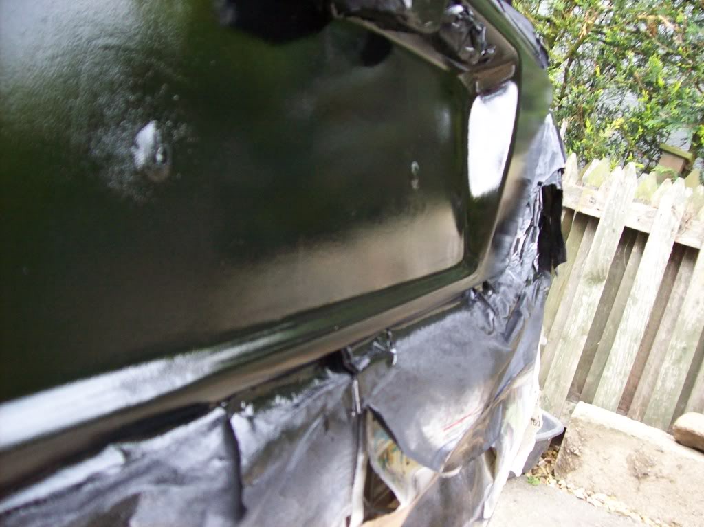

    then heres the reson i updated. the little masking lines from respraying my tailgate
    so iv been rubbing them down and getting rid.
    i did touch it up with my graphics airbrush but to my dismay after spraying i didnt know ther was moisture in the air lines so i havd to sand it all back and stop being so i got the rattle can out ! lol

    black is a nightmare to spray and get looking good but it'll get there, your exhaust looks some rusty though!

    ye it would have been worse if it was matalic lol just trying to find jobs to keep me occupied before i go metal from having to wait so long to drive it!
    exhaust is fine just passed emissions with flying colour :) lol
