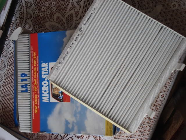

    LA19 as shown in the pciture above is the single filter element alone.
    LAG19 is the kit which will include the cage which the filter goes into.
    LA19 and LAG19 are both still produced by Mahle and are available. Costs yet unkown. Not stocked in the UK by Mahle but they can get them in, lead time of approximately 2 weeks, but with christmas that can throw it all out the window he said :lol:

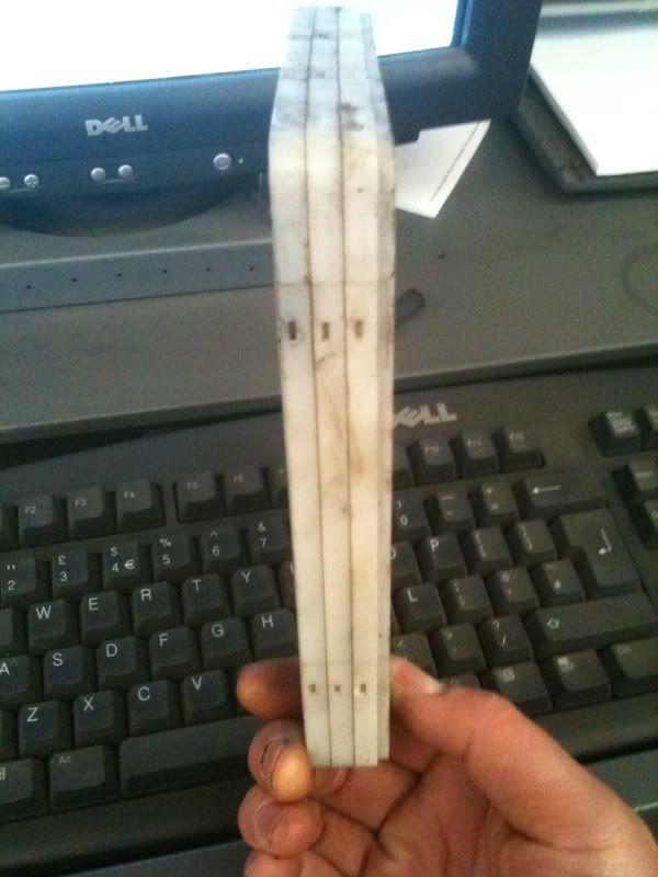

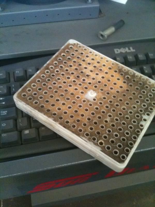

    When i last lifted the scuttle trim on mine to unbolt the dash i found this lying next to the blower gauze. Not seen one on a mk2 before neither had any of the guys at work.
    Its plastic in layers with thin foam on each layer, most of it's disintergrated. Seemed to be the right size for the blower intake. Doesn't have any numbers on it whatsoever and no clips that would secure it.
    Anyone seen one before? Reckon its someone elses attempt at a pollen filter?
