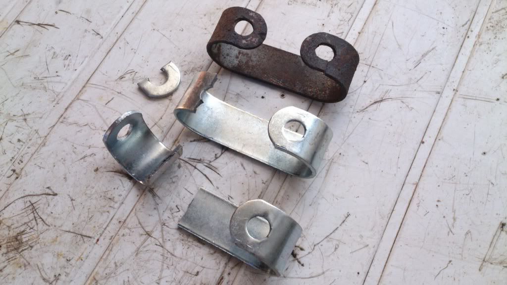

Car is a carbed 1.8 Mk2 Scirocco GT2, I have been having a nightmare with these clamps that I thought were good quality.. Even trying to use the original ended in it snapping. I had already commented on this thread(http://www.clubgti.com/showthread.php?251595-driver-downpipe-sealing-ring&highlight=exhaust+c+clamps) about possible quality issues and now I am without car! The new one that that was successfully fitted actually broke on the car.. Other side used old one and it's held.. What is the vw part number? and can I get them from VW or VW heritage? I know GSF do them but I really worry about the quality. Need to get these ASAP as I now need to commute to a new job on two buses.

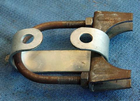

They are a bit of a pain these clamps, one way round the issue of them snapping and being a right royal pain is to use the proper SP tool or the handy method shown below

i used new genuine clamps with the exhaust clamp trick above, no problems at all. the problem i did have was trying to get the new hard metal ring on the manifold, it just wasnt happening. id have to take it off the car and tap it on i recon! in the end i put the old one on with a good smear of exhaust paste... which didnt stop the blow id recommend you bin all that rubbish entirely, instead fit a 6 bolt type injection manifold and downpipe way better flow you will notice a difference. might have to fit an injection exhaust system or reducer, im not sure what the diameter of the downpipe is

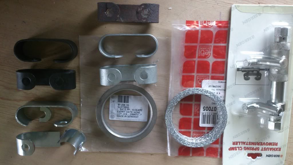

Ok now fitted. From left to right you can see the black Bosal clamps, below the unknown new broken ones then you've got the vw ones with solid metal ring, then the Febi Bilstien wire type ring and then the tool for the job. You can see that the VW clamps look better in quality in terms of their symmetrical shape, over all quality and that they seem to have been galvanised. I was able to remove the old metal ring and fit the solid vw ring and importantly with an extra pair of hands was able to fit these with a bit of persuasion. At a leisurely pace done in an hour with someone working from the top and from the bottom of the engine. The tool was stretching the clamp right to it's limit especially on one side but I think this was down to the hardness and seating of the new ring. Extra wedging/shimming from one side and jacking of the down pipe helps get the second clamp in. Used a block of wood, large flat screw driver and utility bar at one point. Hope this can help people in future, might add further pictures. I stuck with this type of arrangement because I already had the down pipe and although i do have the six stud type it would have involved fitting new sheered studs to that manifold. I also would have had to find the right Mk2 Scirocco down pipe. Thanks once again.
