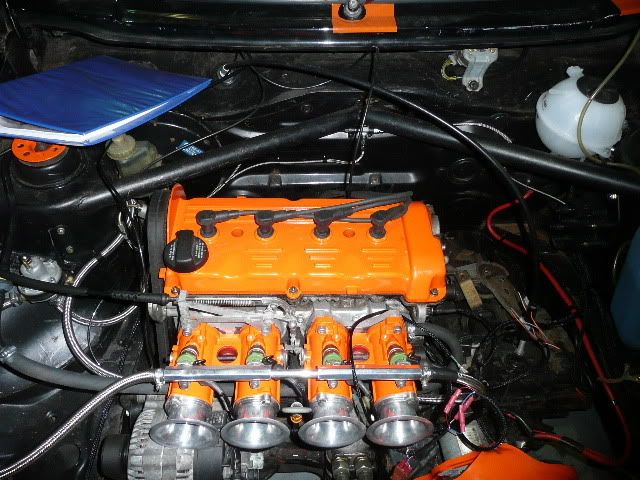

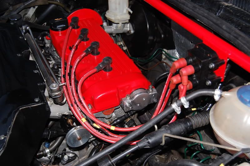

    Bill,
    How on earth do the Jenvey linkages fit?
    On this car:
    With DCOE type Jenveys, I can see how an upper mount bracket will bolt up, and the linkages fit and work, be it centre pull, cable from left, or left pull, cable from right.
    On Stu's car:
    ...with DTHs there is no room.
    The upper mount just won't fit.
    I know Stu is using a 1.8T fuel rail, but even with Jenveys own fuel Rails, there isn't room.
    And fitting a lower mount will hit the alternator surely?
    Your linkage seems by far the best solution - especially for DTHs.
    I just can't see how ANY Jenvey kit will fit without complete re-engineering of the mounting assembly.
    Which parts are you missing for your kit?
    I have a mate who could knock a few bits up cheap (lunchtime job...owes me a few favours etc), if the costs are too high to do it legitimately through you.
  11. badger5
    badger5 Club GTI Sponsor and Supporter Trader
    15
    nr Glos
    i need to stock take, it looks like H bracket (black bit in stu's picture) & the throttle cable mounting bracket, as i think i have a pulley left. trouble with these being low volumes its getting questionable to run a batch of the parts again. I have seen a car with these on and jenveys t'mech on there. surprised me to.
