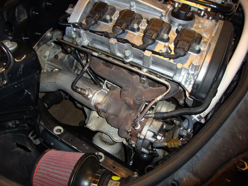

    Thread revival. Now that the Mk1 exhaust systems are ready for shipping we're going to have another look at this one.
    As mentioned previously, the transverse turbo setup points the flange/nozzle area at the steering boot and bulkhead. It is far from ideal so we're going to have to come up with a solution.
    I believe that the use of the longitudinal turbo setup could be an idea. I'm struggling to come up with any negatives about this approach. Has anyone done it already?
    I've linked this picture in from the 1.8t forum on the Vortex to show what I'm thinking (Thanks 1303 GTI :thumbup:) Imagine that mounted transversely in a Mk1

    We're trying to make some headway with the idea of the longitudinal setup. It just makes so much more sense.
    I'm trying to get a thread going on the MK1 owners club, but I'll do the same here if we can get people involved?
    I'm after some pictures to illustrate what I mean when I say that the transverse setup has shortfalls. I'm sure that I've seen some pictures of a car that's already running a longitudinal setup and from memory, it looked great!
    What I'm trying to avoid is producing a load of downpipes which will gather dust on the shelf because no one wants to accept that the current transverse setup isn't the best for the mk1.

    If you look the ko3 transverse setup in the Mk1 bay, there's just no room to do anything with the pipework. So, without moving something else to make room, there is always going to be a compromise.
