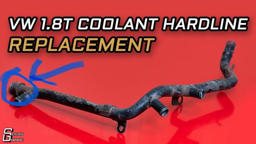

    Guys, quick question.
    I have a NOS metal coolant pipe for my AUM 1.8T engine that I’m currently rebuilding.
    Went to fit it to the block today, and noticed that the rubber seal is missing from the thermostat end.
    Does anyone know what the part number is for this ? I’m hoping I can still but this separate ?
    I’ve done some digging around, but I seem to getting a mixed response, as part numbers seem to vary on various forums.
    PFA.
    Cheers.

    oring seems to be 20x3 N90365302( superseded by WHT006407), and the pipe 06A121065AK.

    Phil, only one seal on these, as the other end fits into onto the heater matrix pipes. I was thinking to measure the old perished one from my spare corroded coolant pipe, but I just wanted to see if I could search a part number and get one off the shelf ( just to make things easier ;) ).
    David, that’s perfect, and thanks for confirming that part number. It was one of 3 I had written down, so will go with this one :thumbup:
