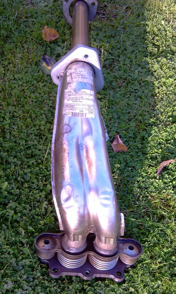

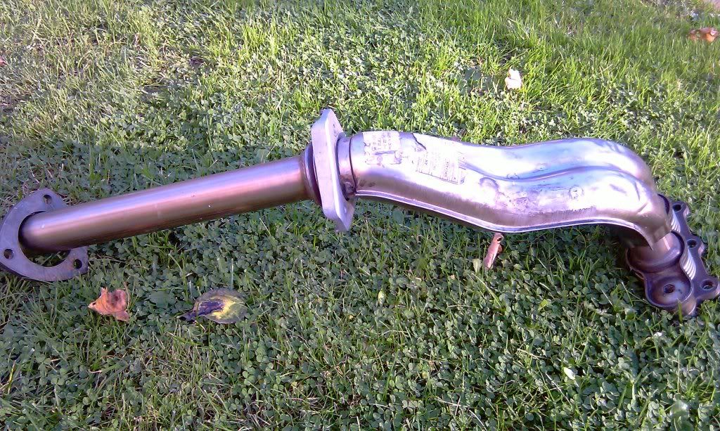

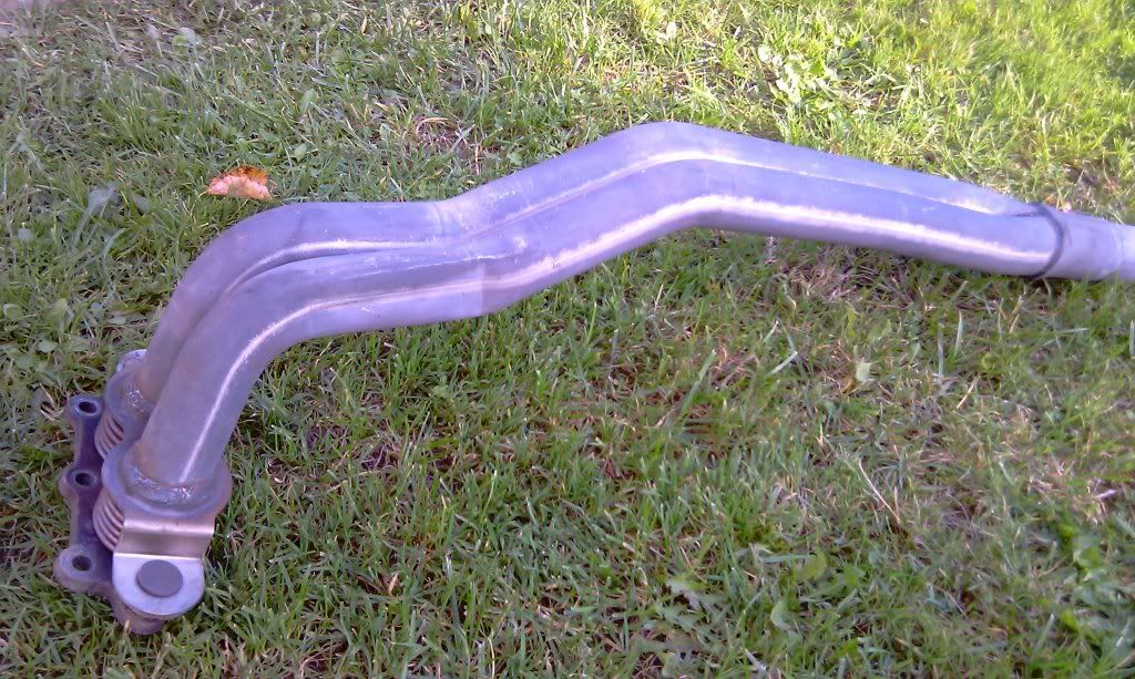

    I have a Mk3 VAG Downpipe that still has the sticker on it (ie almost new)and a CAT bypass tube to make it fit a Mk2. I never fitted it myself but was assured it fitted fine.
    I had a Bosal downpipe fitted to replace the one that was on it when i bought it, as it sounded like it was leaking. The Bosal one was absolutely terrible, sounded worse than ever. So I bought an Ernst one second hand and wrapped it twice with heat wrap. That totally cured it. If it hadn't have cured it I was going to try the Mk3 downpipe setup. Side by side the contours of the Mk and Mk3 pipes were identical, looed like it fitted fine.

    Mk2 downpipe and Mk3 downpipe and cat bypass.
    .[​IMG][​IMG][​IMG]

    Thanks for the photos too - very helpful :thumbup:
