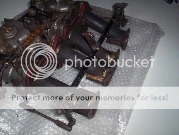

No one else? Well they arrived this morning http://dcoe.net/gallery/Parts/dscf0292.jpg http://dcoe.net/gallery/Parts/dscf0291.jpg
well i'll be on carbs soon, the engine transplant starts tonight with any luck! i got my trumpets on the way, just gotta get some carbs now !! do you think they are long enuf? Edited by: AxlFoley
I've got my carbs ready to go on in the next couple of weeks, just have to work out how to make them fit with the custom inlet manifold. And I'm waiting for my shorter trumpets velly
