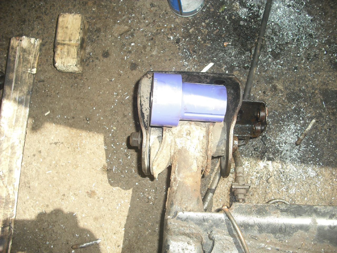

Dragging my original post up from the past, but i'm finally doing this job! However, I'm stuck: I've removed the original bush and was about to remove the metal sleeve it was attached to. But the new bush doesn't fit, it's way too small! Have I got the wrong bushes again? They're meant to be for a mk3 non-plus rear axle. i assume the ones I have are still wrong? Sorry if the pics are a bit large: If anyone can help it'd be most appreciated, I'm stuck in the middle of this job now with no going back! Cheers, James
well, technically you should have the correct ones...they look like mk2 ones to me (which should be the same as mk3 4 studs) however, i'm sure i remember chrisP saying that its actually pot luck with mk3 4 studs....some have mk2 bushes, some have mk3 5 stud style ones. i'd say you need the plus axle ones.
Sorry, I'm confused - this IS a MK2 that you're fitting bushes to, right? Just had a horrible thought that I had got it all wrong.... :s If you desperately require MK2 bushes today then I do have a set of both brand new original bushes and some brand new poly bushes right here, but I'm in Oxfordshire. Edit: Yep, think I got it wrong all along. This is for a MK3 chassis isn't it.
Jim, the new bushes replace the metal sleeve. You uneed to remove it completely. The Powerflex bushes are NOT inserts. Edit. Just realised. damn, the bush is too small to even fit inside the sleeve? Thats a bit of a bugger. I thought the only difference between the Mk2-3 and Mk3 bushes was the width though?
AndrewF: That's what I thought! When I first received the bush kit from Venom, I had been sent the plus-axle 5-stud only bushes, which I sent back because I thought they were wrong. Like you said, technically I was right and the new p/flex bushes I have state they are for mk2/mk3 non-plus axle 4 stud vehicles. Trev16v: Yes, sorry, it is for a Vento/mk3. But I was always under the impression that 4-stud mk3's had mk2 style beams? Do you have any mk3 bushes then?! Deako: Yeh, i thought the same. I was just about to bash out the sleeve when I realised that it looked a bit big. Offered the new bush up to find they were too small. I'm so confused. And annoyed! I guess I'll have to phone Venom tommorrow and ask them to send me the correct bushes - mk3 5 stud plus axle. Until then I have no car again and very little spare time
right, there is a reason that powerflex list the bushes as MK2/3 and that is that on later MK3's (I'm talking 4 stud here) they changed the beam bush type to the larger one, so what you need is that large bush kit, normally described as for a 5 stud car. There is no ryhme or reason, but from what I have found doing these is that the later cars, P and R reg, they have the large bushes instead of small ones
I suppose the problem also is, that someone could have bent the rear beam at some stage, and got a replacement from a later spec / alternative mk3 with the different rear axle.
Dont worry about it being plus axle or not, as the axles on 4 stud are actually wider believe it or not. Beleive you me, I have seen enough of the damn things and measured them to know
There must be a powerflex dealer somewhere near you? Doesnt have to be VW related, but may help if you want them asap
fair play! i phoned venom and have sent the bushes back today foir a straight swap. expecting the new bushes on wednesday. i'm now at the stage of slipping the new bushes in and hanging the beam back up - the metal sleeves of the bushes beat me yesterday but i came back at them with avengence, more patience, a sharp coarse hacksaw blade, a hammer, big chissle and a large flat head screwdriver. did the job nicely just gotta sit back and wait now...
