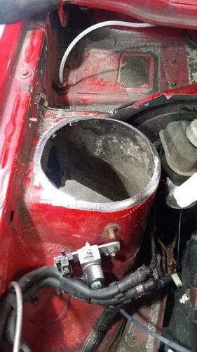

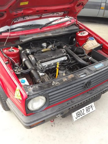

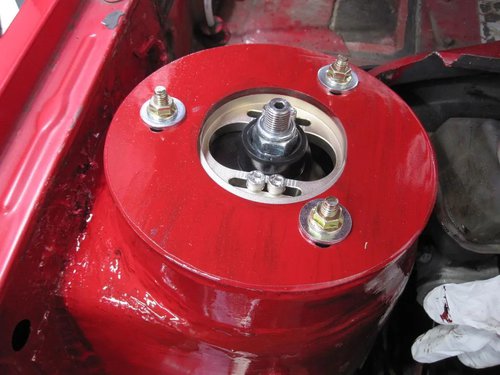

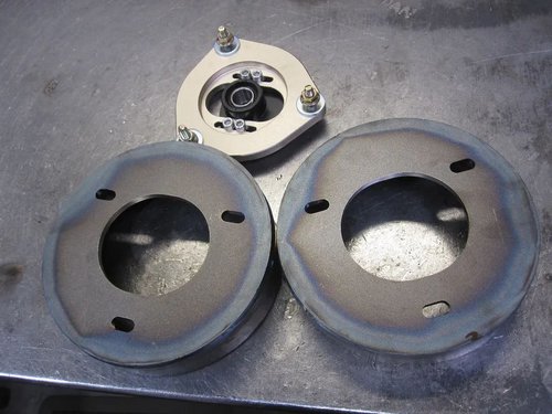

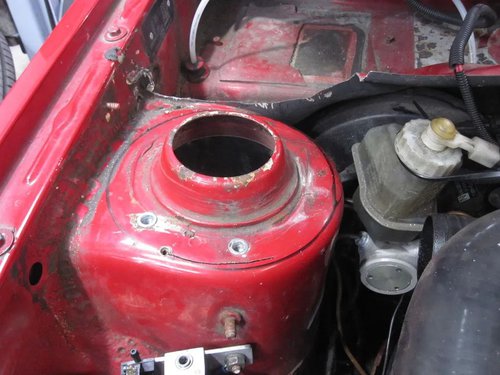

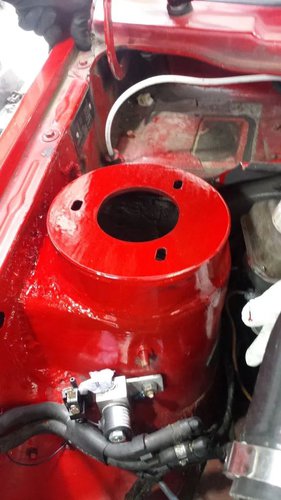

    Just thought I would share this with everyone on here.

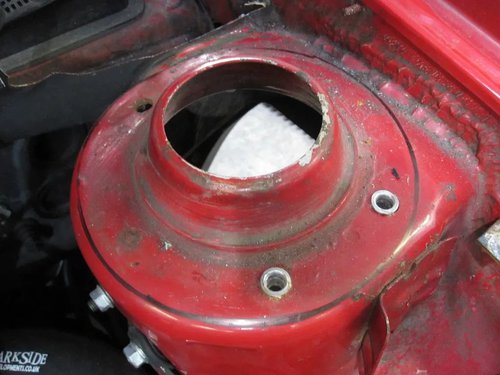

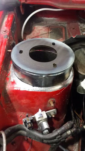

    Last week I had the front turrets raised by 40mm with MK5 Golf camber adjustable top mounts, I had the top plate bolt holes elongated to allow caster adjustment too.
    After doing this the wish bones now sit level even with a decent drop in ride height so should hopefully make a big difference to handling. I'm taking it to Croft next month so I'll soon find out. :)
    20170421_103448_zpsounflxto.jpg 20170421_103501_zpsifxgbpi9.jpg 20170421_115936_zpsjlehp32g.jpg
    1 slight issue is that I had to raise the bonnet to clear the new turrets but this isn't an issue as it's for my track car, Iv'e had a few people on Facebook ask about these so I'm getting them priced up but in 30mm which should be ok for a standard road car.

    Liking the raised turrets:thumbup: but that doesn`t affect the wishbone angle at all. [:s]
    It helps position the damper in it`s travel better though :)
    Can't you just cut away part of the bonnet inner skin to give you more clearance?

    The welding looks top notch and very neat.....not a pigeon in site. Always nice to see a bit of home brew that would be at home on a competition car and that a scrutineer would look at and be happy with.....Very neat fabrication Mayor. :thumbup:

    Loving how you made the TDI powerplant look at home in there too!

    Why did you heighten them by 40 mm? And how did you measure the lot, so the camberplates are mounted straight, orientated/ rotated straight or at least mirrored between left and right?
    The plates with the slotted holes, did you have them drawn and machine milled?
