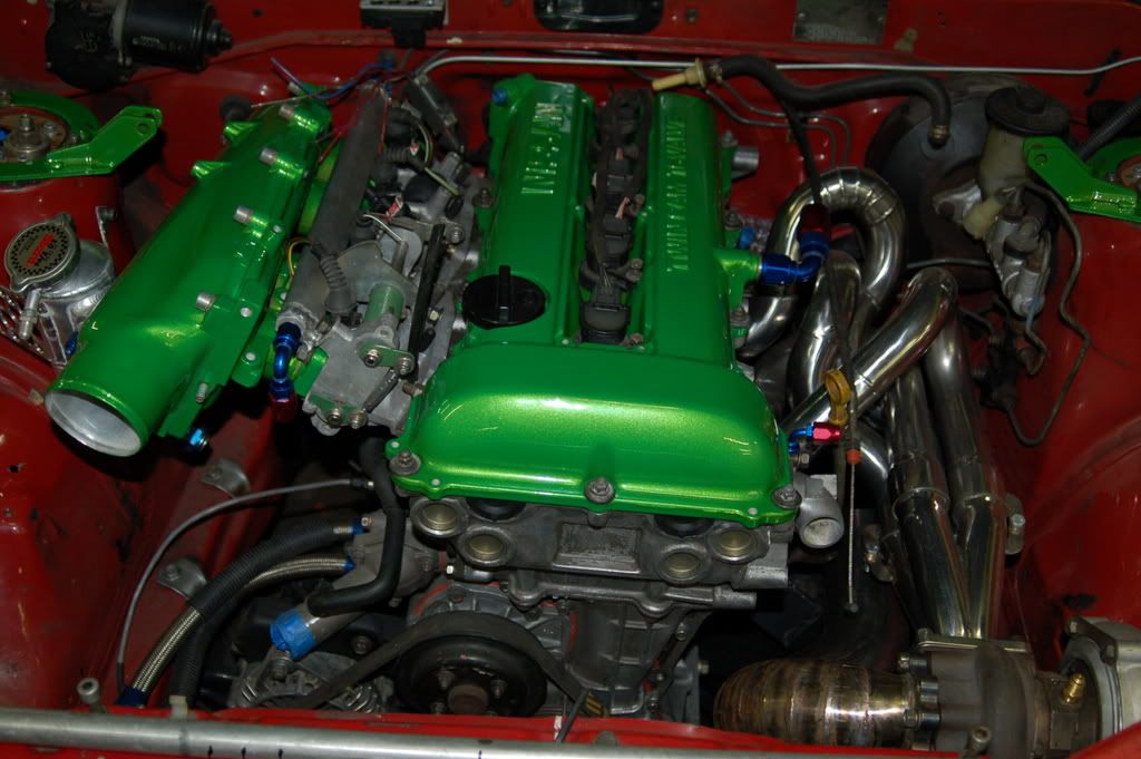

    If you want ITB & Turbo combinations, check out some Nissan Pulsar forums- came with this set-up as standard, and there's plenty of them with large power.
    Chris- What's the thinking behind injector spray pattern suffering?

    God the yanks are demented: http://zilvia.net/f/tech-talk/112321-pulsar-gti-r-itbs-sr20det.html
    Cheers for the info though, i'll keep digging...

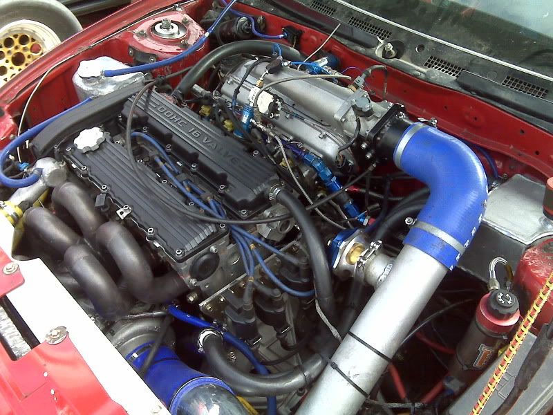

    Andy Nichols runs itb-s on his turbo rover, i'm sure i have some pics from a race day this year at the pod, il dig them out tmrw
  15. sambo Paid Member Paid Member
    Jan 12, 2004
    441
    Come to think of it, looks very much like this set up
  16. sambo Paid Member Paid Member
    Jan 12, 2004
    441
    Here is a pic i had in mind
