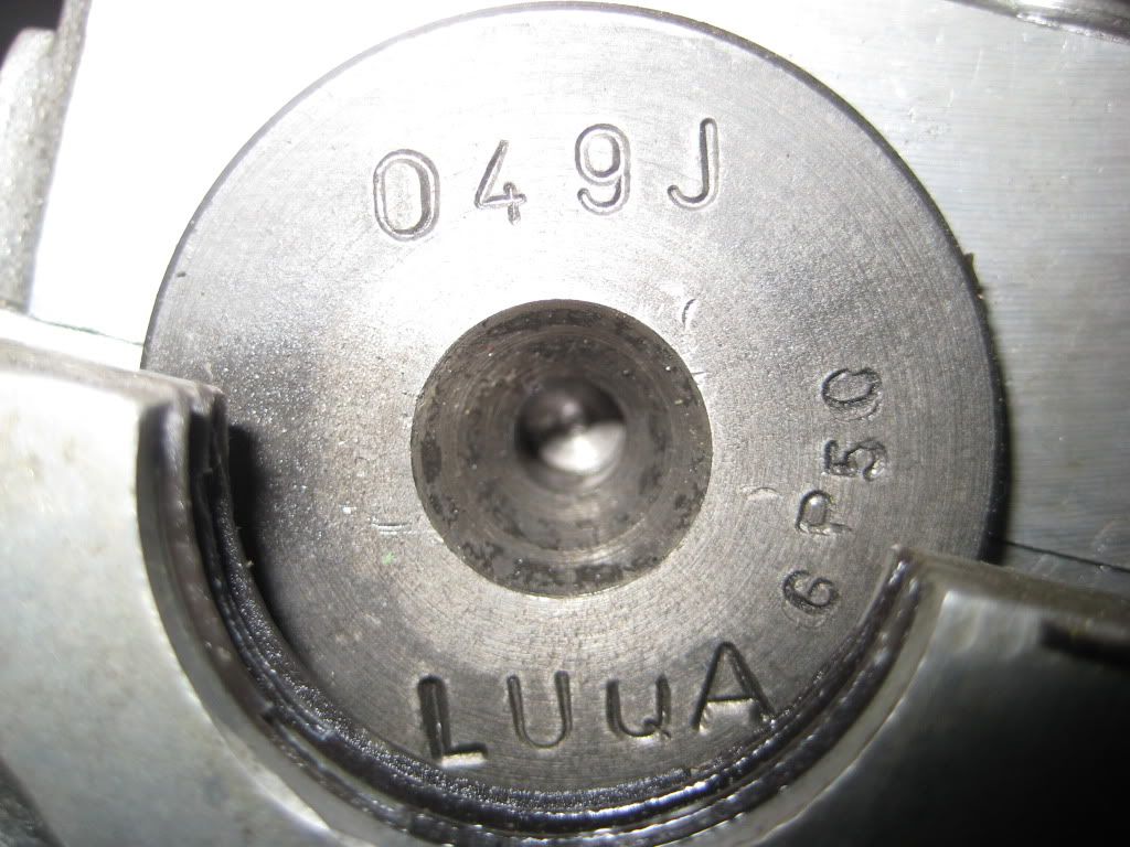

    Jul 3, 2007
    Hi
    does anyone recognise these camshaft markings on 8v
    Thanks
  20. Razzer Forum Member
    Jul 3, 2007
    sorted
    Thankyou
