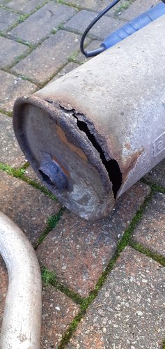

    Thursday morning went to work in the polo, started it up, thought it was a bit louder than normal.
    I only work less than 3 miles from home and on the way it got even louder, back box had split.
    Went online and found euro car parts had one for the 1.2 in stock, and were open until 6, so £31.89 and a short drive to Halifax rewarded me with a replacement and the old one came away from the pipe on the way there, making it easier to remove anyway.

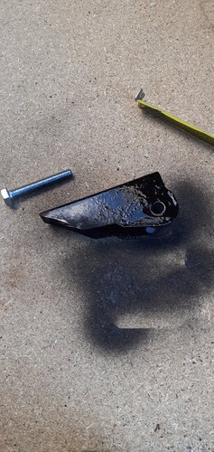

    This afternoon I got the car up on stands and attacked it with the grinder to get U bolt off and relieve the remaining pipe. The new box was about 5 inches longer than the old one, didn't think much of it until went to put the mount on, obviously was in wrong place, so unbolted the bracket, chopped in half, redrilled the holes and then reversed it and it all lines up.
