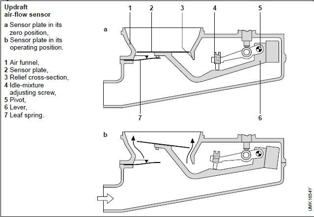

    Pressing on the idle mixture adjustment screw will move the airflow meter plate, and lean out the mixture briefly, causing the problem you describe:
    Just try to be as gentle as you can, and make a small adjustment each time. Try 1/4 turns at a time, and make note, as then you can always return to where you started if it runs worse. Remember to remove the tool after each small adjustment, and give the throttle a small blip to settle the pivot into position. If you haven't access to an idle CO meter, you're aiming for a good smooth idle, without misses. Idle speed would then be adjusted back down using the idle screw on the throttle body (on an 8v, sorry not sure how your idle is governed).
