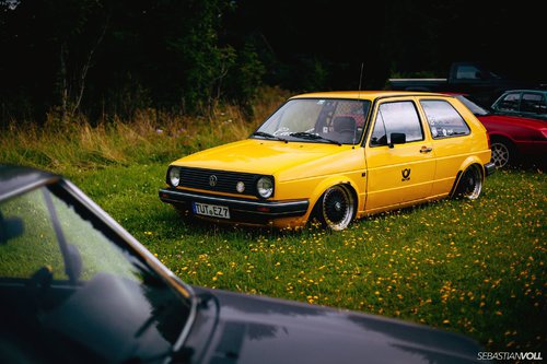

    Finally finished rebuilding my BBS RMs and fitting them at the weekend.
    Barrels have been powder coated chrome, new aluminium lips 1.5” front and 2” rear, new polished bolts, new genuine BBS valves, centres cleaned up and sealed with black RTV. Applied some Poorboys sealant and hopefully that's it for now...
    Photos don’t do them justice really, they look stunning in the flesh

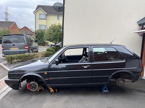

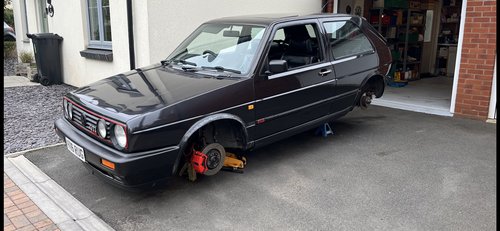

    Last year I got hold of some G60 calipers and carriers and had Bigg Red rebuild and powder coat them. Sort of forgot about them over the winter but came across them in their box a few weeks back so ordered some EBC discs and red stuff pads and some red HEL lines.
    This was the last job I can remember where everything went as it should! No seized or snapped bolts etc. Took less than 1 hour each side! Bled the brakes with some fresh fluid and went for spin. The pads bedding in quick and I am very impressed with the stopping power.
    Plus they look great!

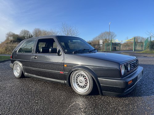

    May as well add some details of the winter update on the mk2…
    In truth the last couple of years I’ve been spending most of my time and money on my Transporter. Full camper conversion now but my main obsession is the air suspension done in January 23 which is so much fun! I came across Lowdown Transporters a few years back and I’m now addicted to getting the van as low as possible. It’s had just about everything done for maximum lows, subframe and engine raise, major arch cutting, chassis legs notched, strut dropped through hub, ECU raised etc etc
    So last year I decided I wanted to install air suspension on the mk2. Only problem is that it’s expensive! So I kept an eye on ebay and marketplace and eventually found someone selling the exact kit I wanted – Airlift Slam Series for mk2/mk3 platform as a kit with 3P in as new condition. I was camping in Belgium at the time so convinced the Mrs we should go back to Bristol via Essex!
    That was August, so I thought the air install would be a nice winter project!

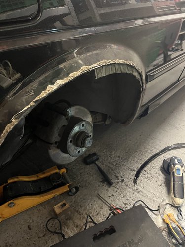

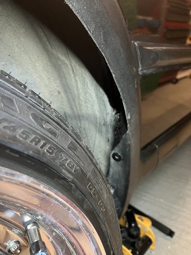

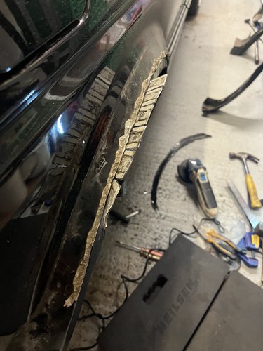

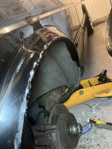

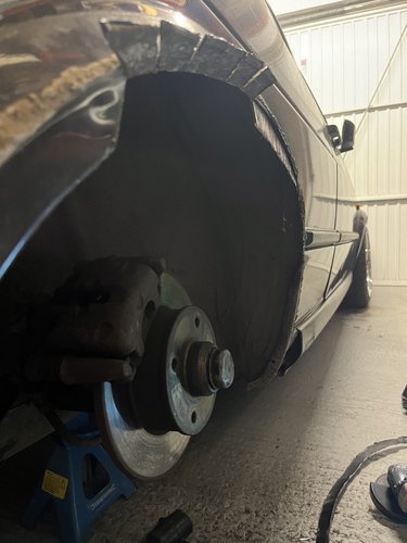

    Installing the struts is obviously pretty basic and I then started on the arch cutting and rolling. Plastic arches needed to come off and be cut flush for clearance. Front wings are single skin so just mark up and chop and protect.
    Rears are double skin, so chopped out the outter skin and then bent up the inner bit by bit, trimmed up, protect, seal etc
    So all cutting done, struts installed and airlines ran into boot. All wiring done.
    Car now useable and driving.
    to be continued...

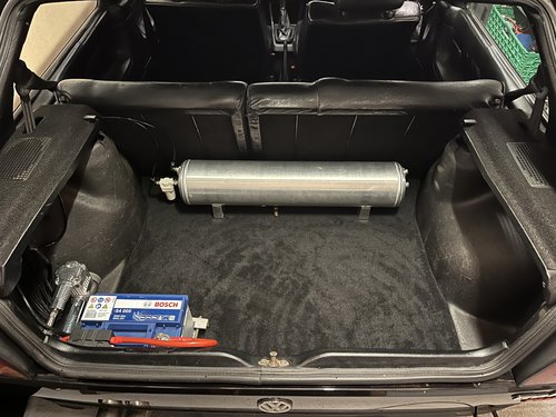

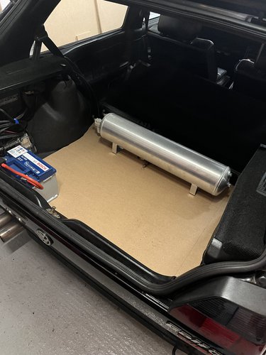

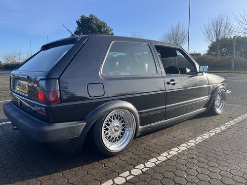

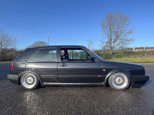

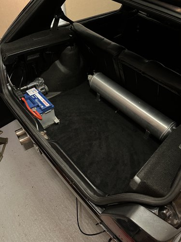

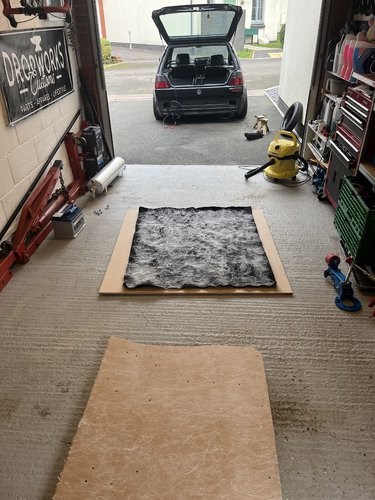

    The boot was a mess of wires and air lines etc, so I thought I’d build a false floor and carpet it etc. Tank mounted to floor, compressor and management to the side. Pleased with the results...
    At this point the car was done and the air suspension working. Now time to chase more lows (I feel this will be ongoing as I am addicted!). First thought which is standard procedure on a Transporter is to fit thinner top mounts but I couldn’t find any for the rear of a mk2. So I just bought a new pair and used an angle grinder to remove the excess rubber at the top, maybe 10mm. Happy with that for now.
    There isn’t too much info online about getting a mk2 much lower. Some have flipped the track rod ends as the rod fouls the chassis leg. So I put my car on ramps and aired out, the rods just about rest on the leg so I will be doing a flip. Only issue here is that the hole in the hub is tapered so it needs drilling out. Found a company called Noath Engineering that sell quality bits for mk1/mk2 Golfs. Bought the inserts for the hub (once drilling out) and also purchased ball joint extensions, however I have not really looked at this, not sure if it is needed yet.
    Currently half way through changing the track rods as the ends are seized up so I had to use an angle grinder to cut them off! And my drill doesn’t want to drill out the hub, think I need to remove them and have them machined out. If I do this I will get the hubs powder coated and put some new wheel bearing in. Lower arms and arb are rusty too so I need to do a proper refresh of the front suspension, maybe even fit the balljoint extensions if it gains me anything.
    Drivers side chassis leg will need a notch at some point. This is definitely needed with standard 8v or 16v as the gearbox is higher as standard so the offside driveshaft fouls before the strut can fully air out. With the 20v engine sitting lower it just touches, so will prevent more lows in future. Especially if the engine and subframe can be raised, we’ll see! Not the case on nearside as the shaft is short as its closer to the gearbox
    So as it is now...
    So that’s where I am at the moment. I do not drive it low (unlike my T5) so it rides very well, I still feel convident in the corners anyway!
    Going to be using it daily for the next 2 weeks which will be a good shakedown
    More updates to follow, inevitably…

    Getting a MK2 lower is pretty straighforward. In the back the axle will foul the chassis at the point where the axle goes into the wheel housing.
    In the front there are the track rods as you already mentioned plus the drive shafts will hit the frame at some point. Mapco Special Parts offers thinner drive shafts for your driver side which will have more clearance. Normally that is enough to lay the floor on the ground. They are also shorter which your drive shaft joints will thank you.
    Depending on how the 20VT is installed, the oil pan should not be the lowest point. If it is, you can mount a 2-piece USDM oil pan which is about 15mm shorter.
    Maybe you will have to run the thinner font lip since the wide one is already touching the ground.
