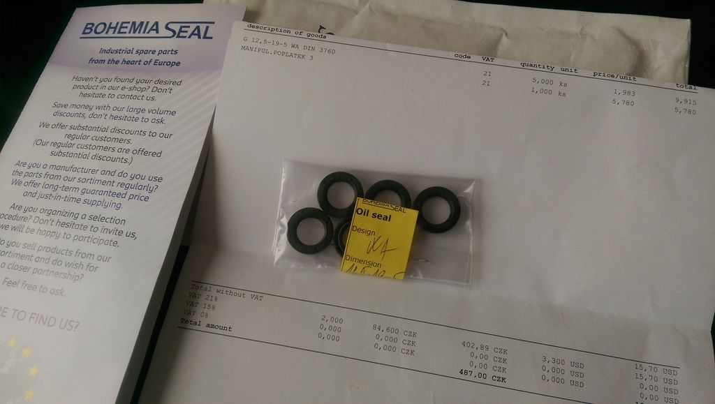

    Someone was asking me for one a short while back
    I'll pm you

    They arrived quite quickly. Nice little job to do this weekend!
