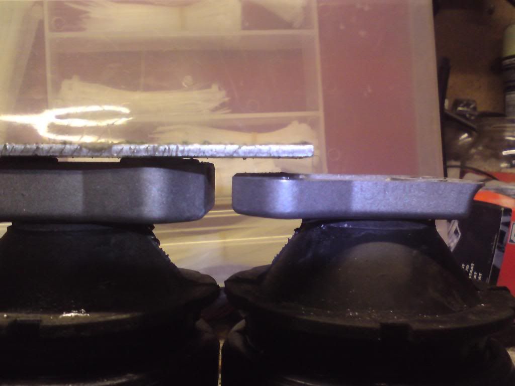

    16v ABF in a mk2 has some isues with the throttle body/cable hitting. Different frame work in that area would be a bonus. Ive shaved my engine mount to help this.

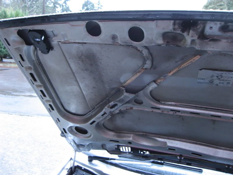

    I went out in the rain to take a pic for you, the front frame of my bonnet has a small section removed to make room for my ITB air filter. Also had to remove material left and right front frame for bonnet pins - I imagine most would have to do this on a composite as they will be running pins to stop flex/track damage etc.

    Hi smudge, thanks for going out in the rain.
    You're quite right, some people are going to fit catches/pins but we're hoping that ours won't need them. We'll probably adapt and strengthen things around where you've fitted yours. Not sure about your filter clearance yet but it's on the list.
    Thanks for the pics :thumbup:

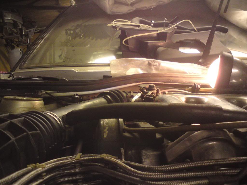

    I'll be fu..... didnt know that! Bare in mind im using kjet so have the throttle linkage on top.

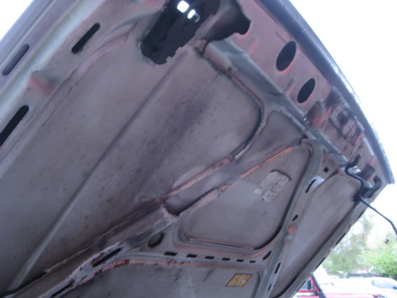

    You can sort of see the 'hacked' out section near the back edge of the bonnet in this photo. Although it's not very neat, it certainly serves it's purpose well and prevents any gross fouling of bonnet skin on TB/intake pipe/strut brace etc.
    Will try and get a better picture for you in the next day or so....

    Hi Barny, thanks for those.
    I did wonder how we would work out the depth needed but your pics have cleared that one up.

    I can see roughly what they've done but you're right, a clearer photo would be better.
    Thanks for your efforts though :thumbup:

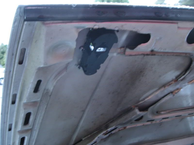

    Finally got round to it....here you go :thumbup: Bit of a bodge by the previous owner but serves its purpose ha!!

    Fantastic. I know it can be a hassle doing stuff like this so it's really appreciated :thumbup:
