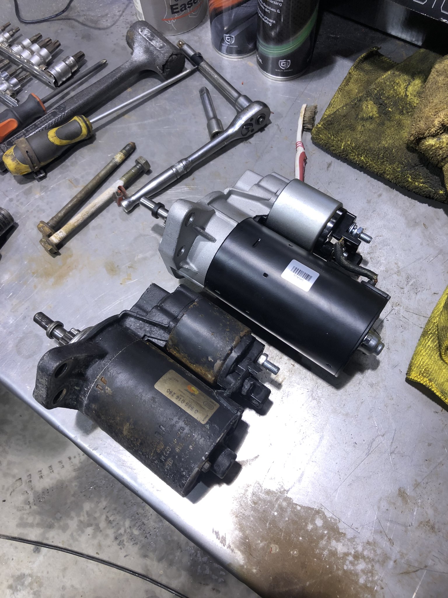

  20. Mk2daz
    Jun 2, 2015
    Well fitted the mk3 1.9 diesel unit tonight, its a fair bit bigger than the 8v petrol starter!
    It spins the engine up a lot quicker and sounds totally different
    Gave the car a good thrash around till the engine was nice and hot, then was able to start the car up about 10 times in a row hassle free.
    Fingers crossed...!
