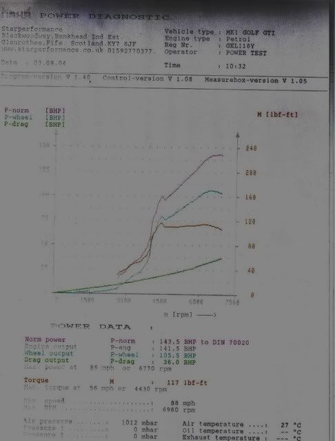

    My `old` 1800 produced 140bhp with:
    Solid lifter TSR Pack D head - 40mm in. / 35mm ex.
    285` cam
    Kjet plus KStar (KS301)

  6. Tristan
    interesting graph.... wonder what caused the Spike at 4400?

    105 whp is 140bhp? 33.3%? isn't that a generous figure for 2wd
  8. Jon Olds Forum Junkie
    seems 'cammy' for a 285. What was the O2 doing?

    Not sure ... the KStar altering the fueling perhaps ?
    Hopefully ... :)
    TSR 103 cam ~ 11mm lift, O2 not measured AFAIK
  17. Jon Olds Forum Junkie
    lambda
    If the mixture was doing something stange as it came on cam it may exacerbate the curve shape.
  18. jamesa Forum Junkie
    Nov 8, 2003
    301
    Abz
    No lambda fitted.
    The KStar uses it`s own injector .. connected to the WUR to reduce the fuel pressure in accordance with the ignition curve (vac. connection at dizzy is blanked off). Vac. connection runs to the KStar module.
