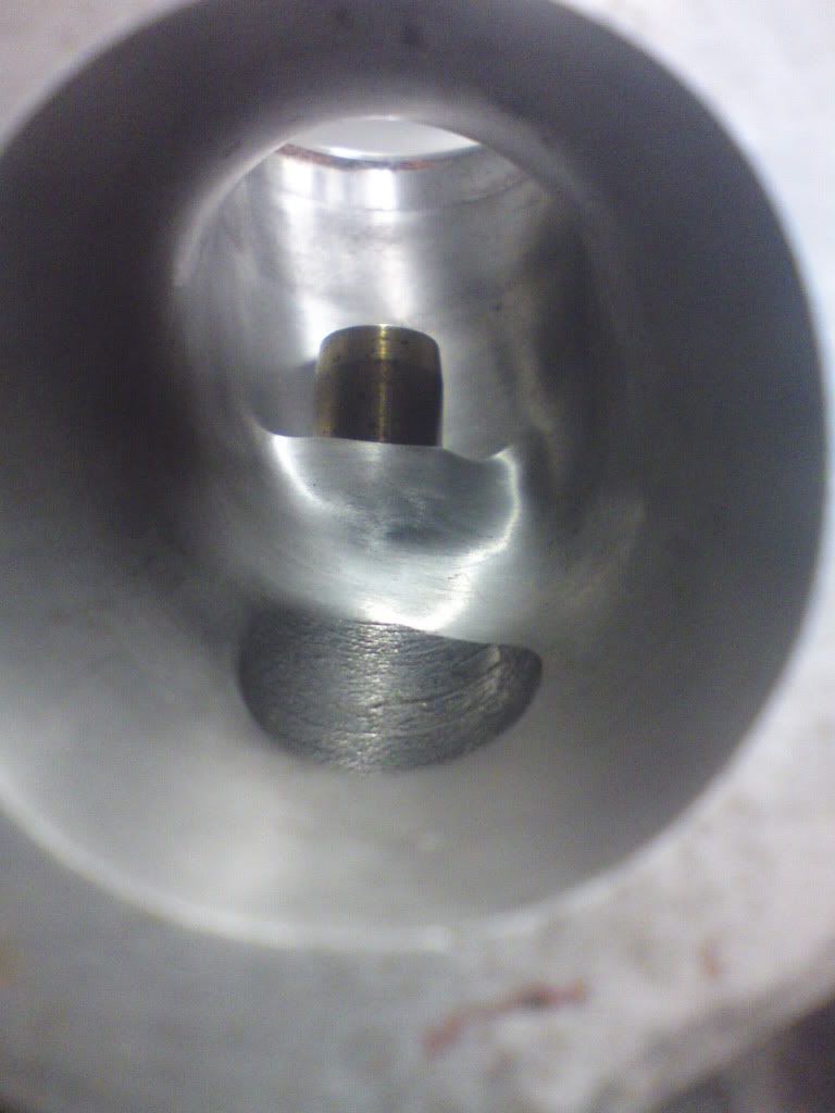

    hi there loveing the thread top work might i just add that porting is RELLY BOREING as i have found out this week might be because i have been polishing 12 wheels for weeks[xx(]
    but yer my qustion is why is it not a good idear to grind the floor of the port ? as i have ground about 1 or 2mm off mine is this bad ?

    It's because you need to keep the short side turn as smooth as possible... if you remove material (or too much... sometimes you have to depending on the application) from the port floor the air will have a sharper turn to make when it goes around the short side.
    It can be tedious, especially after you've done the first one then realise there's 7 more ports to do!

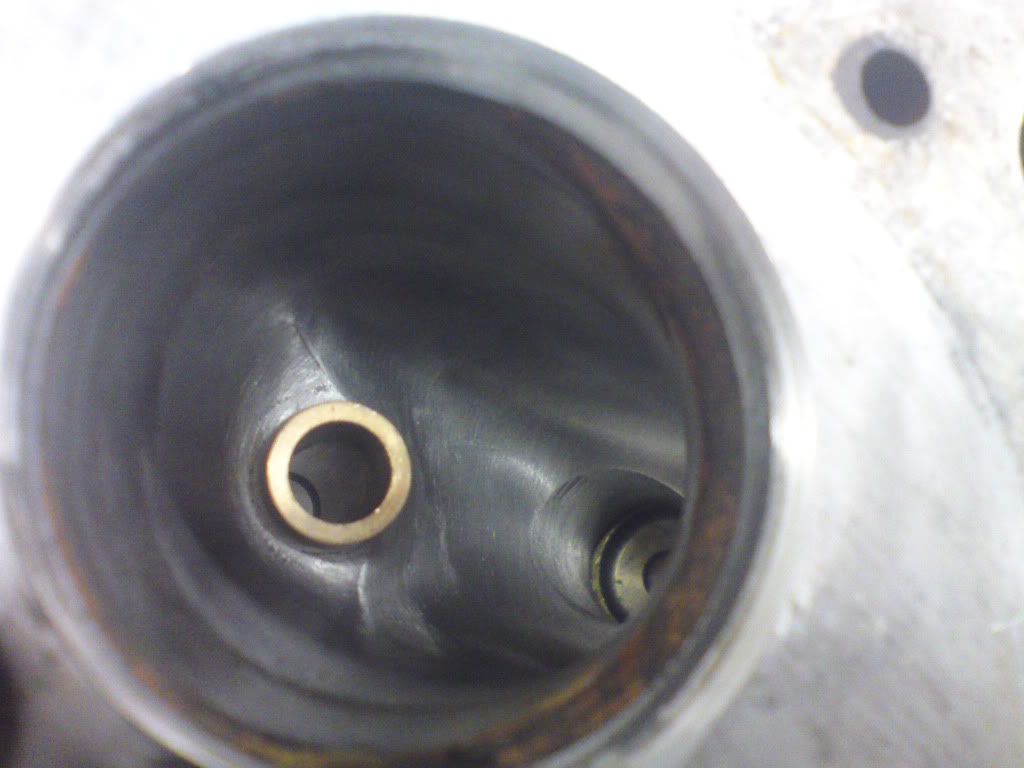

    I started poorting now this weekend. Its a hard job i have 3 inlet ports done! now one to go en the exhaust ports. Some tips to get it realy smooth i have a lot of bumps. Grind them away? hard job i think, its al about practice to(my first time)

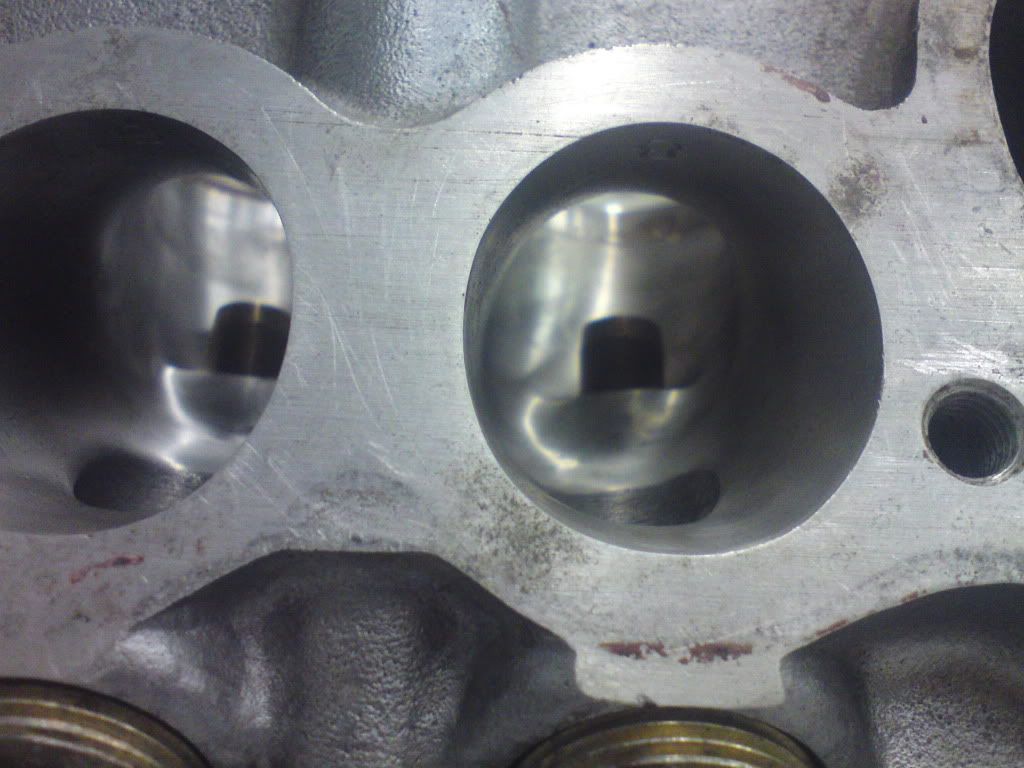

    Open the inlet ports to 31mm, the venturi below the valve seat to 34mm, taper the port walls down from below the venturi to the roof.
    Have an old valve turned down to 30mm, rough out the ports so the valve fits down them... most of the material will need to come from the sides of the ports, a little from the roof, "none" from the floor.
    Use a 60 grit flap wheel to smooth over the rough ground ports. If you havnt been too agressive with the roughing out stage it wont take much to smooth over... this opperation will take out the last 1mm to make the port 31mm.
    The key is the throat/valve seat area... opening the ports without the seat work wont achieve much, apart from boredum with poting heads!
    Yep, not as easy as it looks!
    Once you've done the above be very carefull with the short side (floor) turn... follow the guide here for this... or shout up here.
    If you hav'nt already, have the valve guides removed by a machine shop... I wouldnt recommend doing it youself for the 1st time.
    With the 33mm exhaust valve... open the throat to 28mm, then taper out to 31mm into the main port.
