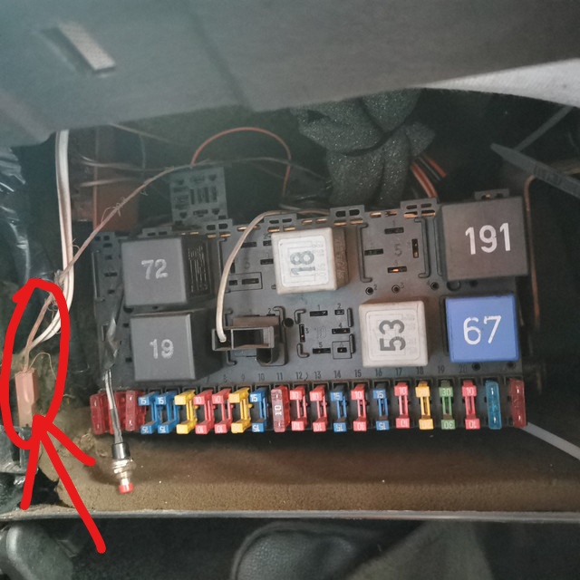

    Yea i forgot to mention that i have all the same problem as written here no oil pressure, oil temperature, tacho and mfa. But yesterday it worked for 20minutes and again nothing of that works.

    Which one is relay for mfa or do you mean small relay on motometer? And does anyone knows what is this damaged "burned" wire?

    if the warning lights dont work either then its more likely to be a wiring fault then. wiggle fuse 16 in its socket, make sure its not blown. the sockety might be loose or dirty. the burnt brown wire is an earth for something, chase it to source. also your grey/white jumper in the front of the fusebox is in the wrong place, it should be in slot 10. this is for your rear fogs

    Yea it is a fuse 16, when i wiggled it started to work.
    Now i will watch how long it will work and know where to dig if it doesnt work again.
    Big thanks @rubjonny ! [:D]
