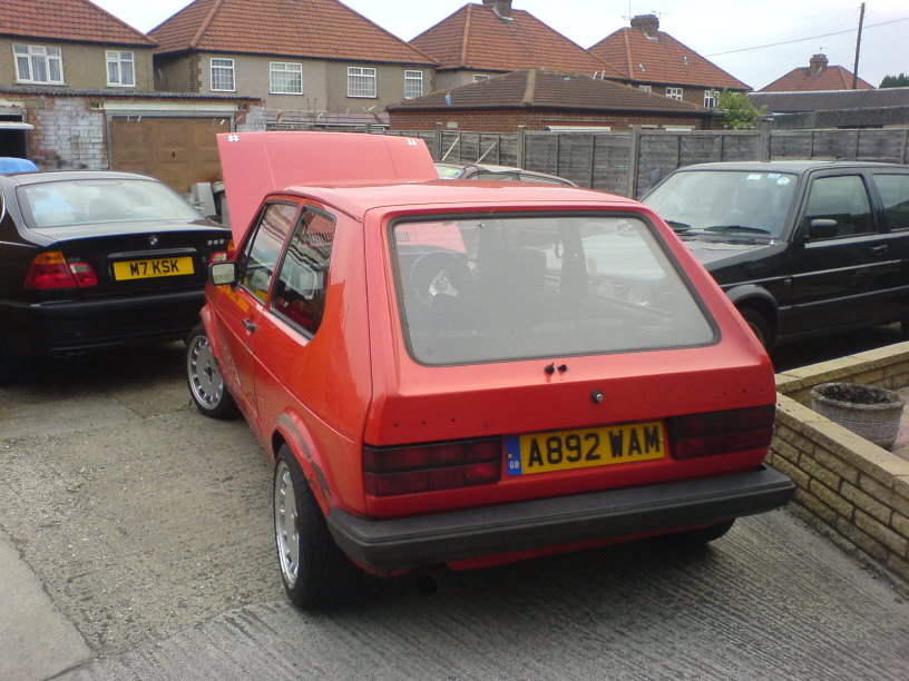

    Here is the car before hibernation:

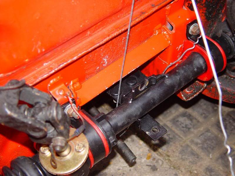

    Strengthened steering mounting. Note the L-beam welded in between the mounts:

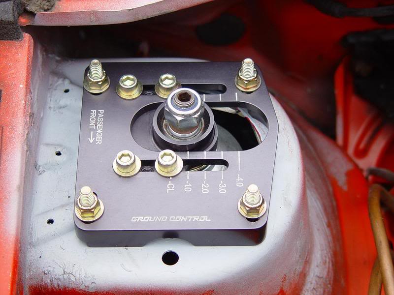

    GC top mounts in place. These require the raised edge on the top of the strut towers to be removed:

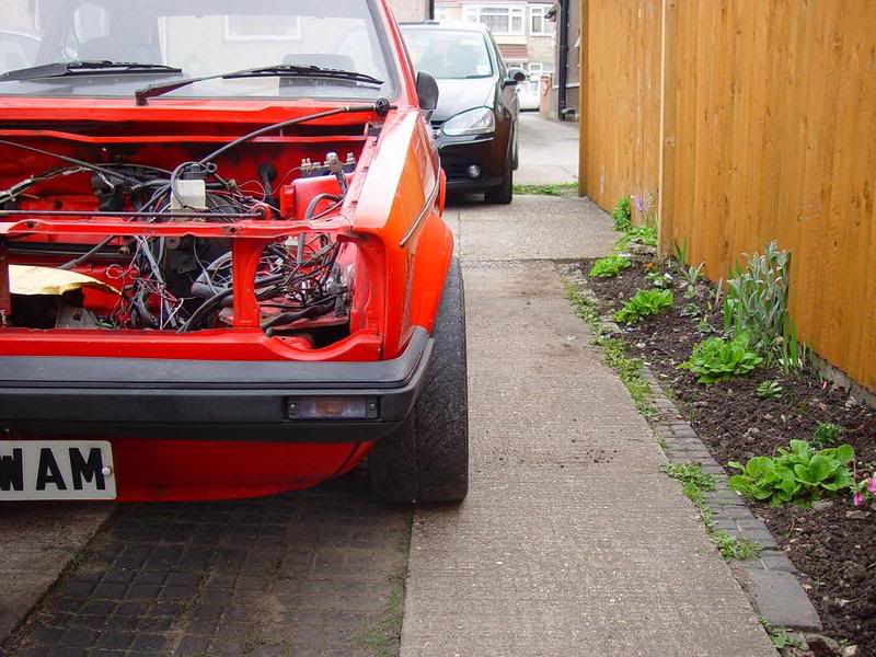

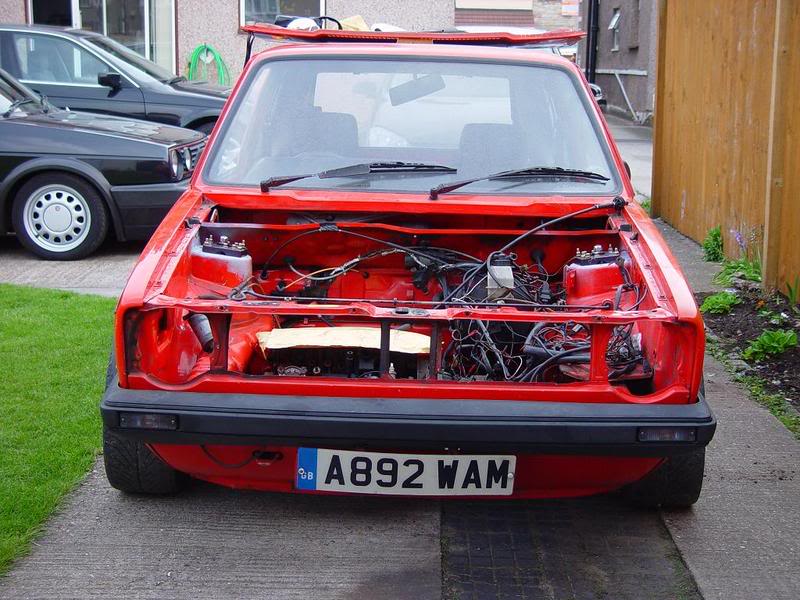

    Work in progress:

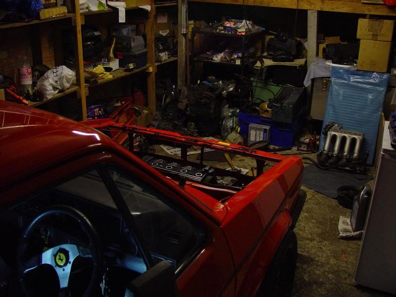

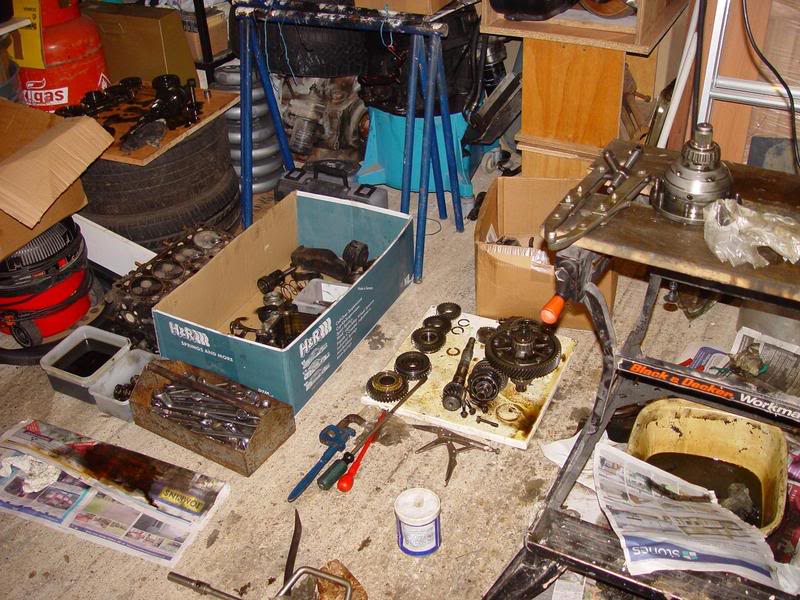

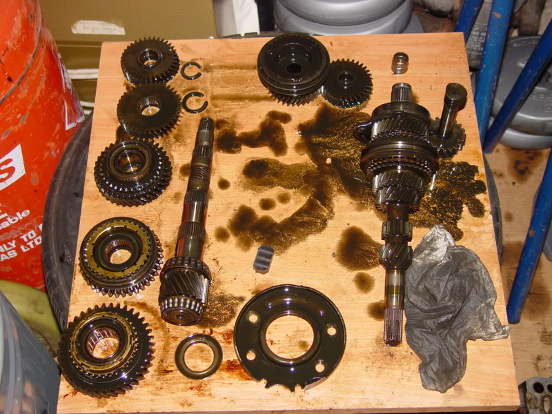

    Gearbox bits everywhere:

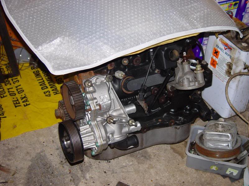

    ABF waiting transplant:

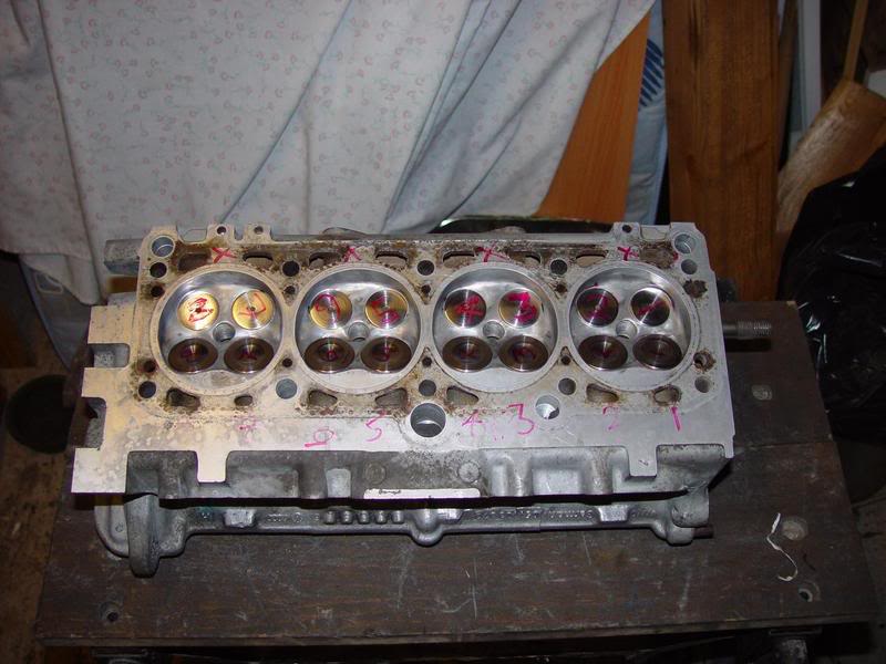

    Headwork in progress:

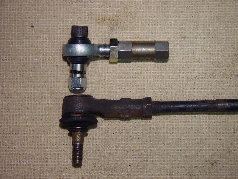

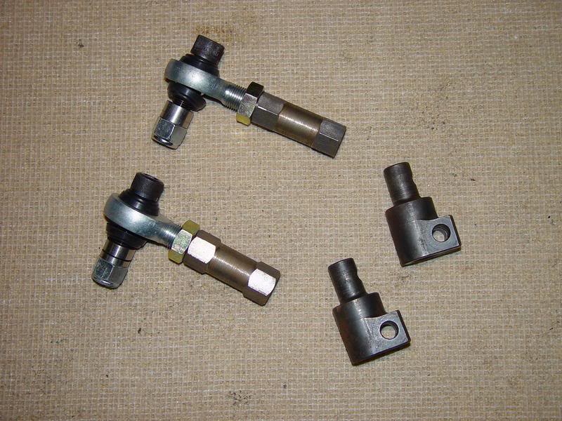

    Compbrake rod ends and ball joint extenders (not fitted yet). The rod ends are longer than mk1 stuff but require the taper to be drilled out of the hub carriers.

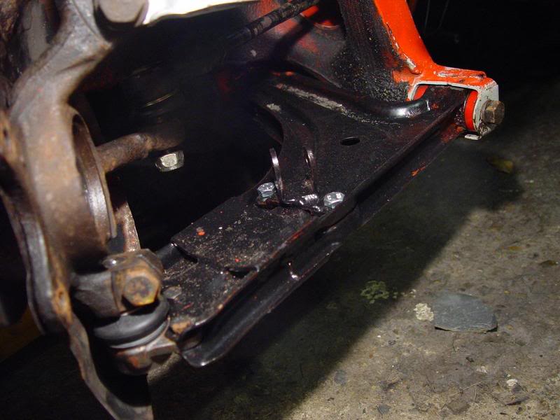

    Widened wishbones with ARB brackets in place:

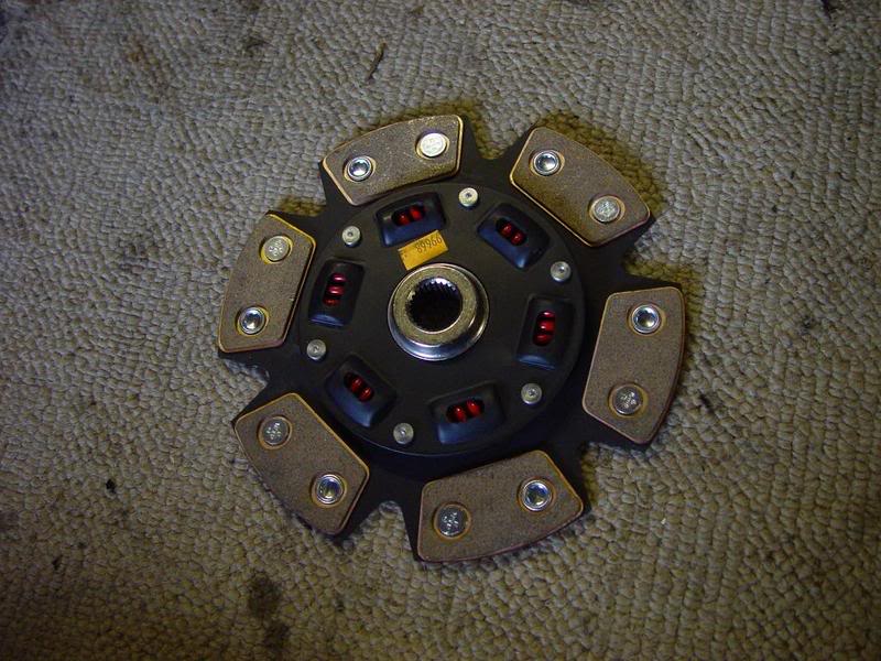

    6 Paddle ceramic clutch disc from Bildon Racing:

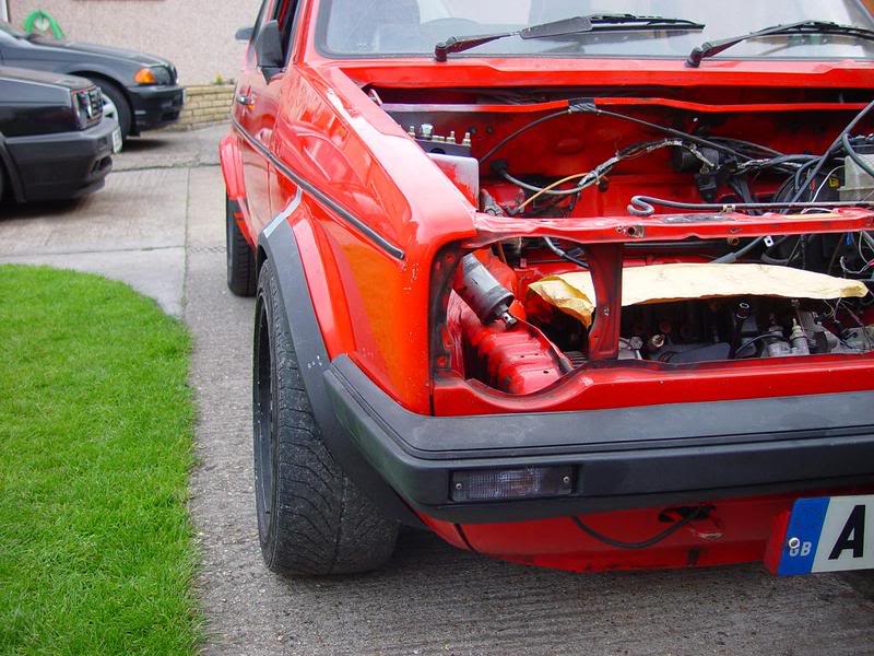

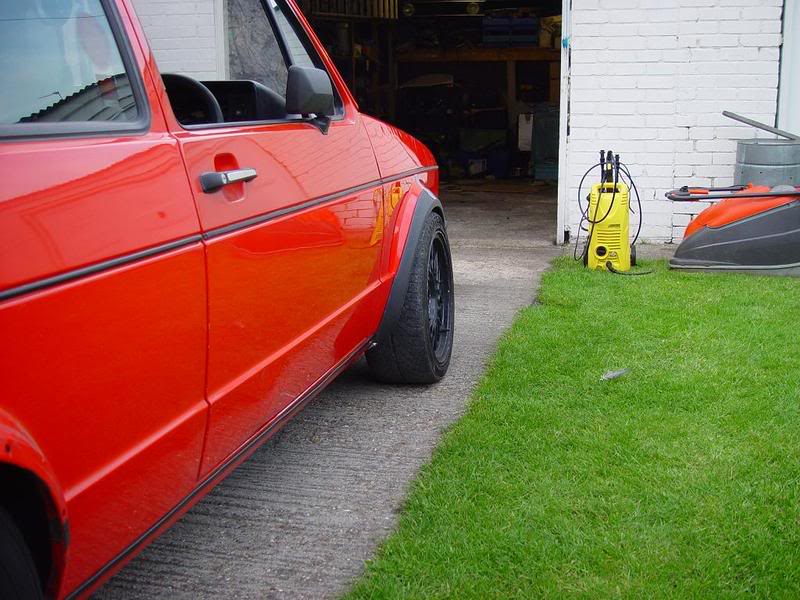

    Stance anyone?

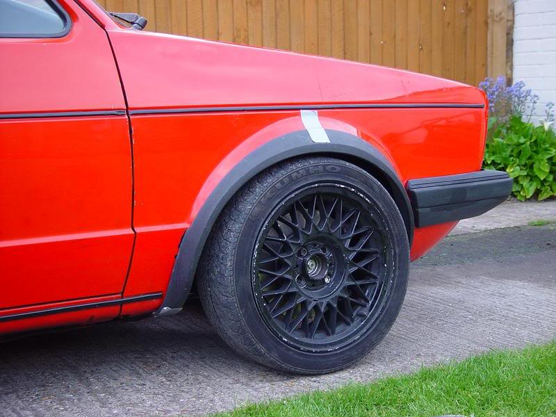

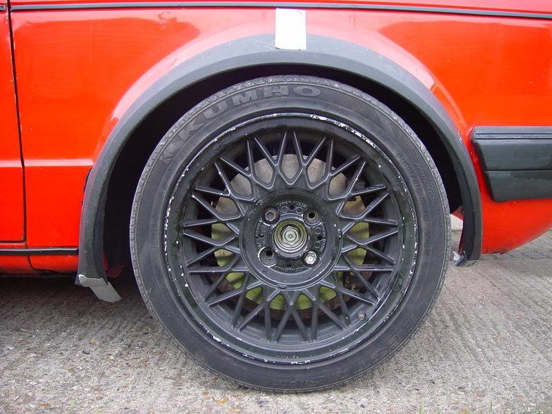

    BMW BBS alloys just fit. [:s]. 7x15 et 24 fitted with 195-45-15's:

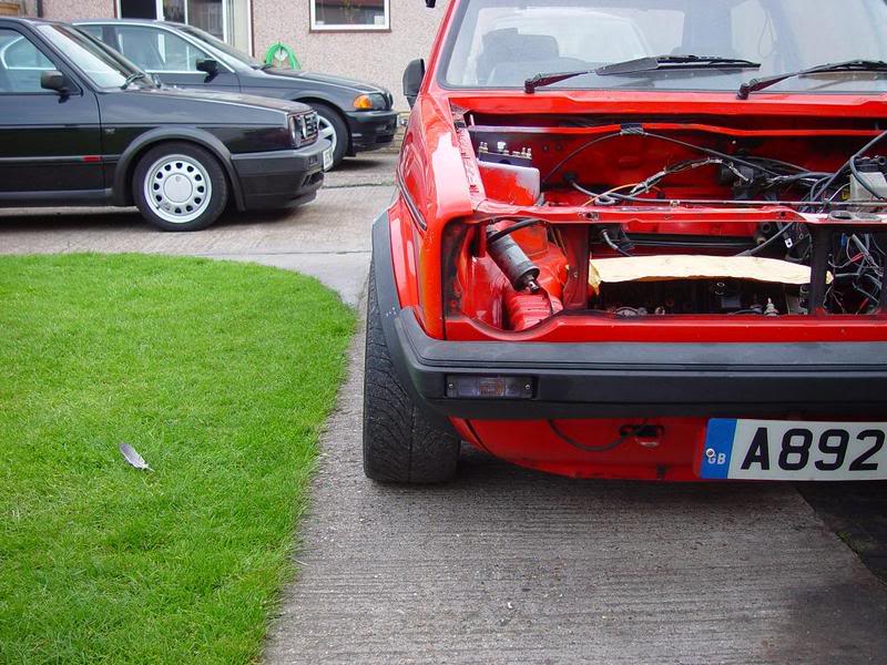

    With plastic GTi arches in place:
    Without plastic GTi arches in place:

    There is still some work to go with the head off at the skimmers at the mo and more bits n pieces to clean and paint before fitting along with engine ancillaries to fit before I fire it up and get it road legal. :)

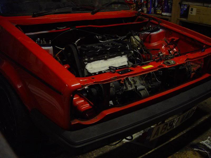

    Engine and box are in along with a few odds and sods.

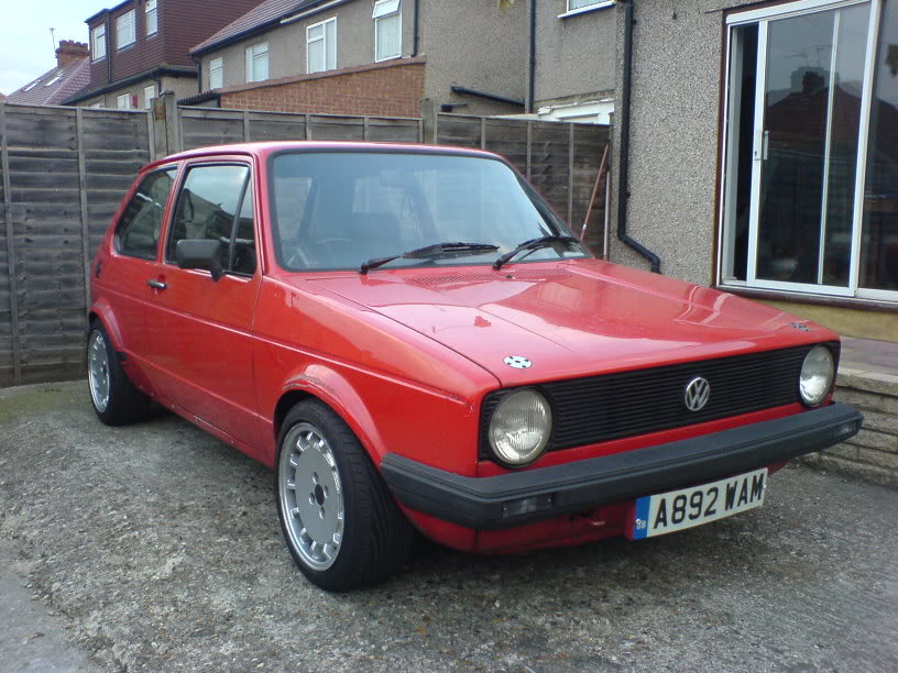

    what are those wheels???
  12. 1990
    1990 Paid Member Paid Member
    1,459
    Rochdale, Lancs
    Renault ones?
    The car looks great, nice work!!
  13. vw_singh Events Team Paid Member
    Oct 29, 2003
    793
    Not Renault wheels. Actually ARC's in 7x15 et25 fitment that belong to a friend. Quite hard to come by.
