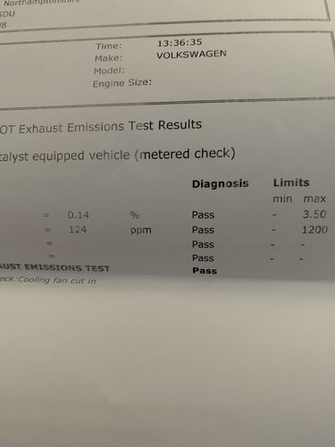

    Finally decided it was time to present this mk2 for a mot and it passed with one advisorie.
    Was suprised on the emissions test
    Co reading is 0.14
    H/c 125 ppm
    Should I leave it or go richer.
    First proper drive for this car since 2019
    Done a 20 mile drive with no issues
    I’d even say it feels newer than it is or I’ve just got used to driving my mk1.
    10 month project (in spare time)but all seems worth it now

  13. GVK
    Wants to be around 2 percent , thats very low at 0.14
    mk2 nas likes this.
  14. mk2 nas Paid Member Paid Member
    Jul 30, 2013
    108
    Northamptonshire
    Ok is it gonna do no good to be that low?
    Also is this low reading just the reading for idle and richens up during actual driving?
    I know I can make it richer but have no way of obtaining a 2% reading so it might be a case of making adjustment logging my alteration
    Then return it to this at mot time.could get an analyser don’t know how good they are compared to garages or what sort of cost they are.
    Sorry for all questions but would like it at its best.
  15. GVK
    Might run abit rough that low at idle, how does it run?
    mk2 nas likes this.
  16. John Bird Paid Member Paid Member
    Aug 26, 2021
    121
    Running that lean you can lose power and generate too much heat during combustion, can burn valves or worst case melt pistons. Give it a run at a steady speed, and pull into a lay by, remove the spark plugs and check the colour, can give you a very rough guide as to the fuel mixture. Check google for some pics as to what colours your looking for, if you can’t get access to a co machine. You’ll also smell it when it’s too rich
