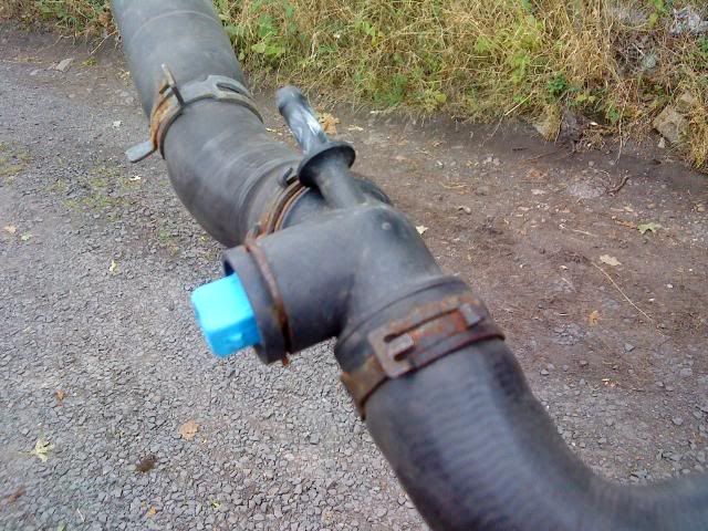

    Right, next installment. I have now trimmed down some parts of the wiring harness and i have also had a quick look at the wiring diagrams to see where to splice in the feeds for the harness.
    To start with i removed most of the covering from the wiring harness so that the individual wires could be removed. This seems like a daunting process but actually turns out to be fairly simple. The first wires i removed were those associated with the secondary air injection pump. The SAI pump is controlled by one of the 2 relays in the harness, the one in the brown holder.
    To remove the wiring i simply removed the pins from the plug. You need to remove the thick red wire coming from the battery, and also the thick red/white wire which goes to the SAI pump plug. This allows the plug and remaining wire to be removed.
    From here i went on to remove the wiring from the brown coloured connector (T6) to the starter. This is a medium sized red wire which is covered along its whole length in black heatshrink. The plug on the end is a single pin packard connector and the other end terminates at the brown plug. Again i removed this by removing the pin from the brown plug.
    Next i removed the un-needed wiring from the orange connector to a two pin plug, i am unsure exactly what this plug did in the original car however since it does not connect to the ecu at all we do not need it. Again these wires are covered in black heatshrink along their length and then connect to the orange harness connector. These pins can be removed.
    After this wiring was removed i made a start on removing some more wiring associated with emissions systems i will not be using. As previously stated i am removing the Secondary air injection, this is used to heat the cat and as i will not be using a cat it is not required. When removing the secondary air solenoid the ecu would normally log a fault code saying that the solenoid is missing or open circuit. To avoid this code we will be fitting resistors to fool the ecu into thinking the solenoid is still there. See this guide on VWVortex :
    http://forums.vwvortex.com/zerothread?id=3111538
    or this guide on Cupranet:
    http://www.seatcupra.net/forums/showthread.php?t=200030&highlight=n112
    Because i am going to be doing this and i will not be needing the connectors, i decided to remove as much wiring associated with these systems as possible and then hide the resistors in the loom. To do this i first removed the wiring from the SAI solenoid valve, i cut this up near to where all the blue/yellow feeds for the sensors join together (this will become clear when you strip the covering off the harness).
    Finally i did the same with the wiring to the charcoal canister. Again this can be cut back to near where the sensor feeds all join.
    And that is the wiring removal complete for the moment. :thumbup:

  12. rubjonny
    that coolant adaptor elbow looks like a handy piece, any idea what VAG model its from?

  14. 20v_jimmy Forum Member
    Apr 9, 2009
    Bristol
    Unsure on where the coolant flange came from altho i suspect something mk4 era. Will do some sifting on etos later. Alternatively im sure i could fire MUSH a pm over on edition 38..
    Cheers, James
  15. rubjonny
    aha, looks like its for 1.4 models:
    1J0 121 087 B - 4.71+VAT

  17. MUSH Forum Member
    Dec 29, 2003
    cant remember....?
    nice pic lol
    i got that elbow from a 1.6 mk4 golf, however ive also got one on my mk4 20vt, and thats got climate control so maybe for the models with a/c or climatronic?
    Either way it works fine with a digi temp sender as pictured
