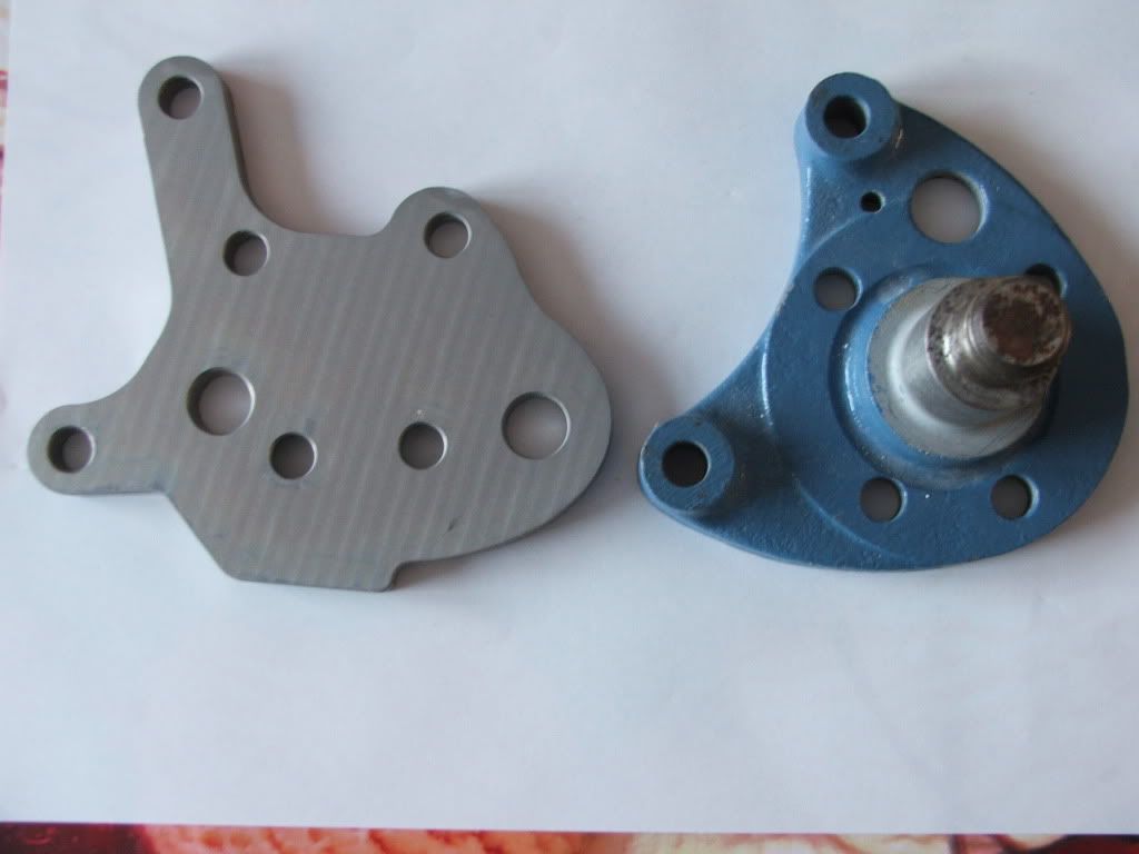

  7. MUSHY 16V
    Jan 26, 2008
    803
    aberdeen
    you get brackets on some of the lupo's that would make good spacers
    they are 9.5mm and the holes even line up
    you may need to trim some of lugs off
    they cost 10 each
    the p/n 6E0501466A and 6E0501465A
    i will try and get a picture up

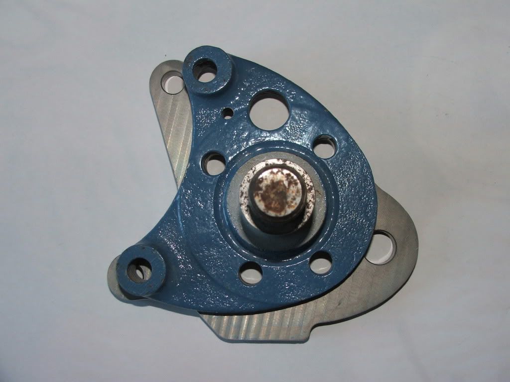

  14. MUSHY 16V
    Jan 26, 2008
    803
    aberdeen
    hear is some pictures of the bracket compared to a polo 6n stub axle
    and yes it will fit a mk3 golf
