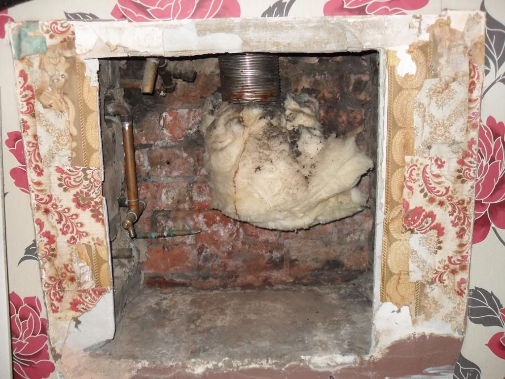

    she wants it fitting where the old back boiler was. which was taken out last year. [​IMG]
    It used to be a real fire then gas, now just this gaping hole.(plaster boarded over temp)
    I was thinking of tiling the bottom, plaster board the sides and tile then fit a new register plate above(metal or fire board?), plus a hearth.
    the hole is currently reduced visualy as that plaster board encrouches past the brick work in all directions

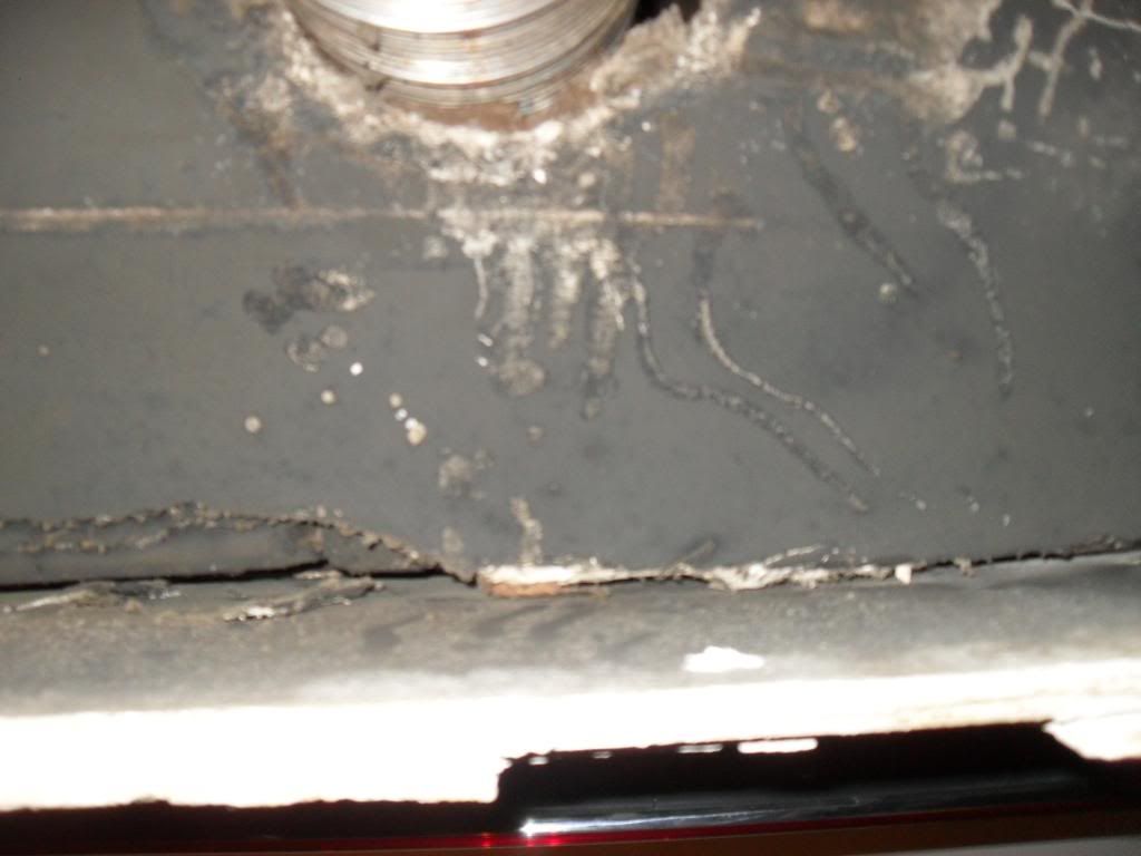

    just had a quick measure up and look, the current board in the register plate postition look totaly ruined. also it looks like there are brick above it, but i cant see a lintel!!!!!!!. surely no cowboy would stick a bit of board in place of a lintel.

    Ok, so on Saturday i thought i would make a start, the plumber told me that the pipes were dead. he lied. one felt hot, so must still be part of the system.
    i am now concerned about the gas pipe has this been diconected properly.
    which one is it ?what bore of pipe usually went to the old back boiler that was there?

    The gas pipe is possibly the one at the back 15mm dia looks like its been flatten and hopefully solder at the end. So could well be live. The 22mm pipe with the drain valve on is cetainly part of your existing heating system if its getting hot.

    thats a big concern. more pics to follow. thanks for the help
    why are they still there? should they not be re routed wheree the boiler is. they both appear to go upstairs where the new combi is? i assume they are part of the ch/flow/return
    that 15mm pipe appears to be sleaved down from 22mm (other side of wall )then heads down under floor boards. and back towards the gas meter. i will next check whats happened at the meter end hopefully i will find a terminated pipe that end .
    is that gas pipe flattening the industry standard?

    The ch flow and return pipes are possibly still there as they are feeding the radiators on the ground floor. Does the flow and rtn pipes carry on and go down under the floor boards on the other side of the brick work.
    NO flattening of a gas pipe is really bad practice should have a solder cap end if you cant access it or compression cap is fine if you have access to cap.
    Ideally you need to get all the pipes removed rerouted so you have a nice clean builders opening.

    the pipes are linked and bothe head bck upstairs as one which is what is confusing me.
    but i think i have it sused.
    the downstairs rads are fed from upstairs via pipes down the walls in trunking.
    the old back boiler must have fed and returned via those 2 which are now linked there .
    i would need to lift floor boards to sort it upstairs i think. i guess. why its not been done by the plumber

    Thats probably why they joined the flow and rtn there so they didn't have to lift floorboards upstairs. So you could get rid of them or just join them together on the other side of the opening. They linked the pipe together just to continue the loop. the pipe that joins them together could be a rad so you have flow in and rtn out. This might help you understand a bit more.
