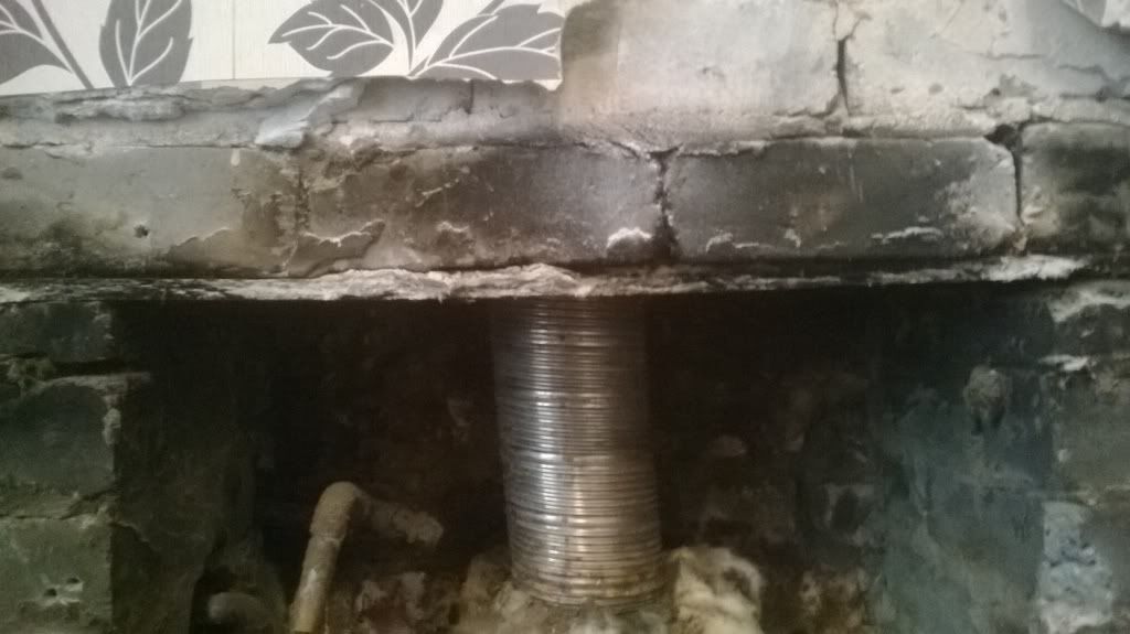

    If it had a cast iron fireplace in originally it was probably bricked in place so lintel required..

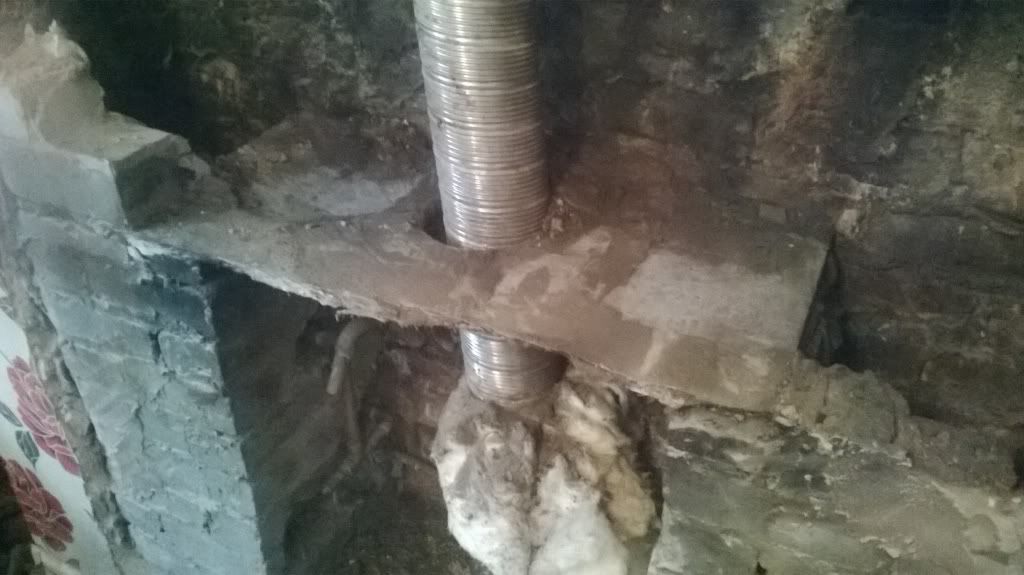

    I'd quarry tile the existing bricks if they aren't too pretty, totally fireproof. what diameter is that flue liner, if it's only 4" it'll be too small and have to come out, then you may have issues wiith the smoke leaking into your bedrooms.

    tthat flue is out thanks as its a gas flue thus unsuitable.

    to this no lintel the concrete blocks fell out when the plaster was taken off, its a wonder the wall was even holding the tv up!!!!! so i made this temp brace , its not going any where seeing as its been unsuipported like this for however long i dont know the wall hasnt been supported.[​IMG]

    this was a lintel !!! fibreous board of some description arrrgh [​IMG]
