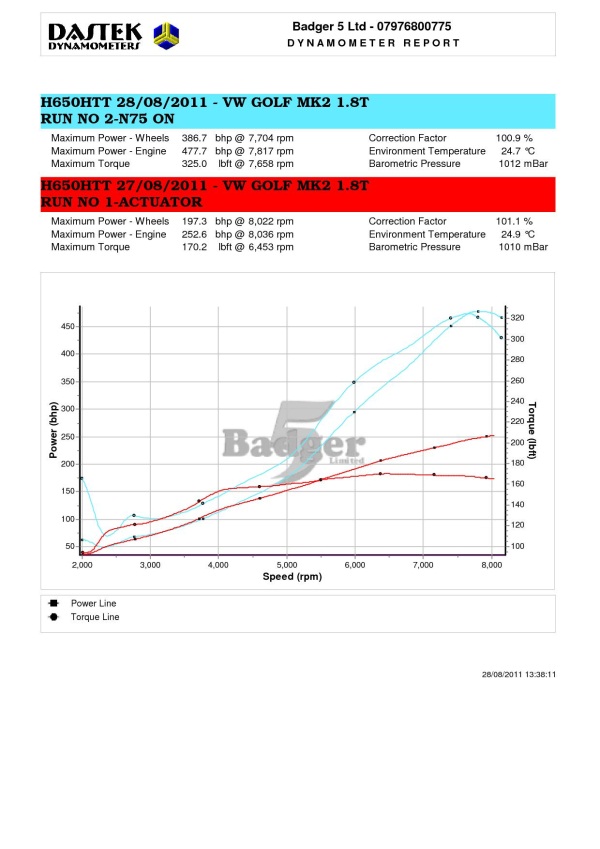

    okies.. Some ickle video's of it in on the dyno strutting its stuff
    [YOUTUBE]oBWzmVyYss4[/YOUTUBE]
    [YOUTUBE]dvgokyp3aR8[/YOUTUBE]
    [YOUTUBE]kV-jLdQ9HXI[/YOUTUBE]
    [YOUTUBE]K4p6s874XG0[/YOUTUBE]
    and for power... its switchable.. and I can share the lower power output publically
    255bhp on 9psi boost... and like a non turbo in drive terms.. nice wet/road setting to toodle about
    and when switched... muaha ha ha haaaaaa

    High rolling losses (20% on both actuator only and full boost) from the uber sticky R888's
    This is the max number run (just cos it can :) ), in practical terms, and its track use its turned down to 400bhp

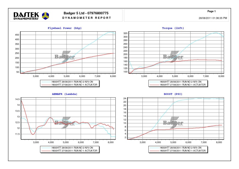

    Derbyshire
    Great horsepower there bill and nice smooth power curve. Not sure if i am reading torque curve right though, as at say 4000 rpm, when the engine us making around ten pounds of boost, I was expecting it to have made more torque and for the peak torque to have been achieved at slower revs.
  17. badger5
    15
    nr Glos
    its a bigger turbo so low end torque is not going to happen.
    I mapped it to bring on a sustained thrust which builds as it revs, proportional to throttle position/rpm
    Its still 2wd, so a big dollup of boost/torque will most likely just provoke wheelspin, which was not my aim.
    The boost control is progressive (as I can get it)
  18. 8pots Club GTI Sponsor and Supporter
    Dec 23, 2006
    Derbyshire
    Thanks for the reply bill. I understand that a bigger turbo will take longer to spin up but my point was that at 4k it is making 10 pounds of boost, if it only ran ten pounds i would have expected more like 220 pounds of torque
