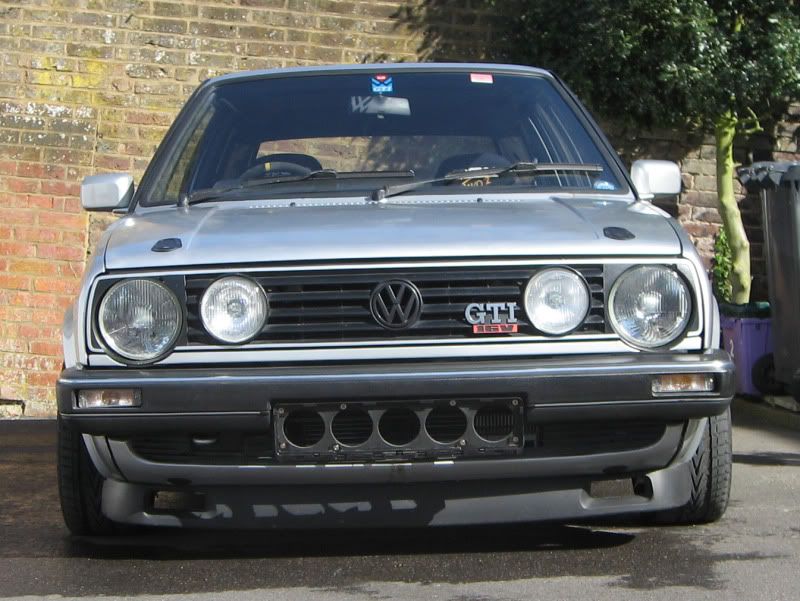

  16. Admin Guest
    I mounted mine using existing holes in the slam panel. I made sure that the catches were also in an aesthetically pleasing location, looking back now a couple of years down the line I am still very happy with their position and would not change.
  17. Bruce T Forum Member
    Sep 30, 2010
    35
    On the bog...
    That's what I'm talking about! lol
    Tom, which holes did you uses? The biggish hole near the oe rubber bonnet stops?
  18. Trackslag
    Trackslag Forum Member Trader
    Jan 27, 2012
    44
    That looks mint! I like it and I'm pretty sure that most people fitting such catches would be happy with them there?
