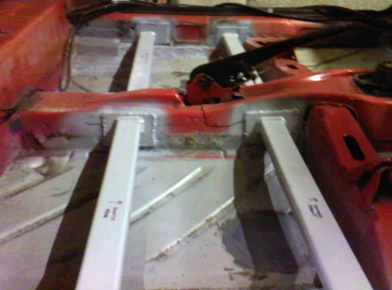

    Mine is box section and very happy with it:
    [​IMG] [​IMG] [​IMG] [​IMG]
    Per the MSA (for racing) they have to meet the description of 'fit for purpose'.
    Box/tube - seamless or non-seamless are all fine.
    Some FIA seats come with indications/instructions apparently.
    HTH.

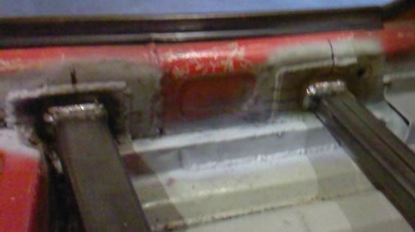

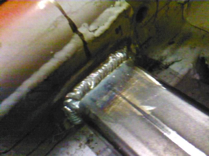

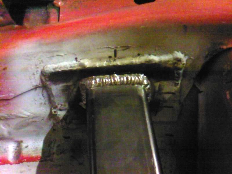

    Hi Chris the pictures aren't there any more :cry:
    Mike, as mentioned the photobucket had maxed out. All pics are back up :thumbup:
    Quick pic of a mid-'90s works Impreza co-driver seat rail, profiled and sunk into the floor as far as possible. The side of the tube will be cut open due to the profiling, so it is welded along the lower edge for a distance.
    Bag of potatoes, so no arguments about sightseeing. He or she sits as low as possible :thumbup:

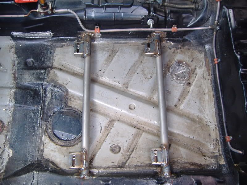

    Is it necessary to remove the horizontal bracing too? I have only removed the rails either side and the bracket where the seat lock pin sits thinking that would be enough.
    Its a Mk2 Scirocco but the floorpan design seems pretty much identical (ish)
  15. mr.brown
    mr.brown Paid Member Paid Member
    97
    Sunny Surrey
    Unless you're 5ft tall the centre brace has to go in order to get the seat low enough. This is my mk1 Scirocco at the moment. Not sure how much effect remove the centre brace will have but I'm sure its negligible - its made of cheese anyway.
  16. Mk2daz
    Jun 2, 2015
    Awesome thanks for that, my plan was to keep it in for some additional floor bracing, however I have yet to properly 'mock up' final seat position, I'm about 6ft on the dot, so looks like the bracing will be going - cheers!
