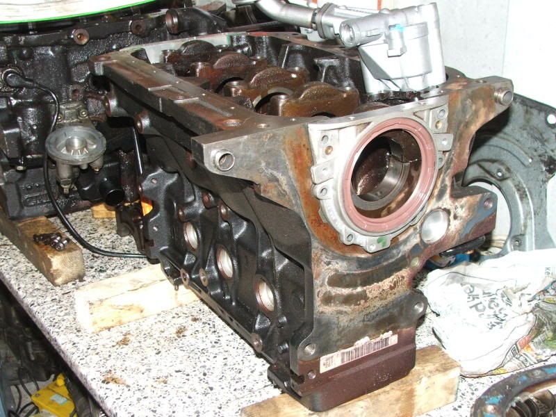

    Update - still waiting for the Pistons /Crank and everything else delivering!
    Oh yes & fitted new crank shaft oil seals ! wot a pain to get out ? and modified the bored so the H-beam rods clear.

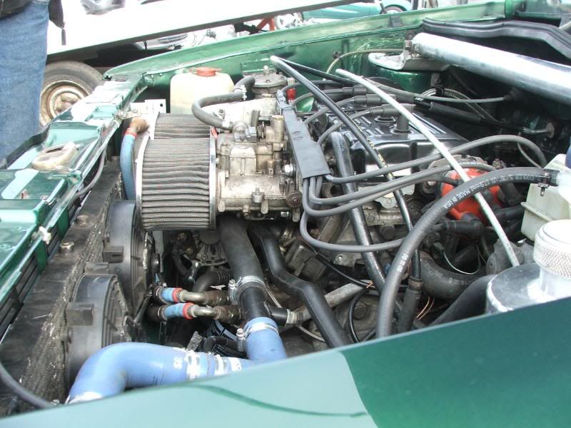

    called at my Friends today to fix his nitrous system here's his 2.1L 16V 9A BRM Big valve head 45mm Weber Alpha Injection 300DEG Cat Cams solid lifters 240bhp NASP + 150BHP Nitrous oxide system . [:D]

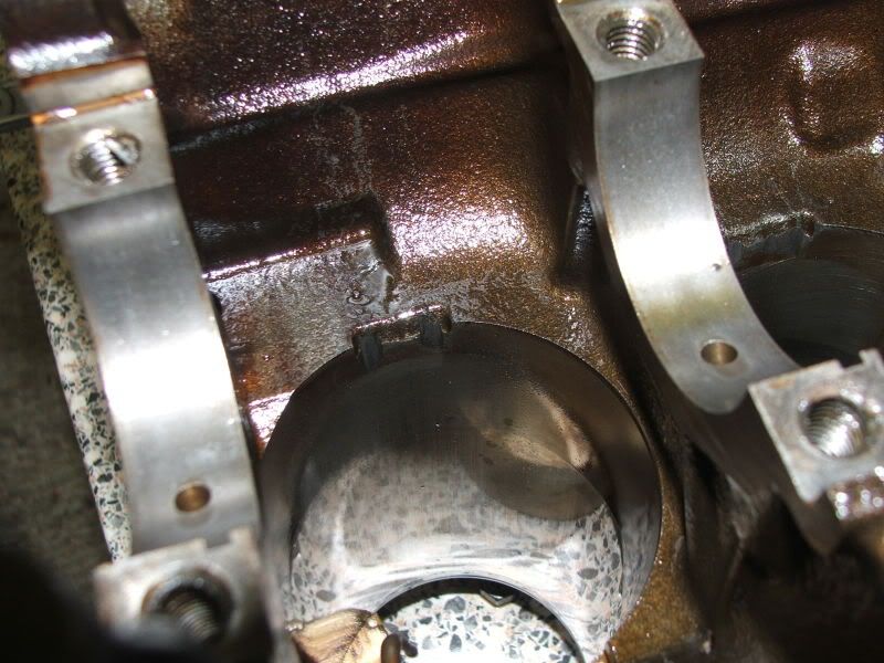

    Here's a detail of the bores on my old ABF Block that have been modified so that the H-beam Rods don't fool on the bores on the stroke.
    Just done the same on the new block his is the old block.
    New block with the modification, not as much required due to 1mm larger bore (bottom edge)
    New seals fitted ready for the New Crank and Pistons to arrive. Note new Oil Pump too.

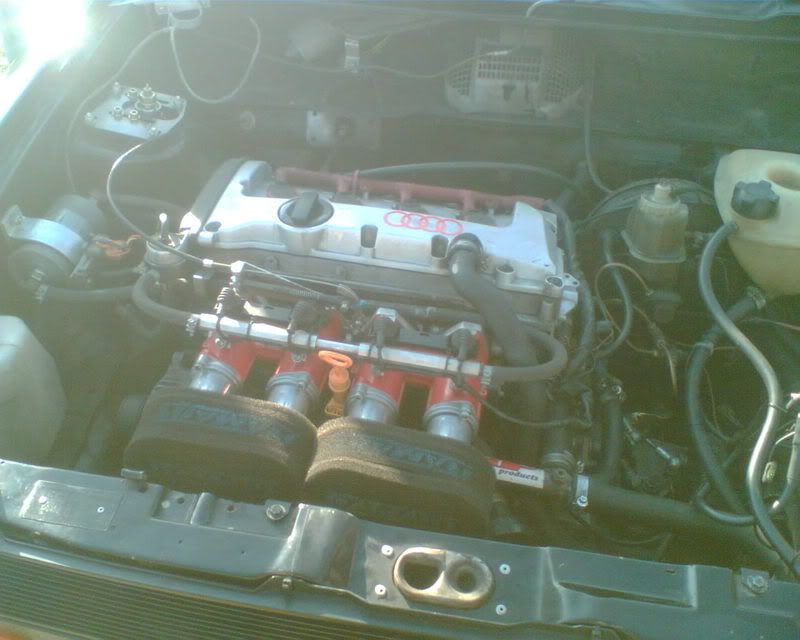

    any thoughts on the cost of a equal lenght manifold like the one on the car in the pics and what sort of gain would you expect?
  14. altern8 Forum Junkie
    Cocos (Keeling) Islands
    these are mine if that helps [:p]

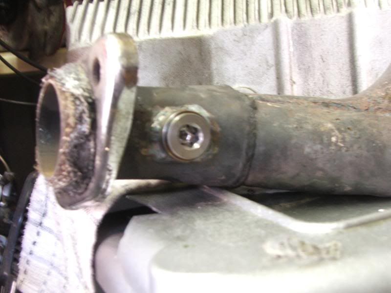

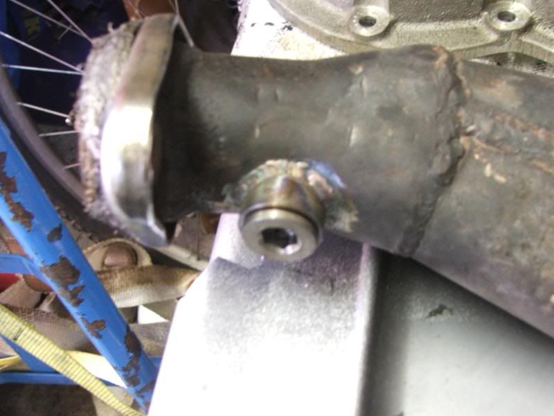

    Made some progress, got the Bung welded into the 4-2-1 for the wideband to be fitted.
