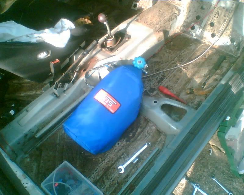

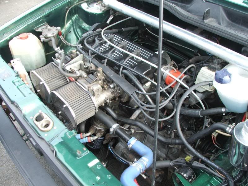

    MK2 Driver's Hey !!
    They are from Pace but waiting for a price from Pro Alloy.
    The servo is on the opposite side on a MK1 :o its the drivers seat that on the wrong side :lol: :lol: :lol:

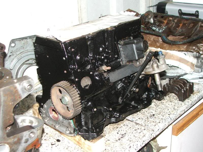

    Painted the block today ready for everything else to arrive.

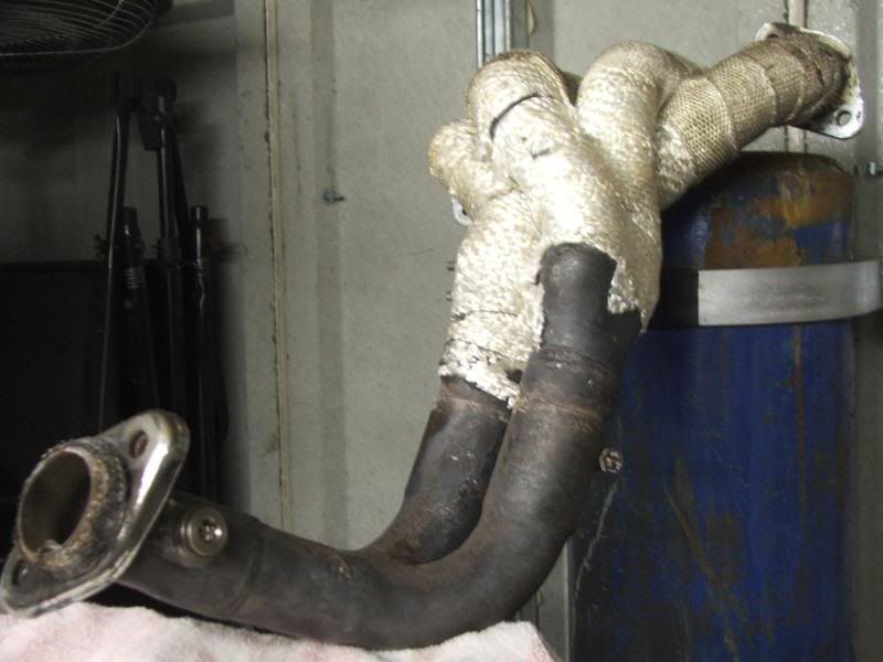

    Going to get some new Heat Wrap for the old Supersprint 4-2-1
    Also need to get the MK1 booked in for a Pipewerx 2 1/2" System
    The existing exhaust is 2" Stainless System which will be going to a good home.

    did you have to fabricate an extension to fit the supersprint mani to your system, if you did you wouldnt happen to have the dims would you?

    The Supersprint came with the flange but it required a 2" x 600m extention welded onto it to fit the existing 2" Stainless system.

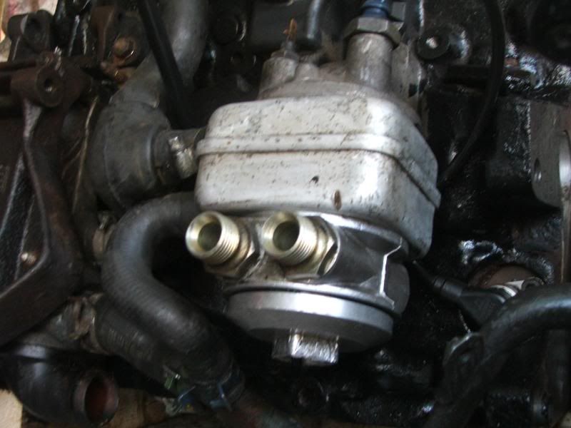

    Made some progress today while waiting for everything to arrive.

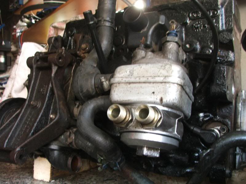

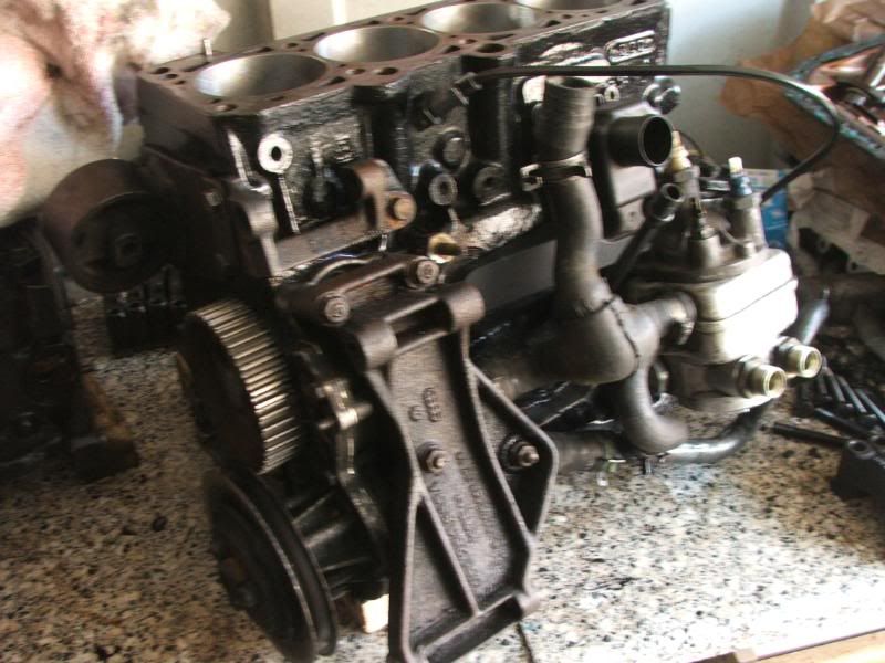

    Fitting the water pump and Alternator bracket and side engine mount from the old block.
    Also transvered the twin Oil cooler set - up, the Water cooled Oil Cooler and the sandwhich plate for the Mocal 12 row cooler which has build in Thermostat so keep everything at the correct temperature. Run this set- up for the last ten years and works very well.
    Requires a remote Oil filter set -up due to the limited space between the block and the front panel.

    Yes its Paul Bargates famous Rocco Original 16v Left hooker , with the trumpets thru the bonnet.
    The cranks is an amazing piece of engineering, can't wait to se the pistons, the ARP Mains studs are coming with them too.
    and Hopefully the 45mm DTH Jenvey's will be here in a few days too.

    Dumb question ALERT - Er where does the oil filter go? [:$]
