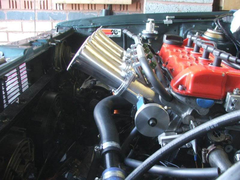

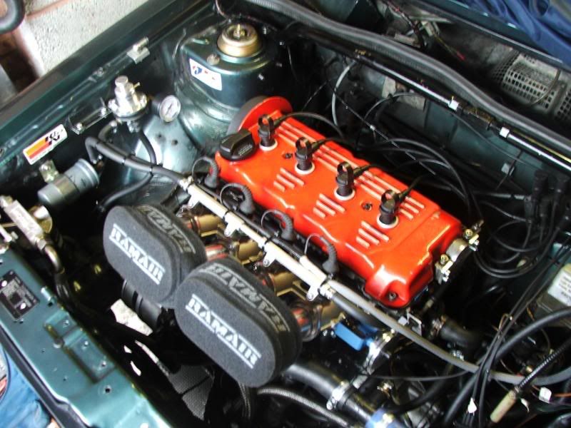

  3. Brookster
    Ade's old MK1 20V with Jenvey's not DTH but had custom inlet manifold to get the correct angle

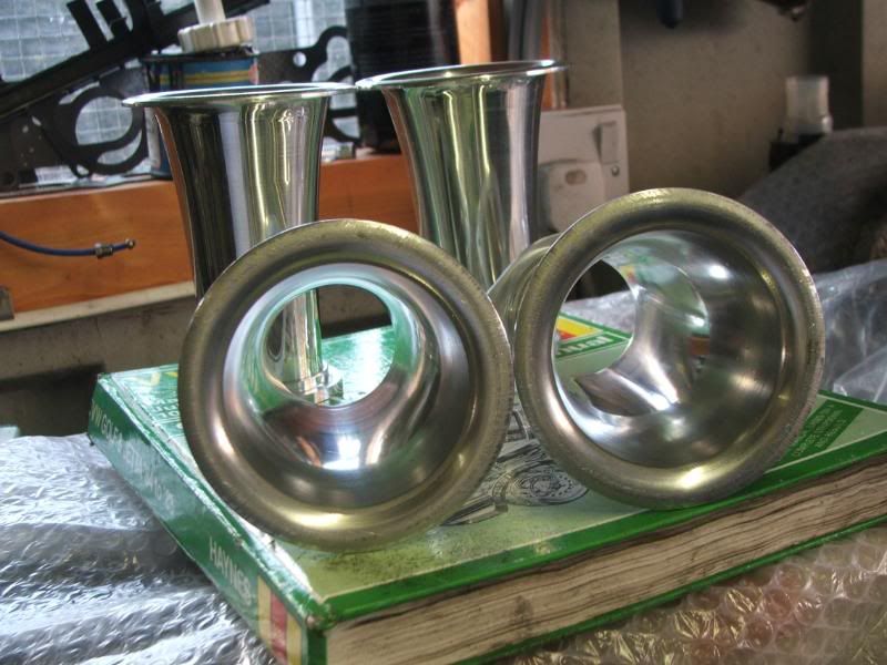

  4. Brookster
    Custom Trumpets on the Jenvey DTH

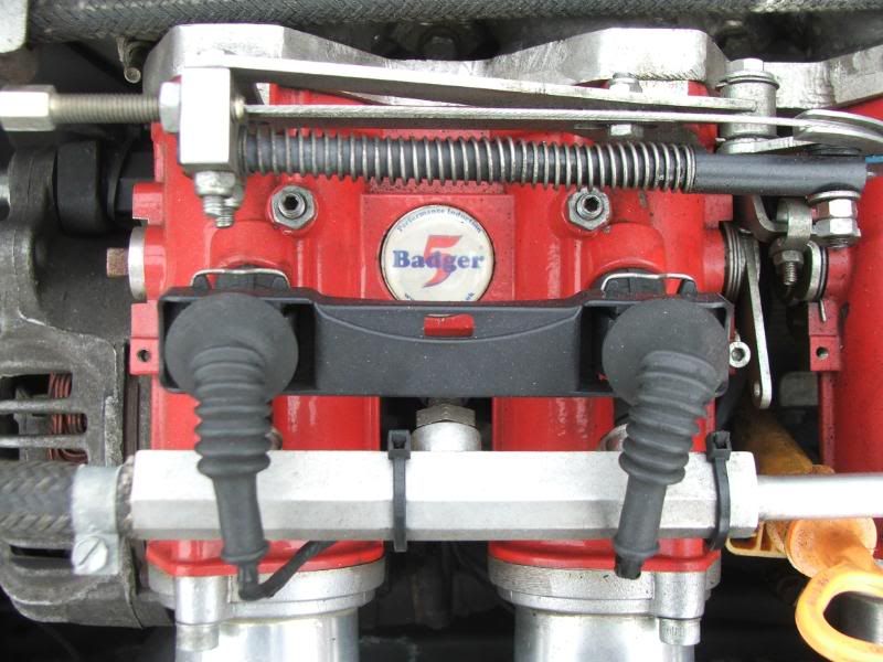

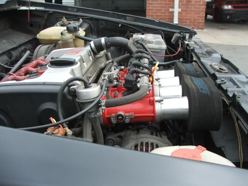

  5. Brookster
    DTH Angle from side shot

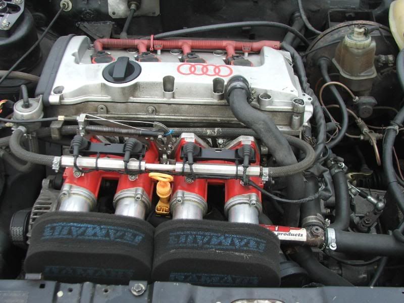

  6. murph81 Forum Member
    Feb 23, 2010
    66
    Republic of Ireland.
    Thanks for the pic Brookster, looking at it now I don't think the Badger5 set up will do, looks like custom curved spacers are needed.
  7. Brookster
    MK2's with DTH Fitted

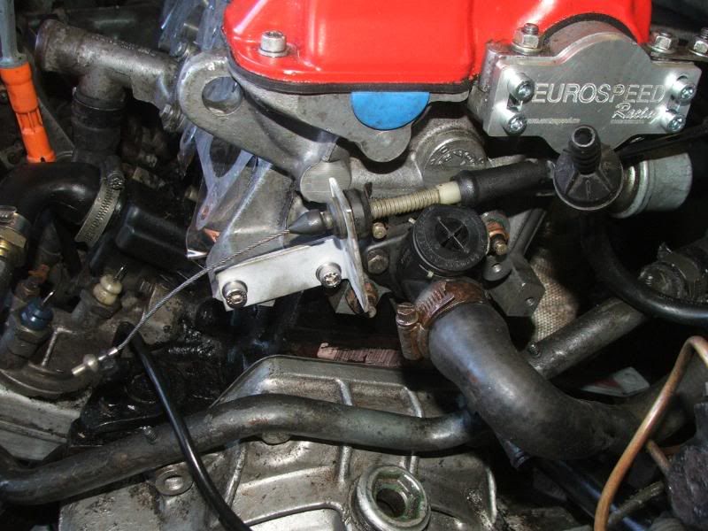

  17. infinity
    infinity Forum Member
    Jan 20, 2004
    Anyone know the origins of this throttle linkage?
  18. murph81 Forum Member
    Feb 23, 2010
    66
    Bill at Badger5 designed and made them afaik.
  19. Brookster
    Yeah they are from The Badger

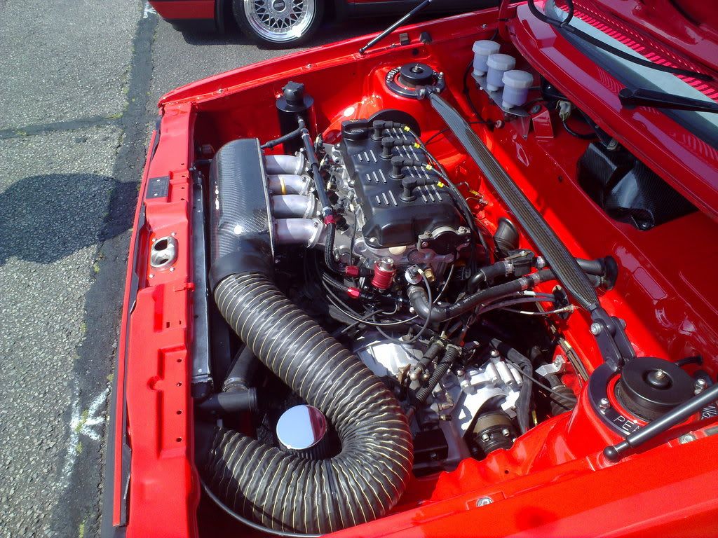

  20. Brookster
    fired up the MK1 at the weekend and tweaked a couple of items ready for it to come out to play in two weeks an Santa Pod
