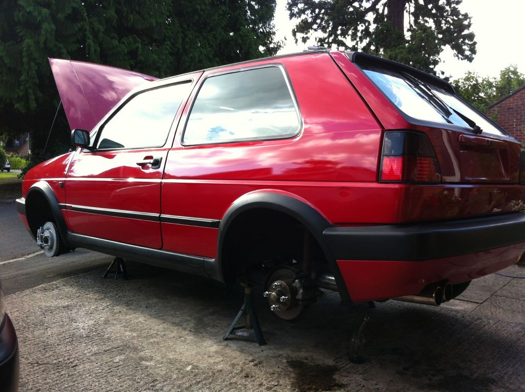

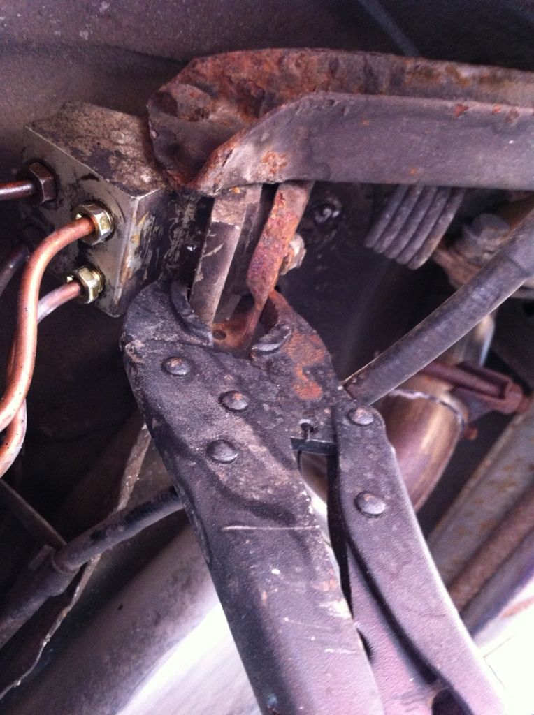

    Got a couple of hours in on Saturday to bleed the brakes and fix the alternator wiring. Bled them all through but annoyingly it seems one of the back calipers has seized on after bleeding which is odd as it was fine before. Piston is stuck solid and won't re-wind/free up so looks like I may need a replacement. Quick spin round the block didn't free it off either. Kicking myself for flogging the Ibiza ones now!
    Battery light issue is now resolved using a section of Mk3 wiring and plug but trying to get to the bottom of the idle issue still.
    Seems the Mk2 is doing everything in its power to prevent an MOT at the moment [><]lol

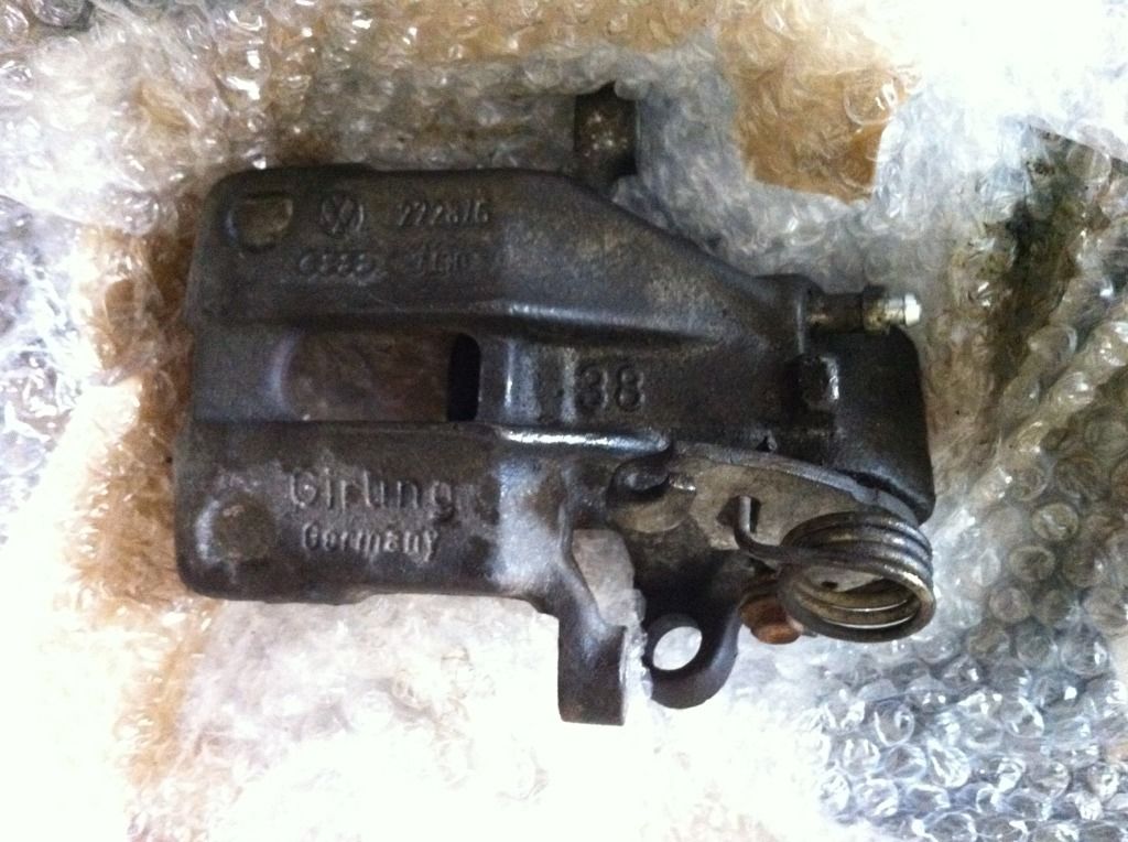

    Replacement rear caliper showed up today along with some ATE Racing Blue fluid too so round two with the braking system this weekend.

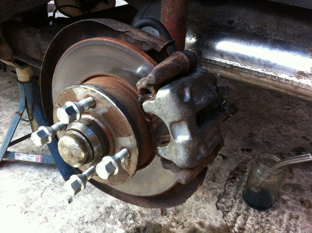

    Few more hours put in to the car this weekend. First on the agenda was to bleed the brakes up.
    Armed with 2 litres of ATE Super Blue and a glamorous assistant, two rounds of the brakes with the traditional 2-man bleed method saw the pedal still feeling a bit rubbish. Decided to give a pressure bleeder a go and got a lot more air out but I'm still not overly happy with the result - will have to revisit this at a later date but at least for now I have some form of brakes and a handbrake that works.
    New caliper fitted up which is a huge improvement on the seized rusty one that came off.
    With that complete I nipped up the hub nuts to a decent torque (cheers for the wrench jonesy), a quick bucket of water thrown over it to remove several months dust and boshed a few finishing touches on to the car :thumbup:

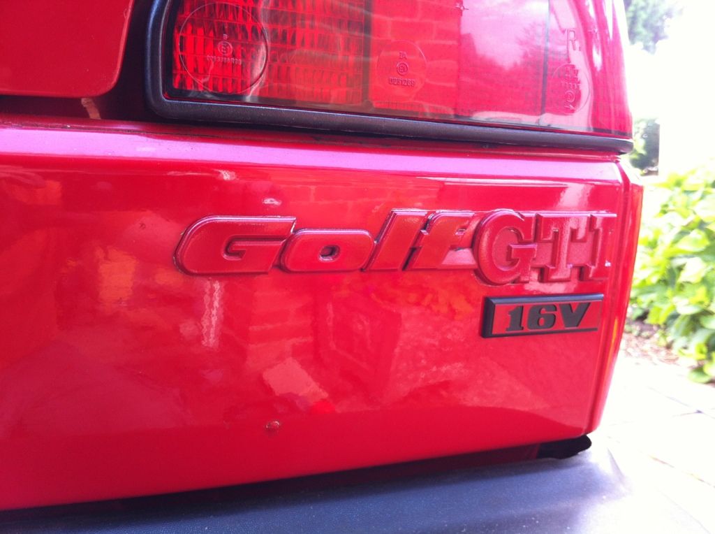

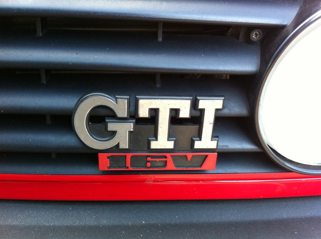

    16v badges:
    UK legal pressed plates (bit 'scene' I know but they look a lot tidier than the cracked plastic ones I removed)

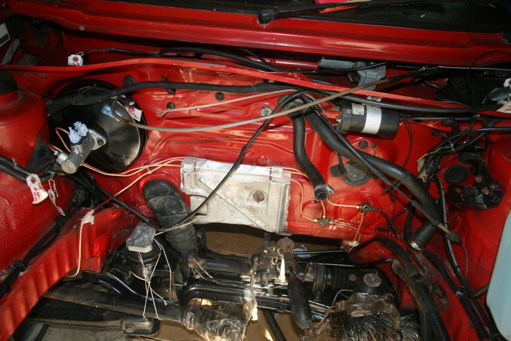

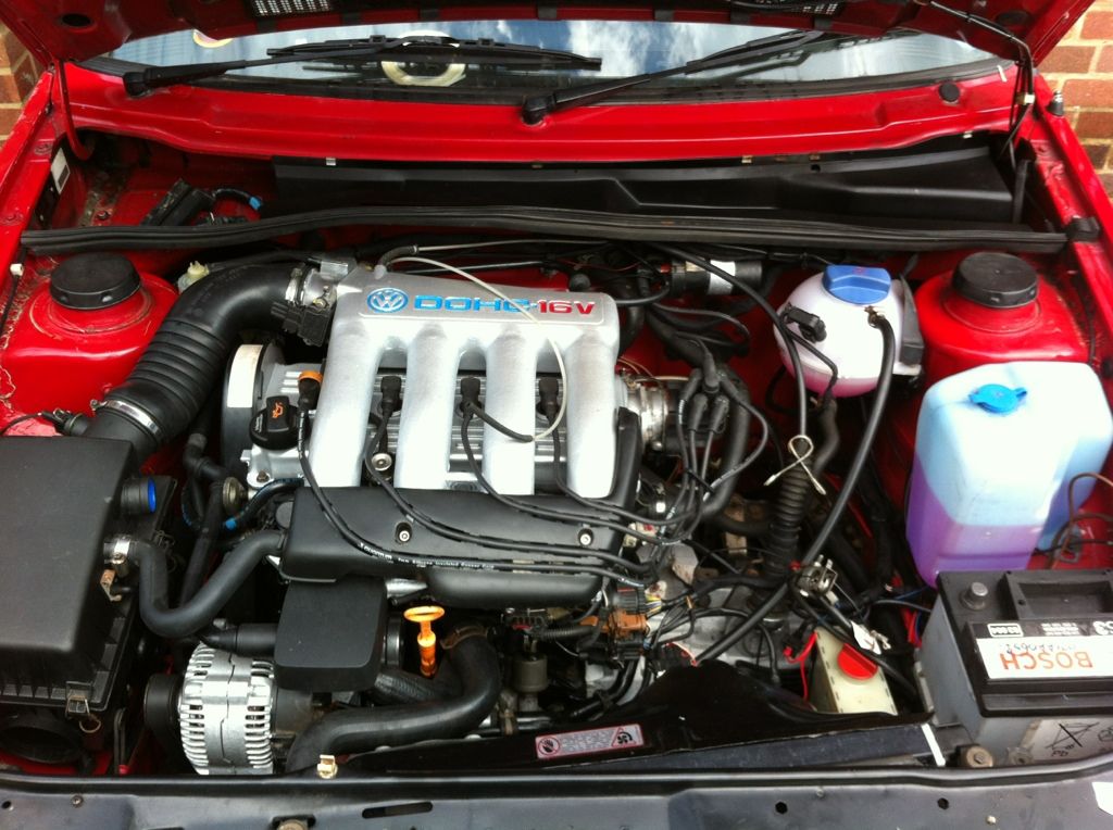

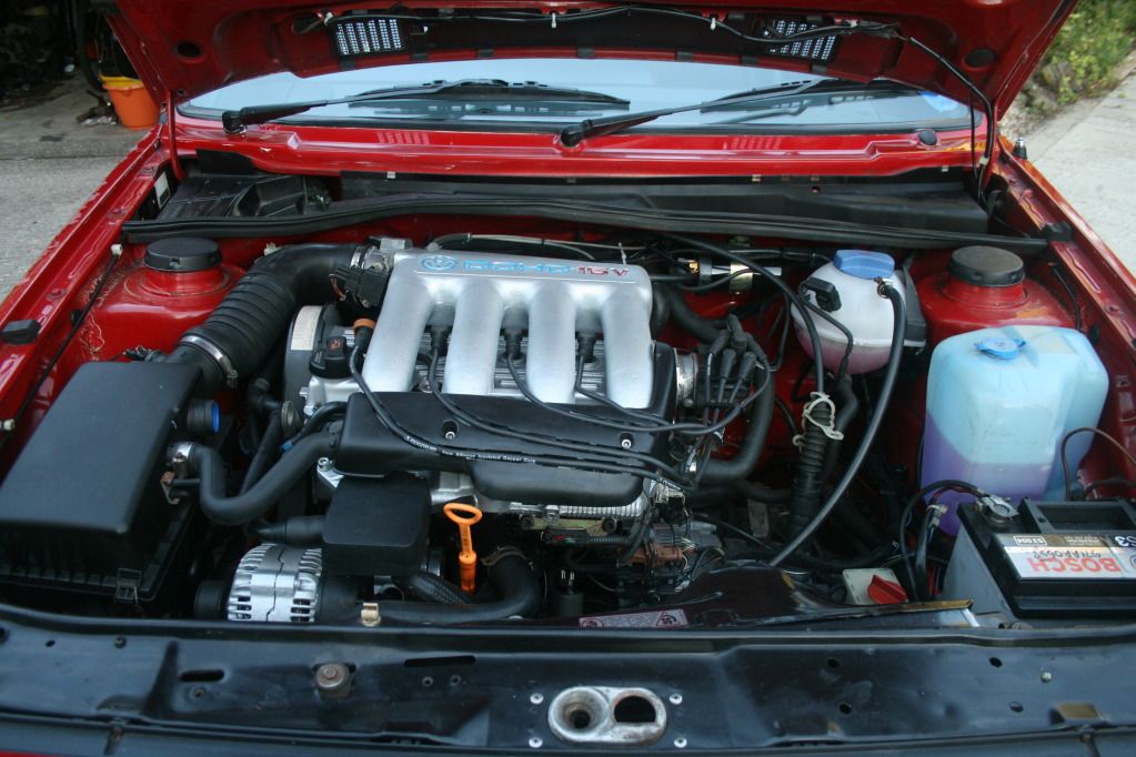

    So yeah pretty much conversion complete now (other than mocking up a better ECU tray for the car, vac line is also now connected). Just the G60 arches to go and a damn good clean/polish. MOT is in sight :thumbup:

    Massive thanks to RJ again too for the loom and endless hours of advice given, much appreciated :thumbup:

    Popped down to have a gander and couldn't see anything obviously amiss. Quick bit of fault finding revealed no spark so had no choice but to tow the car home again. MOT incomplete. Once home I popped a new coil on just to see if it would start and hey presto fired straight up! Great! The next day I decided to try the old coil again just to be doubly sure it was that but the car fired up straight away again on the old coil. Hmm.
    Got Vag-com on it which revealed the code:
    00740 - Cylinder 1 Recognition Sensor (G145)
    03-00 - No Signal
    Possible Hall code fault. Weird. Boshed a new ECU relay in there for good measure as well to rule that out but it seems it's still missfiring but with no fault codes this time. If anyone has any ideas on this please do share. My gut feeling says that the new crank sensor I replaced (topran) is faulty but I'm unsure. Starting to get royally ****ed off with Mk3's and their crappy senders! lol

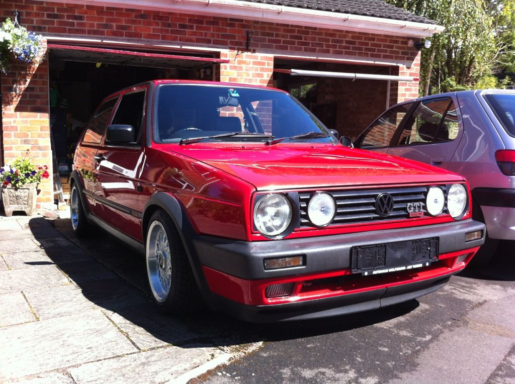

    With that sorted I got on with addressing 'Tornado Pink'
    Came up quite nicely if I do say so myself :thumbup:
    Just got to get the bugger running right now and fit the G60 arches.

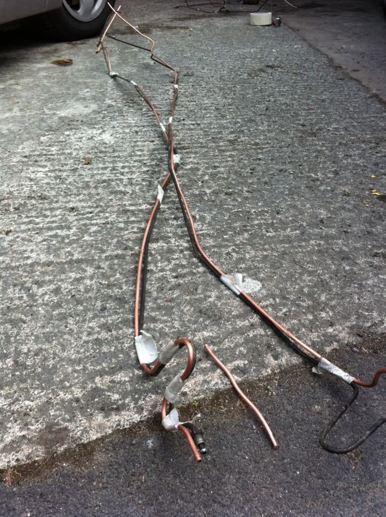

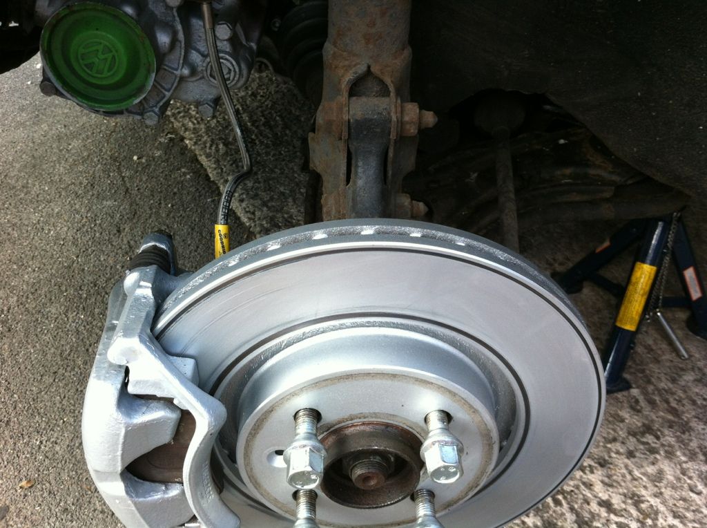

    I must have over looked this part of the thread. Great work on replacing the lines, you've done a good neat job there. :thumbup:
    I desperately need to do this on mine, as ive got a cupra M/S to go on with 280's, and ive got to make up some new lines.

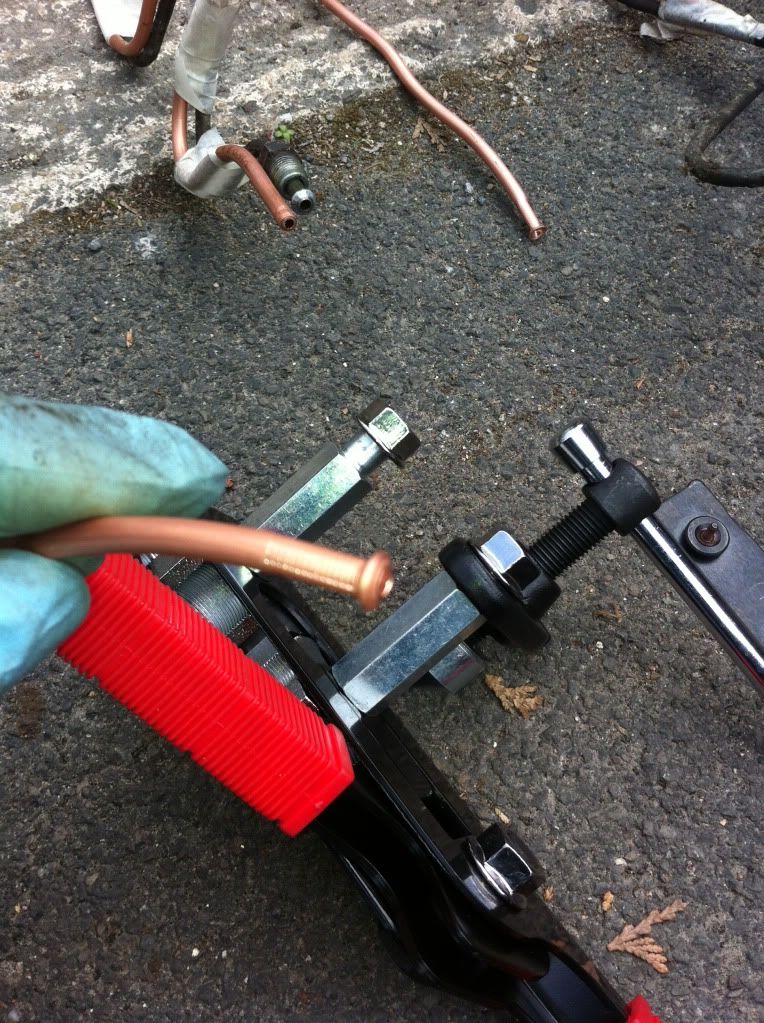

    Just wondering, where did you buy the new lines from ? And what did you use to bend them ?
    Top thread though. Ive just read the whole lot again from start to finish :)
    Cheers :thumbup:
  12. jmsheahan CGTI Graphics Designer
    Aug 6, 2009
    109
    Wiltshire
    Cheers Rich.

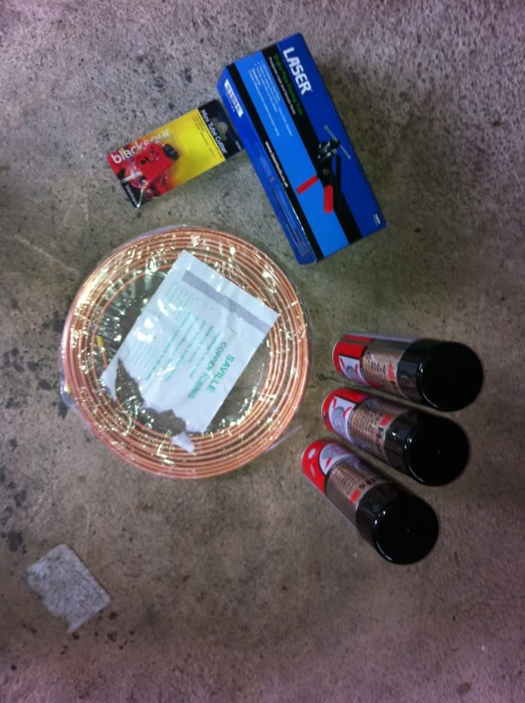

    The copper metal lines I just got a roll of it from eBay, was around a tenner I think. For bending them you can get specific tools but I just shaped them with a variety of different sized sockets (good for getting near perfect curves etc) and my hands - good thing about copper is its a piece of p**s to mould to whatever shape you need. Would recommend getting yourself a good flaring tool if you haven't already, was worth it's money (30).
    HTH :thumbup:
