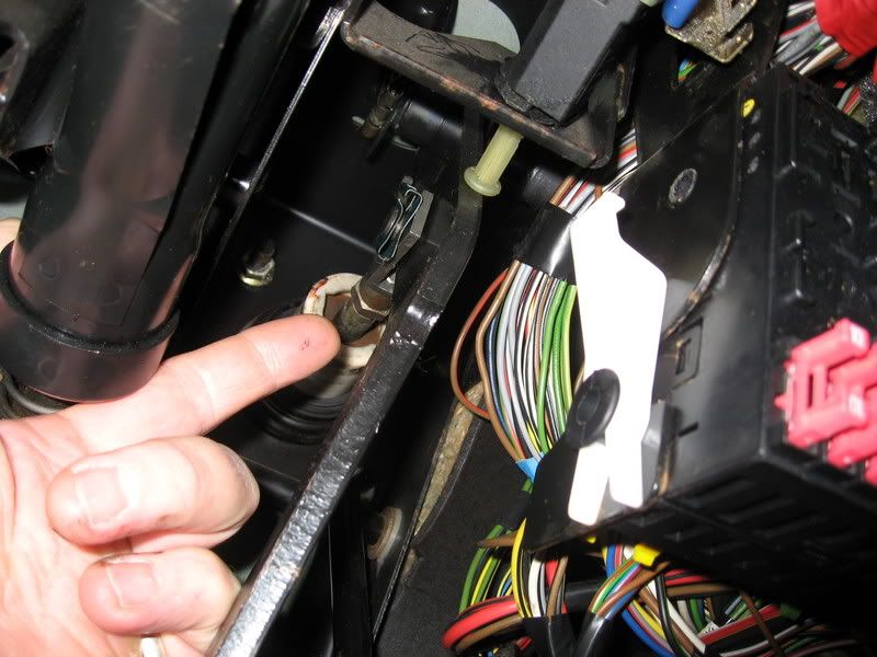

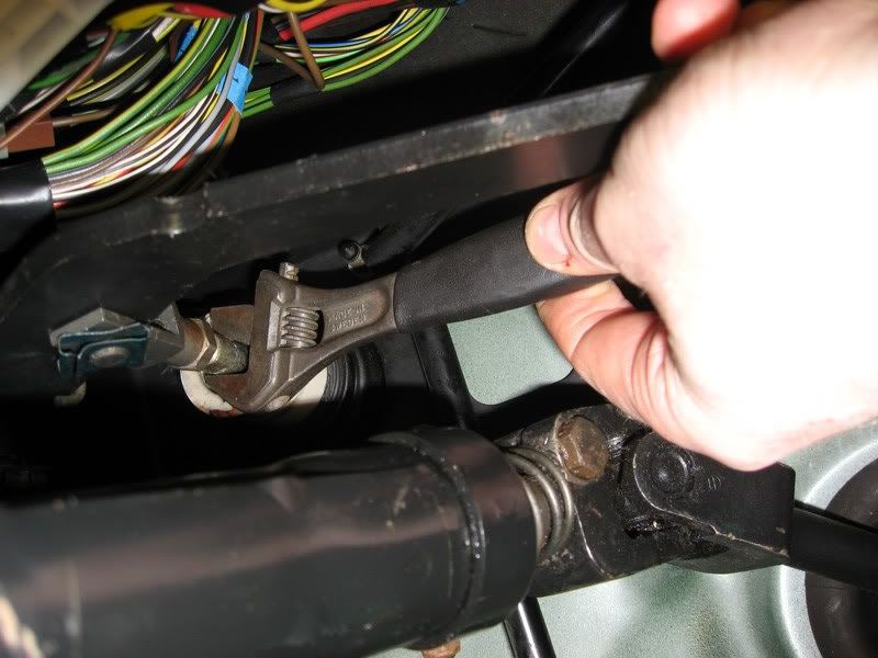

  19. blis Forum Member
    Dec 27, 2011
    619
    New South Wales
    I did the above adjustment and my brake pedal is much nicer now with the free-play removed.
    Loosened lock nut, adjusted barrel until it just touched the brake light switch and now the pedal has no slop.
    Brake feel is now more responsive.
    Thanks Nige!
  20. Nige
    Nige Paid Member Paid Member
    Dec 12, 2006
    2,139
    Excellent !!
    Make sure you don`t go too far, otherwise the pads will drag on the discs. You need a tiny amount of slack to be safe :thumbup:
    blis likes this.
