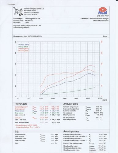

    8V GMS big valve head with Kent GS3 cam, vernier pulley, matched inlet and Audi throttle body, full Magnex system including 4-2-1 tubular manifold and lightened flywheel on a very very tired std 1800 bottom end with std K-jet.....
    142 bhp @ 6,130 RPM
    123 lbf ft @ 5,950 RPM

    Just looked at the address on that Dyno plot. I used to go to 'Lamby's' all the time as a youngster. :thumbup:

    Yeah John was really helpfull. I just wanted to get it running right as I had just stuck that head on as I'd had it sitting on the shelf for nearly two years and thought I might as well make some use of it....I was quite surprised how much power it made considering the bottom end had probably done 100k or so and CR was not really high enough to make proper use of the cam installed!
    John reckons there was probably a little more to come but we were halted by the clutch going BANG...literally!
    I must try and get back up there sometime soon as I have dropped a RE1900 I have recently rebuilt into the Mk1 and want to get the fuelling and ignition set up properly! :thumbup:

    Used to live not far from Lambs in Clowne
    that graph looks quite modern as I remember no new machine with printouts but some ancient old dials instead & a hand scribbled output

    Yep Jan 2008

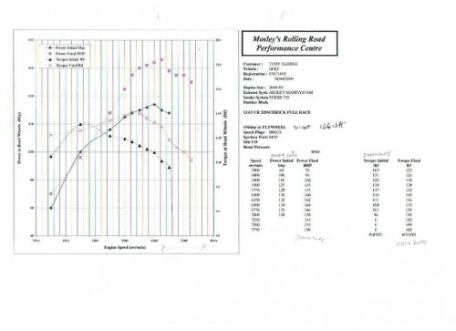

    I'm really happy with the engine, we are really doing well in the Welsh Hillclimb/Sprint Championship this year, beating a lot of far more powerful and modern cars. Have attached a dyno print out of it's last run.
    Doing some cross referencing Hotgolf was on the same road earlier in the year with his 2.1 16v and we have very similar power and torque, he had 220bhp at the crank, mine 217bhp so that's a good reference. The 8v makes it's peak lower but the power curve is a similar. Again my Brother was on the same road in the afternoon with his Va****L XE engined GP4 Escort with QED 220 kit (cams, pistons, rod bolts etc.) 45's, MBE mapped ignition, Ashley GP4 manifold and system etc and that made 216bhp at the crank!
    I've developed this engine for 4 years now, when I first took it to Mosley's as an ex slick 50/Eurosaloons engine with a std TSR 'D' spec head, Shrick 304 cam, Mahle pistons, twin 45's, std Ashley race manifold and system plus MBE mapped ignition (carbs and ignition added after it's Eurosaloon days) it made 160bhp.

    Interesting to see the plot profile and the torque behaviour edit: as in on a fully breathed 8v. One perhaps to lay over some 8v data coming from the dyno tomorrow.
    Is the lower curve the LMA engine, or interim spec?

    The lower curve is the first run on the current engine. The LMA was running the MBE ECU but with an ignition only map, when we set up the new engine, to save time, we put a tarmac spec redtop map in and adjusted it to get it to run. I then put a few hundred road miles on it to bed it in.
    After that it went back on the rolling road and we adjusted the fueling to get it to run tidy. We had some issues low down as we had to go a bit over the top with the settings to get it to idle and it sat at about 1300rpm hot and the power dropped off too quick at the top end so after a bit of dissection of the readout we decided we needed to have another go once it had loosened up a bit.
    I ran it like this for the first half of the season, that is the lower readout on the graph above. I have a plot of the LMA (with carbs and mapped ignition) and the interim plot on the same printout, I'll copy it later and upload it as it is quite interesting. The LMA motor has a big gap between the torque and power peaks making it a very torquey engine where as the initial set up of this years engine had the torque and power peaks very close. When we set it up properly recently, as well as getting more of everything across the range, we moved the power and torque peaks apart by 1000 rpm making the engine more flexible.
    It now ticks over at 800rpm as smooth as you like, you could drive it down to Tescos and back with no problem, however it just wants to go, and revs very freely. It hits the 8k rev limited constantly as it doesn't drop off as it revs (when your racing you don't always watch the shift lights!). I'd let it run on more but I've not got steel rods in it yet so I keep it down to 8k at the moment.

    Here you go, this is a plot showing the LMA engine, typical of the breed, TSR pack D head, Schrick 304 cam etc + twin 45's 4/1 manifold, MBE mapped ignition with a plot of the first run of the current full race engine. The one above shows the same race engine as built and then following some proper set up time to get the best from it. We saw a little more top end but at the expense of mid range so we sacrificed some top end for more mid range as we run on Hills and in Sprints. All figs are wheel BHP

    I was pleased and quite surprised with the results to be honest.....as stated the bottom end was very very tired and CR not really high enough for the 300deg cam :thumbup:

    Is 217bhp @ 6750rpm 168lbs/ft?
  15. DRV
    DRV Forum Member
    Mar 17, 2011
    168,8 is more than 166lbs/ft torque @ 5000rpm
    Mistake in power output or...
  16. mr hillclimber Club GTI Supporter and Sponsor
    Nov 24, 2005
    149
    Southwest
    Nope...a mistake in my quick calculation over the phone based on the figures tony gave me off the top of his head...he didn't have the graph to hand.
    We were talking about peak torque rpm not torque at peak power. It does make a fair bit more than 166ibft at 5k...it was showing 155ibft at the wheels at 5k...so into the 170's.
    Whatever it does make Tony is cleaning up in his native championship...beating 260hp 205 16v's and 280hp 16v rwd hybrid rally cars...and a few kit cars along the way. .So it's holding it's own with 8v's less.
    I'll let ya'all know how good it is after next weekends hillclimb down here with a rusty old nut behind the wheel! ;)
  17. Toyotec
    3,365
    The 217 bhp number appears to be dyno derived from the "wheel" information as seen in in post 54
    @169lbft@6750 it would suggest the clutch torque would be more than 175lbft, given the shape of the wheel torque curve.
    The number for torque, "166" hand written, does not correlate with a "peak" wheel torque as this does occur at 5750rpm (155wlbft).
    Reported numbers in this plot cannot be taken as an absoulte but I do believe and have evidence the plot shapes and activity per rpm breakpoints are good.
    With the rev range and torque activity demonstrated in the above plots I could easily say that is strong pulling 8v engine.

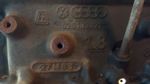

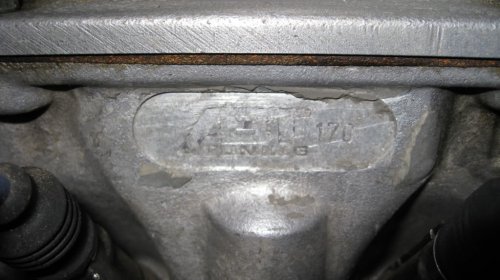

    @ Chris,
    I think the info for ABT is wrong. They used a DZ block on the 1800E.
    Head..

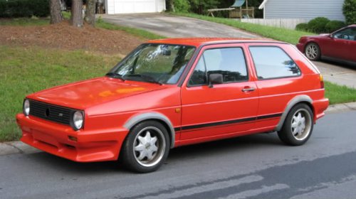

    In an ABT mk2
    Not mine. Stubbled upon this thread searching for more info. The car is in the states.
  20. A.N. Other Banned after significant club disruption Dec 5th 2
    Interesting stuff, it's probably a later conversion, as the entry in page 1 refers to the 1700 crank, which will have 46mm big ends, not the later 47.8mm. I will need to check back where I pulled that information from, but the crank detail if correct would force it to be pre-DX.
    Did you mean to write DZ or EV? The US car (Euro import) was on the forum the other week, with an EV sticker inside from recollection :thumbup:
