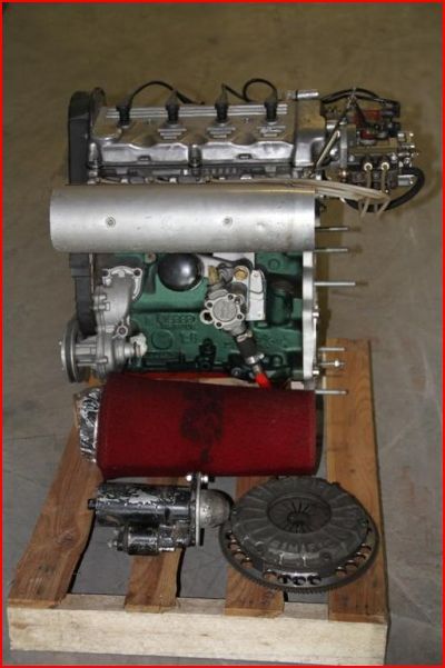

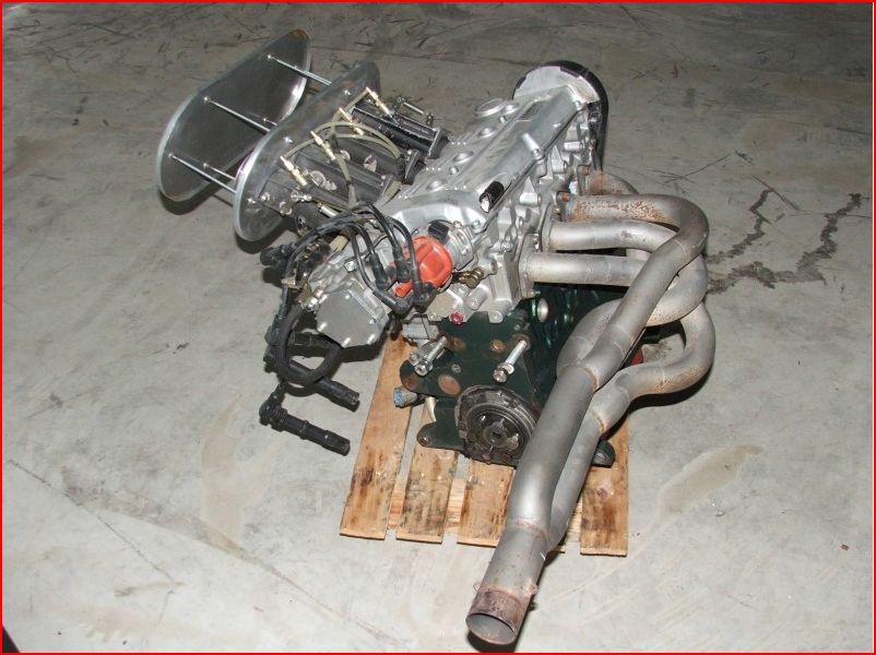

    check these out:)
    VW 1.6L 225 hp High Performance race engine with special F3 cylinder head.
    2000 CC VW engine With Drysump and Kugelfisher injection
    VW 2.0L 16V High HP racing engine with approx. 260 hp. Engine is very complete with dry sump system, Kugelfischer injection system
    Cylinderhead Formule 3 VW 16V with intake and valves and springs

    Titan/Brabham dry sump pump on the front, 8v 1.8 block :o - can we allow that on this thread? :p

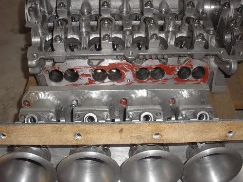

    I was just mentioning the inlet ports being bridged the other day.
    Here is a similar corresponding inlet manifold.

    Is the was flange blanked of on this one? can't see it.
    and have the inlet been reworked for better valve angle ? if so have the exhaust ports been reworked ?

    Presume you mean front water outlet off head Brooky? I am not sure. Looks like it could be.
    The inlet ports do look like they have been raised in the head though. The gap between ports and certain mounting holes is different from standard for sure. Injector recess filled too. :thumbup:

    VW 1.6L High Performance Race Engine^^
    VW 1.6L 225 hp High Performance race engine with special F3 cylinder head. Engine will be sold as/is, with no warranty, but is very complete with Kugelfischer injection system, dry sump system, flywheel, exhaust manifold. Engine is a so called marge project which means price is inclusive VAT
    € 13500,00
    VW 2.0L 16 Valve High Performance race engine
    VW 2.0L 16V High HP racing engine with approx. 260 hp. Engine is very complete with dry sump system, Kugelfischer injection system, clutch assy, startermotor. No warranty and sold as-is. Price is so called marge project and including VAT
    € 8500,00
    Notice the breather on the 1st cam cover pic, looks like its cast in, as opposed to tigged on? Hard to see it right...

    Special F3 head ??? This must be a joke.
    Its a R&D / Pre production head, nothing more or less !
